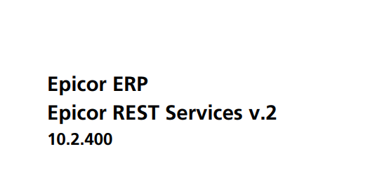

Ok, so the pdf that documents V2 that says 10.2.300 on the cover page is inaccurate meaning itâs only available with 10.2.400.?
i think so. Report it to support.

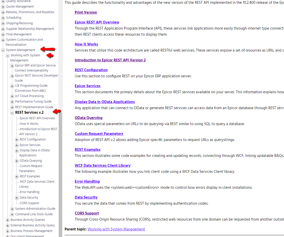

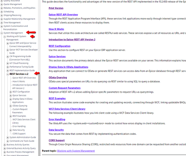

If you have access to 10.2.400 â then your Help URL should be pointing to http://help.epicor.com/102400/ in Company Maintenance.
The 10.2.400 Help Files do have the v2 Info in there. In addition to the Print Only Version. Which has its Cover Page updated.
