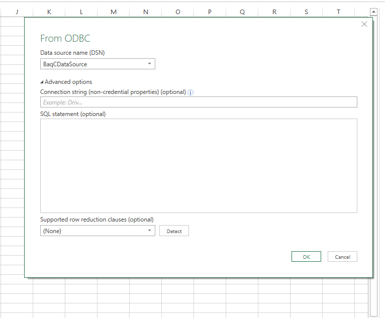

BTW All I thought I’d go ahead and give that CData Odata ODBC Driver a try with our rest services v2 - works great and I’d think it should be a reasonable solution. You just have to know how to fill out the settings to align with our apis:
Here’s an example for the COM-CustJobs baq. Fill out
- The root url for the baq or business object (don’t include /data, etc BaqSvc/BaqName/ is the root here)
- use basic authentication with user/pass
- Under custom headers add your api key X-API-KEY:YourApiKeyHere - this also works if you place the querystring in the custom url parameters like api-key=YourApiKeyHere
Then you can query the one table “Data” using sql. so here in excel i’m just letting it do select *
So - that’s i think a relatively reasonable way to hook up things that want SQL sources with the apis. nonwithstanding the odata source type in power query fighting our querystring additions.
