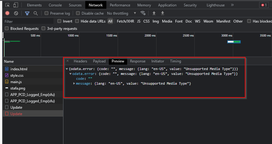

Hi,
Can anyone help me with Javascript post method? Before I am doing a web app I am testing Get and Post methods, with Get everything is ok, but Post does not work for me and I can not see where mistake is. So I am trying to Post “StartActivity”, seems everything goes well when I do this in swagger it creates new activity in epicor, but when I try the same in postman and javascript fetch I get an error:
    "odata.error": {
        "code": "",
        "message": {
            "lang": "en-US",
            "value": "Unsupported Media Type"
My script looks like this:

Can you show the postman settings for the failed call?
Finally found. :partying_face:
h.append(‘Accept’, ‘application/json’); this has to be like this h.append(‘Content-Type’, ‘application/json’);
And the postman gave the same error because in Raw I picked JavaScript instead Json

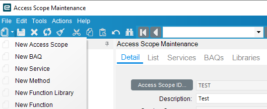

I have a stupid question. Can you have it so the API scope only allows it to access a few specific Epicor Functions you’ve made, or would it need access to everything called inside that function?
Looks like individual functions within libraries:
I assume you mean all or nothing for Library?
