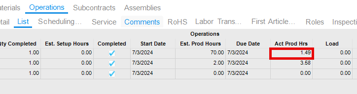

Complete noob here when it comes to Job Adjustments. I am expecting that when I make an adjustment to an operation, the hours would update on the operation to reflect my change. I’m not seeing that is the case. Am I doing something wrong or am I just wrong with my assumption?
Just going to ask a couple of general questions. Did you select the correct assembly and operation? When you did the adjustment, did you select an employee?
Yes, that list of labor transactions is from the assembly/operation that is shown in the lower screen shot. I did use an employee ID also. I noticed that if I specified a labor cost adjustment, that reflected in the total cost of the operation. But the hours did not update.

I did look at Field Help on the Act Labor Hours from Job Tracker and that field displays the total burden hours. So that’s why it’s not accumulating more hours when I make an adjustment only to labor hours. If I adjust burden also along with my labor hours, it does what we’d expect. I think that’s fair because when you are clocked into a job, you are accumulating burden hours along with labor hours… you just can accumulate more labor hours if multiple resources are in use … so that’s not crazy. We don’t do a burden cost with our jobs so that’s not crucial but if you did, you could always adjust the burden hours by X, the labor hours by Y, and the associated costs to get it to all match up properly.
