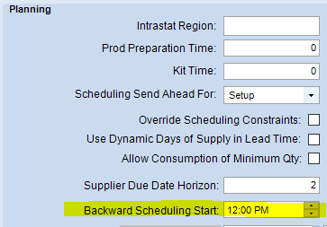

What value do you have in Site Maintenance → Detail → Planning for Backward Scheduling Start?
