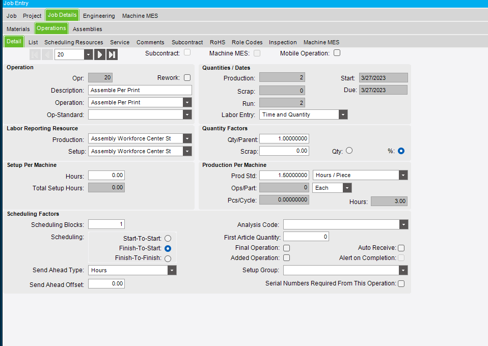

The only things that comes to mind:
  • Are your STD Format on the operation setup correctly ? (Fixed hours, hours per piece, etc)
  • Are you sure that the number of scheduling blocks is 1 on the job operation ?
Otherwise, we’ll need some screenshots of your setup (resource group, resource, job operation).
I’m not sure what STD format means, but Under production per machine, I see 1.5hrs/piece next to Prod Std:
Ops/Part is 0ea
Pcs/cycle is 0
Hours is 3.00.
