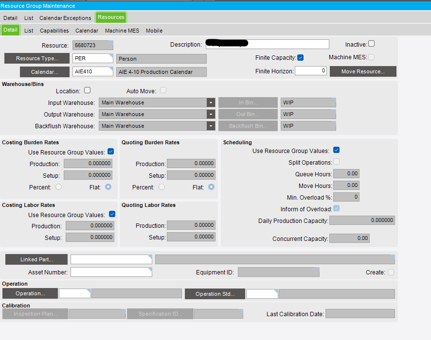

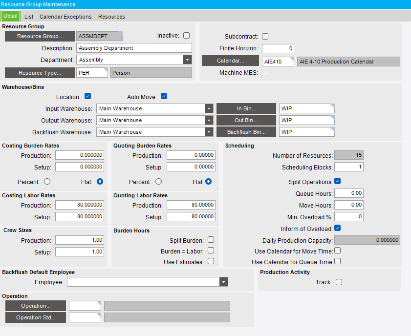

Hello again, I have some time this morning to look into this. It seems my resources are already set to finite. We have finite horizon set to zero on all resources as well as our resource group.
Horizon i’m picturing how far I want to see our schedule. I’m really adjusting our job scheduling board weekly, or out two weeks, however we have jobs scheduled a year out.
Should I use 21 days? 360? or am I misunderstanding?
These are my resource group settings.

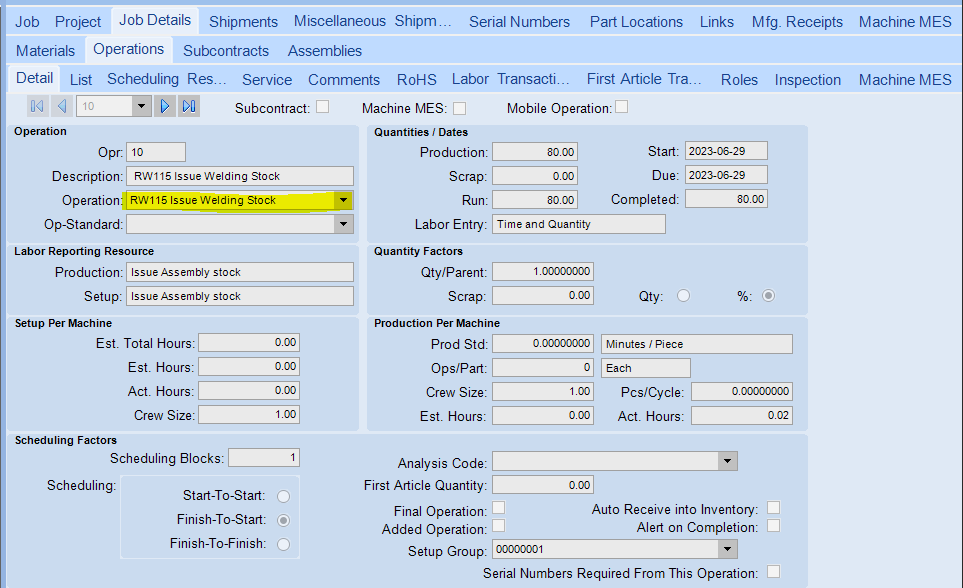

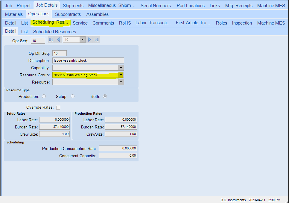

  1. the operation on the details tab is aligned properly with the Resource Group on the Scheduling resource tab.

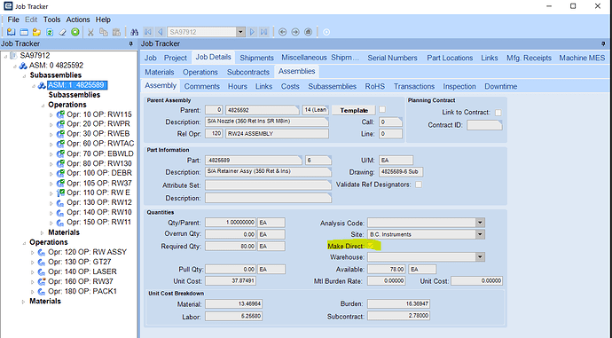

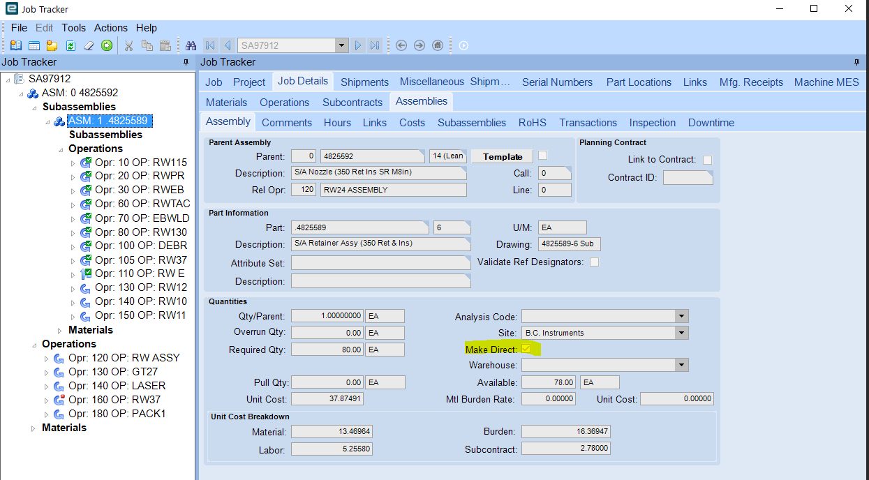

  2. on the Job Details> Assemblies>Assembly screen, all assemblies should be set to make direct.
