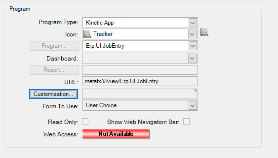

Good Afternoon All,
Muddling through Kinetic Screens and Discovered that I can create/edit a layer in Job Entry and apply that layer to Job Tracker. Odd…, are part Tracker and Job Entry the same ‘form’ with job Tracker just being read only ?? I cant seem to find a Job Tracker dll just a Job Entry dll. ( cant get snip of dropdown combobox on Menu mainy ( arg…)
Dean
I came to this same discovery, but haven’t had time to poke around more. It appears to me that in Kinetic: Part, Order, and Job trackers are all just versions of the entry form.
Not sure which other screens are like this.
This saves a lot of time having to customize two different screens
If it is that way( same form ) yes changes will be easier. In past, Part Tracker would show different sets of information ( serial numbers on tracker, not on Entry. ) . Just will have to remember to make tracker form read only…? I was able to un engineer a job using job tracker with Job entry layer… :astonished:

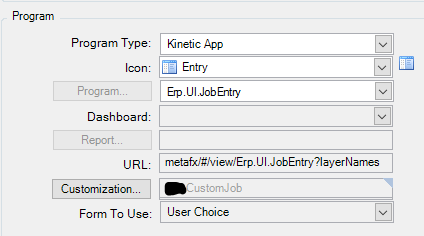

I then published and added the customization( layers) to the menu item…NOTE Order may be importand, I added the Read only layer last

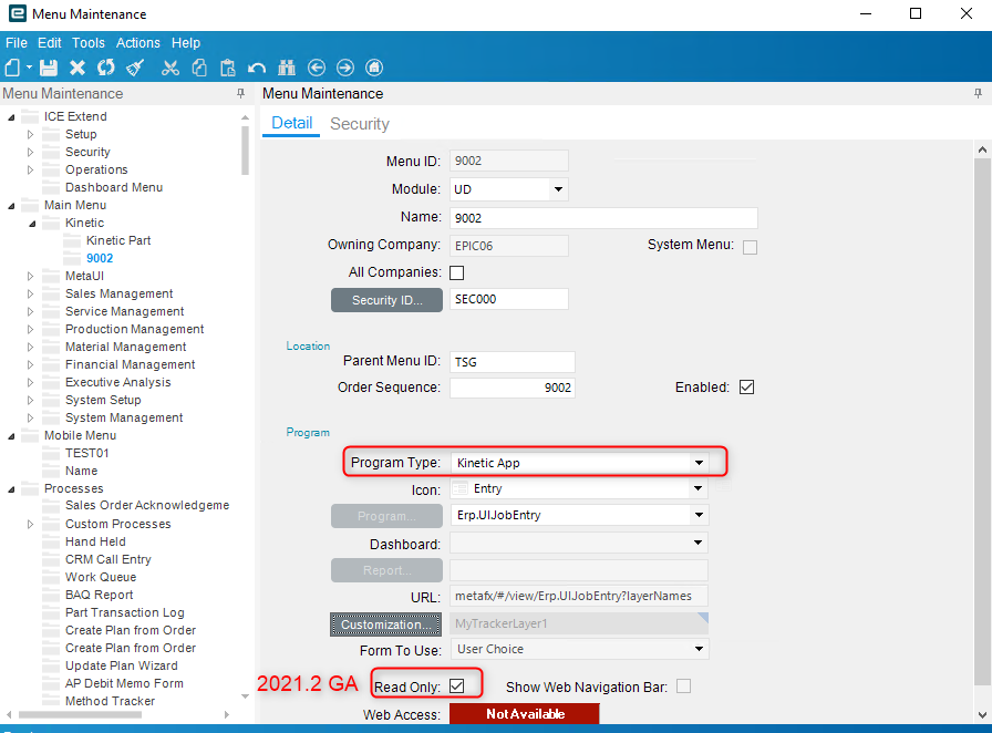

From 2021.2 GA, users should have an option to turn on the Read Only flag for Kinetic Apps…
I see that there are some workarounds also proposed here… Another one is to create an Updatable BAQ that sets the Menu_Arguments as -ro
Hope that helps !

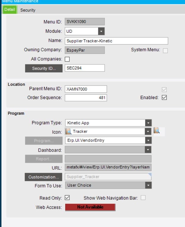

I know this is an older post but I am trying to make Supplier Tracker read only in Kinetic after we recently upgraded to 2021.2. We are on the Cloud. I have copied the Classic Supplier Tracker menu and created a new one for Kinetic. I selected Program Type = Kinetic App and checked Read Only but when I go into the new tracker it is updateable. Any suggestions on why the “read only” is not working?
Just getting back to testing Kinetic. Took a break for a while. If I remember correctly last time i was having issues, there were 3 areas where they ( Epicor ) took away the Kinetic trackers. Part, Customer and Vendor. Causes a lot of issues as you have notices. They finally gave us access to the Read only checkbox and it appears it does not work …I just added in a Vendor Entry for Supplier Tracker just as you did. Same problem, can edit address field…
Wish I could help more…
Dean
I ended up opening an Epicor Case for this and the support came back that this has been reported to their development under problem PRB0239401. Epicor development accepted the issue but there hasn’t been an indication on when it will be resolved.
