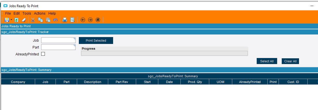

Here’s the way we did this, I can provide some code but since this particular to us I don’t really want to upload the whole thing and cause confusion.
  1. We wrote a simple BAQ that returns Jobs Ready to Print (whatever criteria you want)
  2. Then we Added a Button which for each selected Job in the Grid Invokes the Job Traveler Print.

One of the things we do here is tag the “TaskNote” with a unique identifier to make it easier to find these jobs. We then wait until those jobs are done processing, this can take some time we wrote a BAQ that just checks to see how many of the Tasks with that “Unique ID” are still “ACTIVE” and we wait a few seconds and check again.
Once all those job travelers are done processing.
We run a BAQ that returns the generated Report SysRow ID along with the job Number from the Task

We then use a BAQ that returns all attachments from a given job and we use the attachmentService to Download / Retrieve the file and write it to a Temporary Location
	foreach(DataRow drAttch in dsAttch.Tables["Results"].Rows)
								InvokeMsg(string.Format("Processing Attachment {0} of {1}",ct,dsAttch.Tables[0].Rows.Count));
								Dictionary<String,String> metaData = new Dictionary<String,String>();
								byte[] attchData = attachmentSvc.DocStarDownloadFile((int)drAttch["XFileRef_XFileRefNum"], ref metaData);
								string fn = Path.Combine(tempPath, string.Format("{0}.pdf", Guid.NewGuid()));
								File.WriteAllBytes(fn, attchData);
								fileNames.Add(fn);
Finally we send all the files to the printer in order in which they were created.
