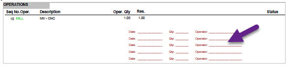

Likely a bit of a noob question, but im new to epicor. Im truing to edit data that prints out on the job traveler that seems to be sequence based and was put in by the consultants that set us up.
Its call in the report is this
=First(REPLACE(Fields!Calc_OPText.Value, chr(13), VbCrLf)) + VbCrLf
where would I go in epicor to edit the text its printing here?

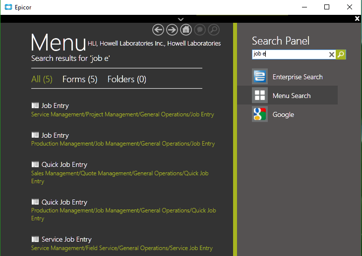

If you wanted to change the job, it would be Job Entry, which is located in
many different places one of those being; Production Management | Job
Management | General Operations | Job Entry. I normal just use the menu
search feature in E10.
In Job Entry, you can edit the op comment text or add another op.

The red text here dosent seem to show anywhere in the engineering workbench nor the job entry (assuming the photo i attached shows)
Im assuming it comes from wherever each operation is set up as a selection.

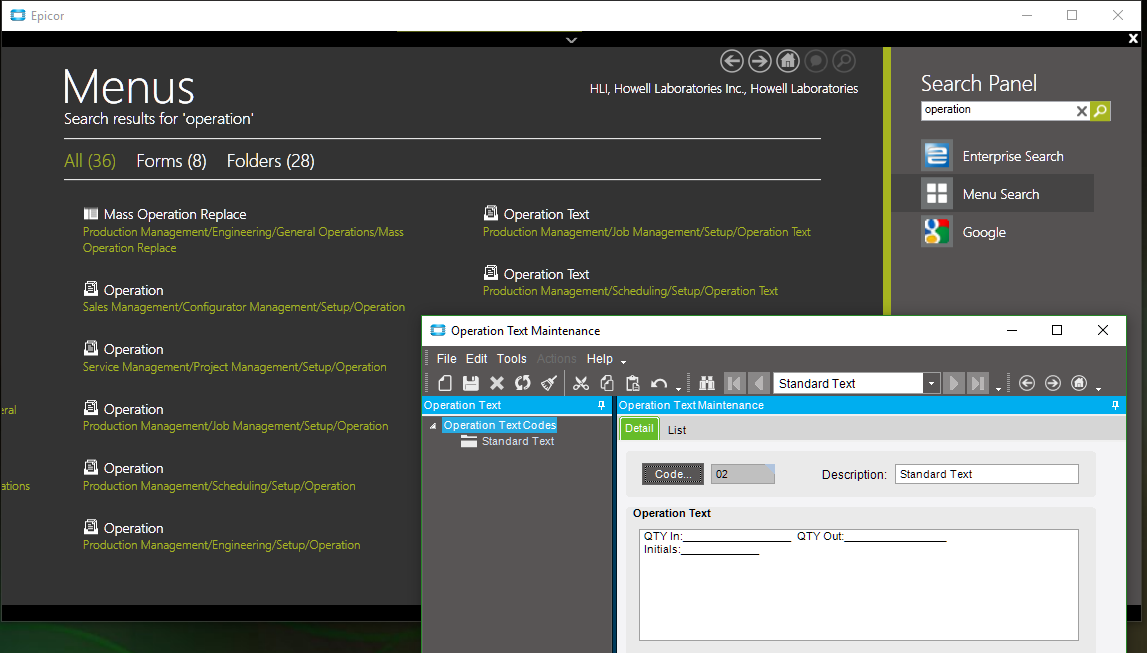

Maybe it’s the operation text?

This is typically done with operation text as Norm states. Go to the
operation setup screen, pull in all your operations and note which
operations have the “operation text” field filled in.
Brad
Perfect. Not sure why that screen didn’t come up when I searched for the word operation in the menu. but I did find it and was able to successfully edit and add new ones.
