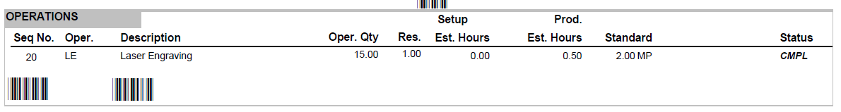

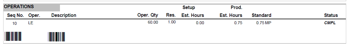

This was just brought to my attention today, we are having some jobs printing the operation descriptions, where others are leaving some of the descriptions out. Not all of them, and not even the same operation sequences, or the same order. Some are just showing the seq number, the Operation ID, and then a blank area where the description should be. I tested the base SSRS report and it’s doing the same thing so I know it’s not from a modification that I made for our custom version. See below for two different jobs, omitting a description on one, but not the other.
Gotta ask, have you confirmed the operation description exists on that job / operation? If so, the next step I’d take is generating the same traveler of one of the jobs missing descriptions, and see if it generates without descriptions again. If the result is the same every time, I’d say there’s some issue with the report itself. If not, there’s something strange going on while generating the report.
So going back to the Job’s and then the parts the Description is blank on those BOM’s… How does that happen? The OP descriptions have never been blank during use so how could a BOM been created with that description being blank? I have to assume it pulls it in from the master file when it’s added to the BOM but the fact that it can be deleted is weird to me. I also thought the report pulled the description from the master file, but apparently it does not.

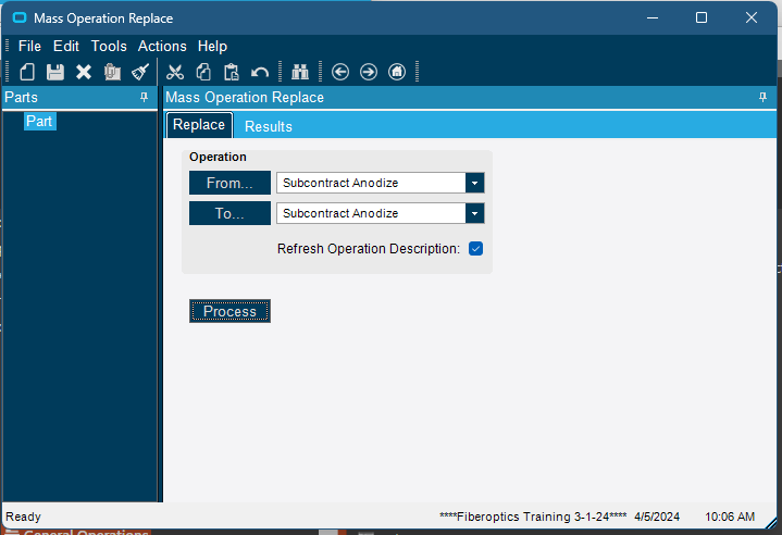

1. Identify all RevisionNum on the PartOpr table with empty OpDesc and check out the affected revisions in Eng Workbench. Look at the operations one by one and for the empty ones select a different operation from the dropdown, save and return to the original. After this you will see a Description. Approve the Revision and Check in. This should be done for all affected revisions.
2. Review if a DMT update can be done to massively populate this field for the affected revision, if you are not familiar with this tool and require further assistance, a new ticket case should be created addressed to our Technical Support Team as they are the group that handles DMT, they will be able to confirm if this approach is possible or not.
I have to imagine the amount of records that will be created from an audit trail using the DMT to fix these BOM’s would be insane… So I asked them again if they can create something to fix this without utilizing the engineering workbench method.
