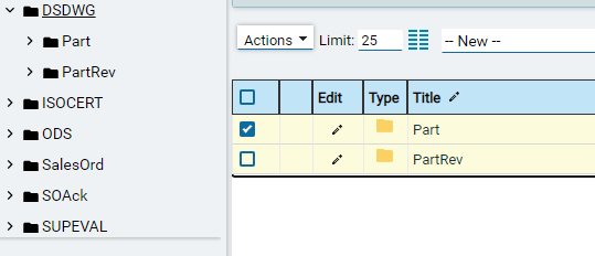

I suspect this is an easy question. I have little experience with ECM (DocStar) so far. We’ve been using ECM to print out part drawings when the job traveler is printed. This works great. When we started, engineering was attaching the drawing to the part. Recently I discovered they began instead, attaching the drawing to the part revision. In doing so, ECM created a directory called PartRev. How do I tell ECM to look in both places to find the drawing?
The global search (search field at the top) in ECM will find the document(s) in both folders automatically.
The Retrieve tab has a checkbox for searching subdirectories, so it depends on how the search is constructed.

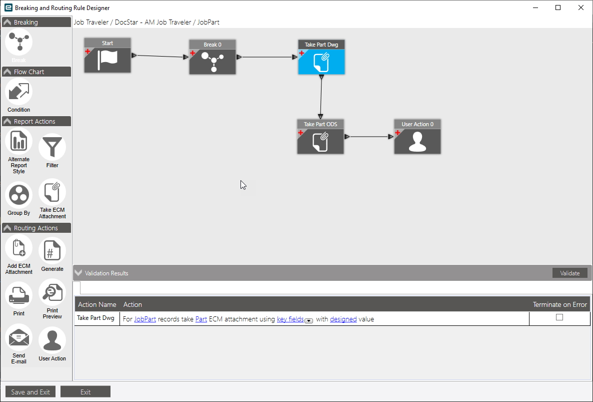

Yes, we use APR. When the traveler is printed in Epicor ERP, the APR takes over and gets the drawing from ECM as long as it’s attached to the part. MY issue is APR finding also the drawing attached to PartRev. ECM created/added the PartRev folder to store the drawing in. How can I tell APR to look in both ECM directories for drawing file?

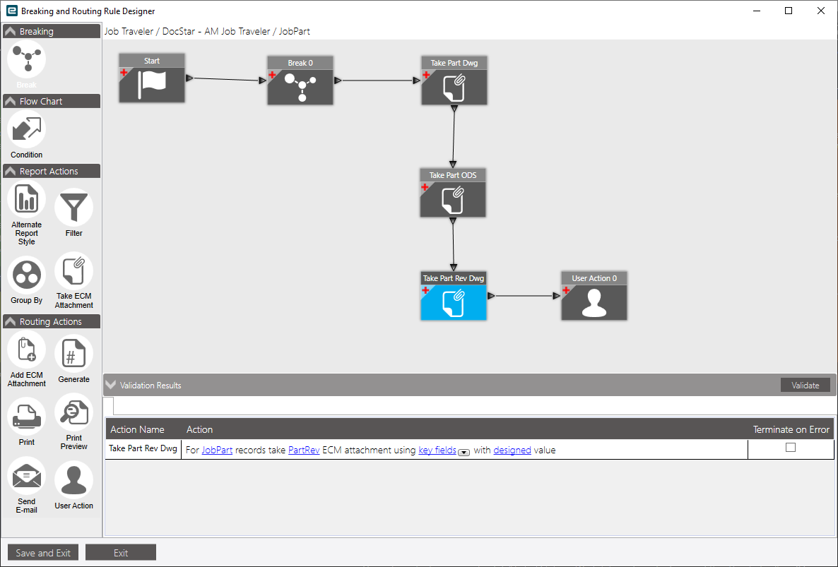

This is my current breaking and routing.
Hi @MikeGross I was able to figure it out. Some time I think you have to say things out loud to find the solution. I added another Take to the breaking and routing and linked it to revision number/PartRev. After that, it seems to work. I was able to print the job traveler with the part drawing that was attached to the part revision.
