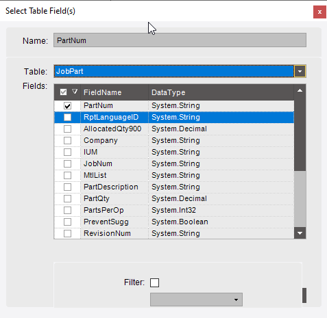

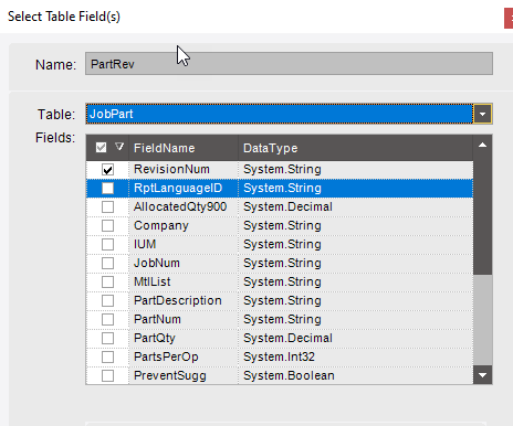

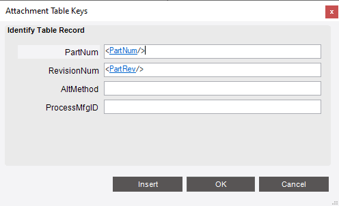

@jbryant when you brought in the partrev table where did you link your alternate method and processmfgid fields to in the job tables?
@Nicholas_Mueller If I’m understanding the question, I didn’t add anything to those fields.

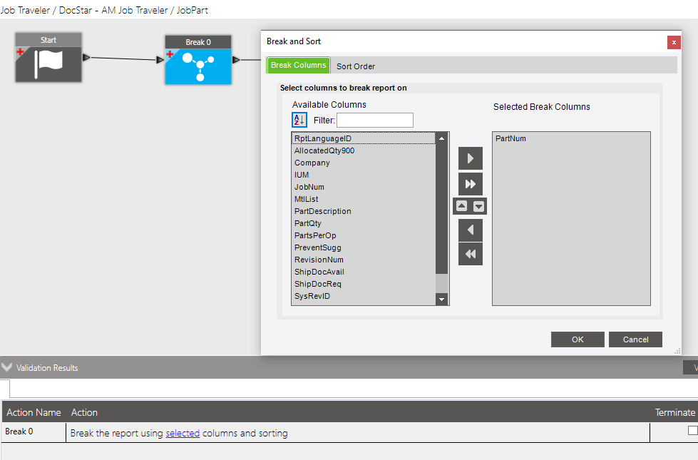

Hi Jeff,
Is there any chance you could show the detail inside your routing? The break and each take?
Thanks,
Nolan
