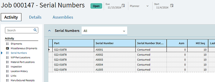

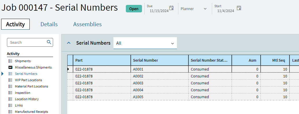

Essentially our users are inputting the Serial Numbers of Part’s into the Serial Number Assignment → Job **** → Assigned Serial Numbers.
For a job I can see the serial numbers inputted in there, for example 009023412.
Then within Job Entry → Job **** → Activity → Serial Numbers this shows that same data from the Serial Number Assignment. I need to drag that field into the report.

I have had a look through the Assemblies tab of the Job Entry but I haven’t been able to actually find a Serial Number within this area.
The only field I have been able to find this within is Activity → Serial Numbers.
David’s guide below has been able to pull the Serial Number field from here.

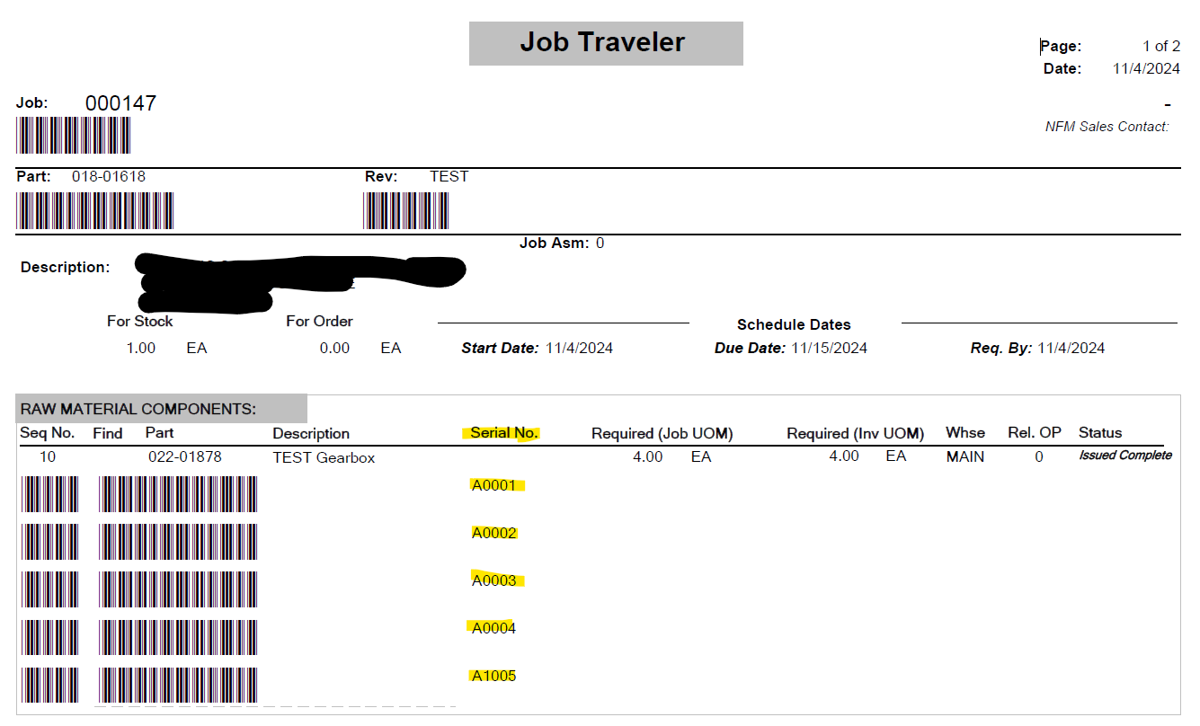

I entered a test job, added a serial tracked part and issued qty (5) of that part with different serial numbers:

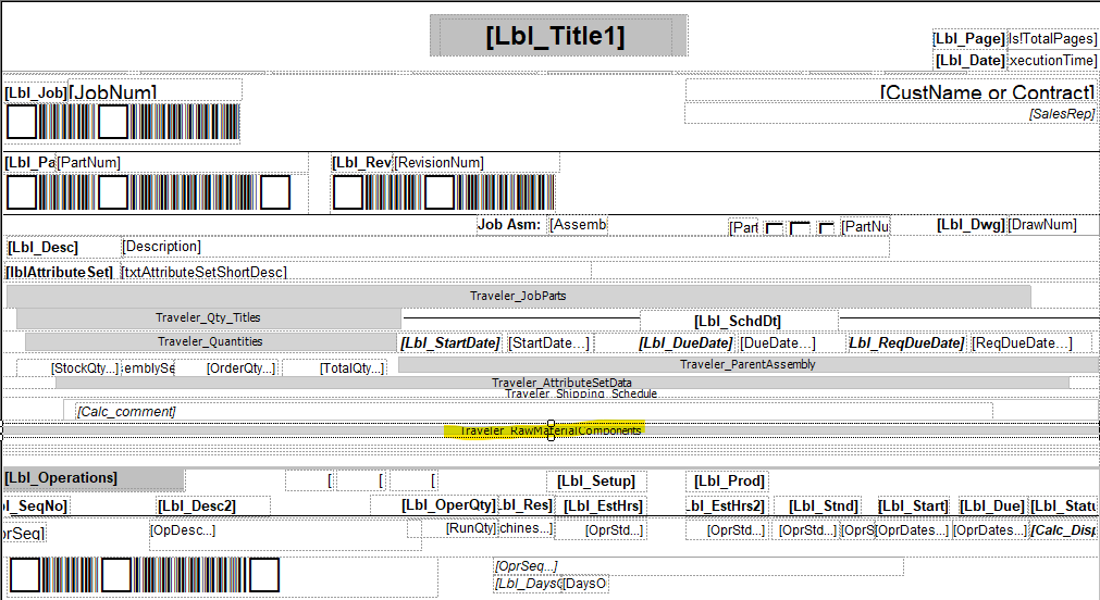

Like I said, many little subreports going on in here. I highlighted the “RawMaterialComponents” report in the image below. Again, I assume this is what you’re looking for:
When you download the JobTrav report style (RDL), it pulls down several reports and puts them in the folder.
So, in this case, you’ll want to open and edit the RawMaterialComponents.rdl
This is the report (subreport) where you would want to add your new table/relationship and field:
When you add it to the subreport form, make sure it is in the “Detail” Group (highlighted green below). Group 1 - gives you information on the the specific raw material part. The “Details” group is where the details of each transaction would go.

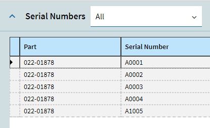

But, in cases where you issue multiple parts with Serial Numbers and want to see all of them, you’d get an output like this in the final report:
Which, again, matches up with the Serial Numbers displayed in JobEntry for this raw material:

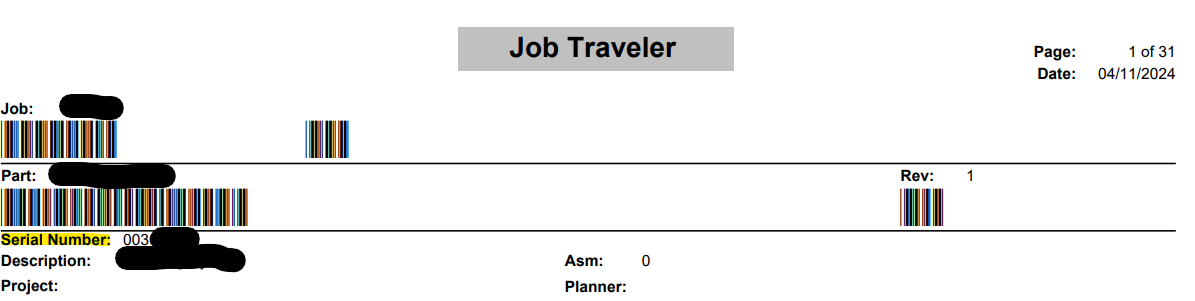

We have the below currently which is where the placement of this field is,

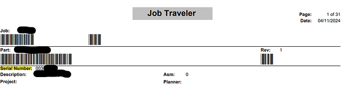

Your previous guide was very helpful as we were able to output one of the 5 serial numbers as you can see in the image. However, we are trying to accomplish outputting all 5 alongside each other. This may not be possible but I wanted to check with the community to check first.

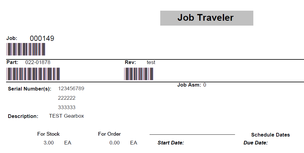

I gotcha. (See, @jkane was right, I was making bad assumptions) And since i made a mess… I’ll try to help clean it up.
So, yes, I think you can get there.

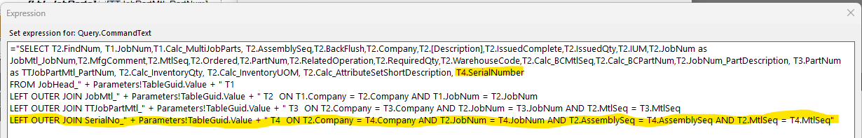

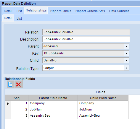

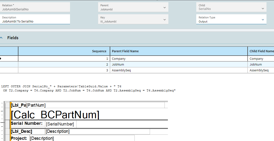

Not sure where you are at this point… but I used the below “relationship” in my RDD… joining JobAsmbl to SerialNo (instead of JobMtl to SerialNo) because we want the Serial Numbers for the assembly level parts this time around:
This was my corresponding addition to the rdl query:
LEFT OUTER JOIN SerialNo_" + Parameters!TableGuid.Value + " T8 ON T2.Company = T8.Company AND T2.JobNum = T8.JobNum AND T2.AssemblySeq = T8.AssemblySeq

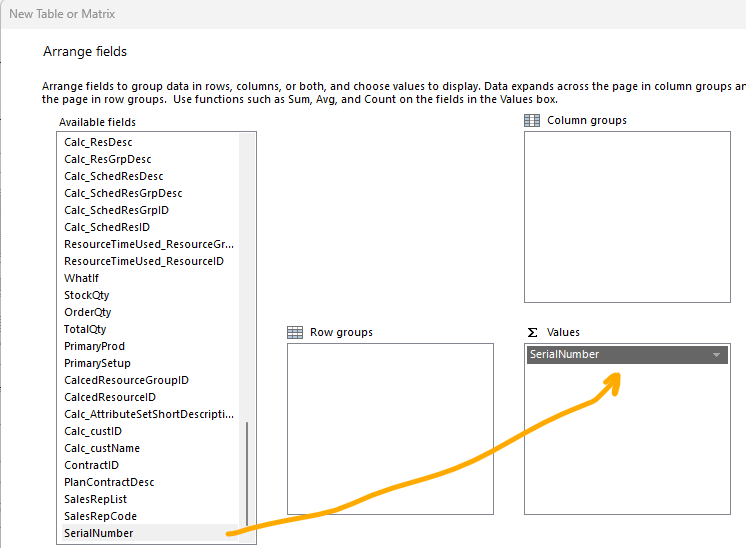

Now… as far the report only returning the first row and not multiple… I initially got the same thing. Since we’re not in a “details” group, its just going to report the “first” result.

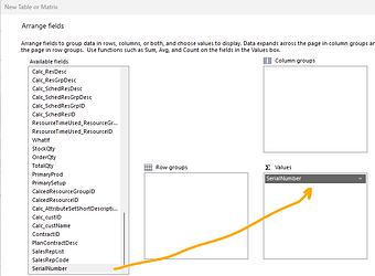

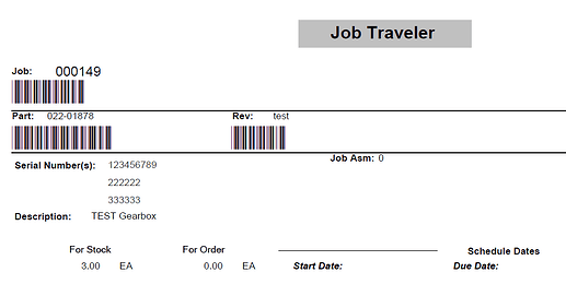

So, instead of add Serial Number as a textbox, I added a new tablix instead. Doing it this way gives it its own “details” group so it will supply all rows.
So, at the top of the screen in Report Builder, just click on the Insert tab. Insert a new Table, I used the “Wizard”.
Choose JobHead as the source query and I just pulled “SerialNumber” over to the Values box:
Next > Next > Finish
It’ll drop the matrix on your screen and you just drag it where you want it.
I deleted the header row and created my own label textbox, so I ended up with this.
And this uploaded test resulted in the below:

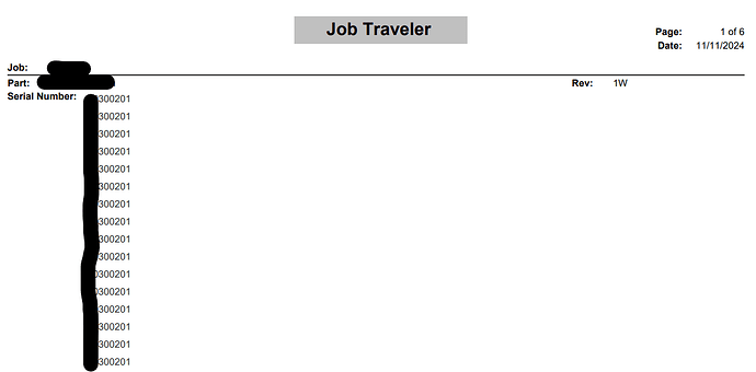

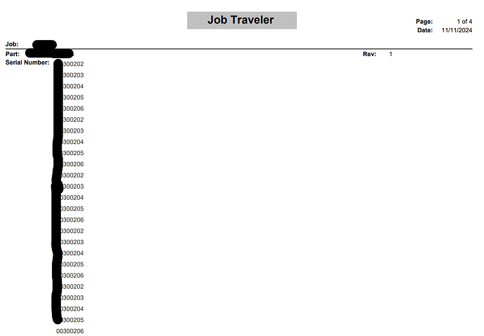

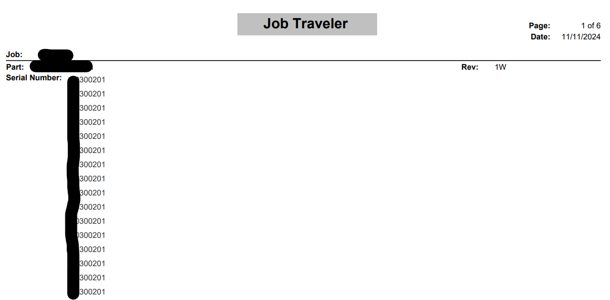

Hi David,

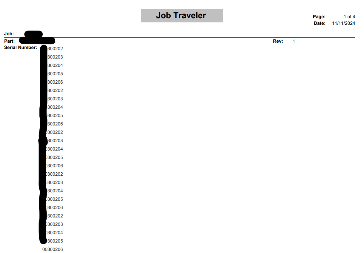

I’ve applied the above and it does output all serial numbers. However, it likes to output them several times :sweat_smile:. I’ve double checked the changes and I can’t see anything that i’ve missed/done differently.
For one of the job numbers it outputted the same serial number 16 times. This job had only 1 serial number applied to it.
For another job I tried, it outputted the same number 12 times. This job had 5 serial numbers applied to the job.

Okay so I created a BAQ on JobAsm & PartSN and no mismatches were found. Everything appeared to add up okay between the data.
As i’ve now advanced in my EpiHelp level I can now provide further screenshots! :blush:
In this screenshot below you can see the example of where the serial number was outputted 12 times (There is another page but I didn’t feel the need to provide this)
Then in this image below you can see it’s duplicated 16 times on this report, yet there is only one serial number.
