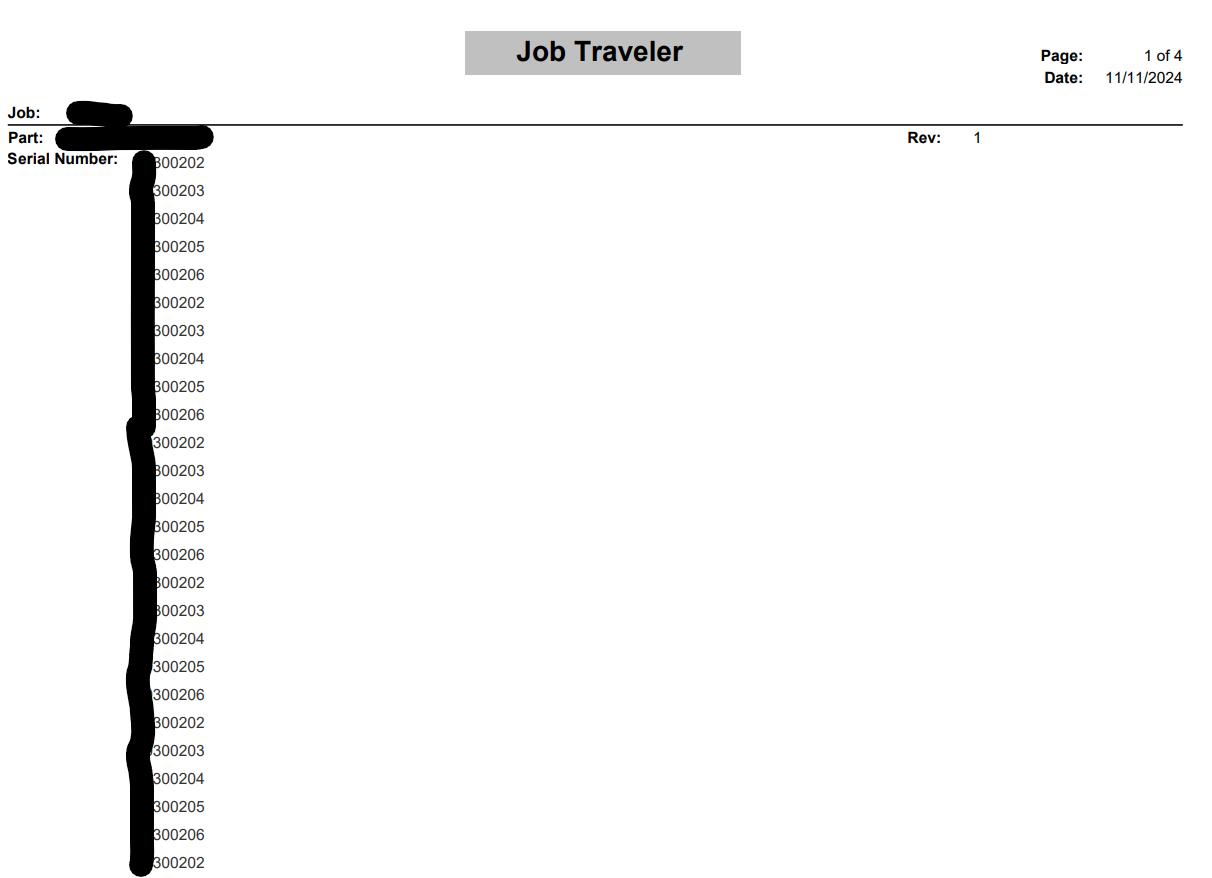

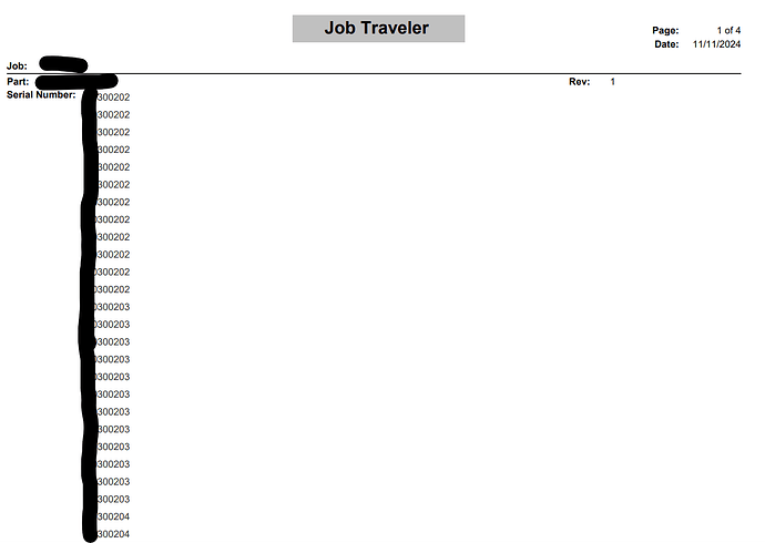

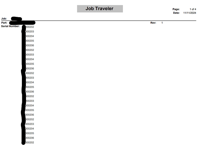

Hi David,

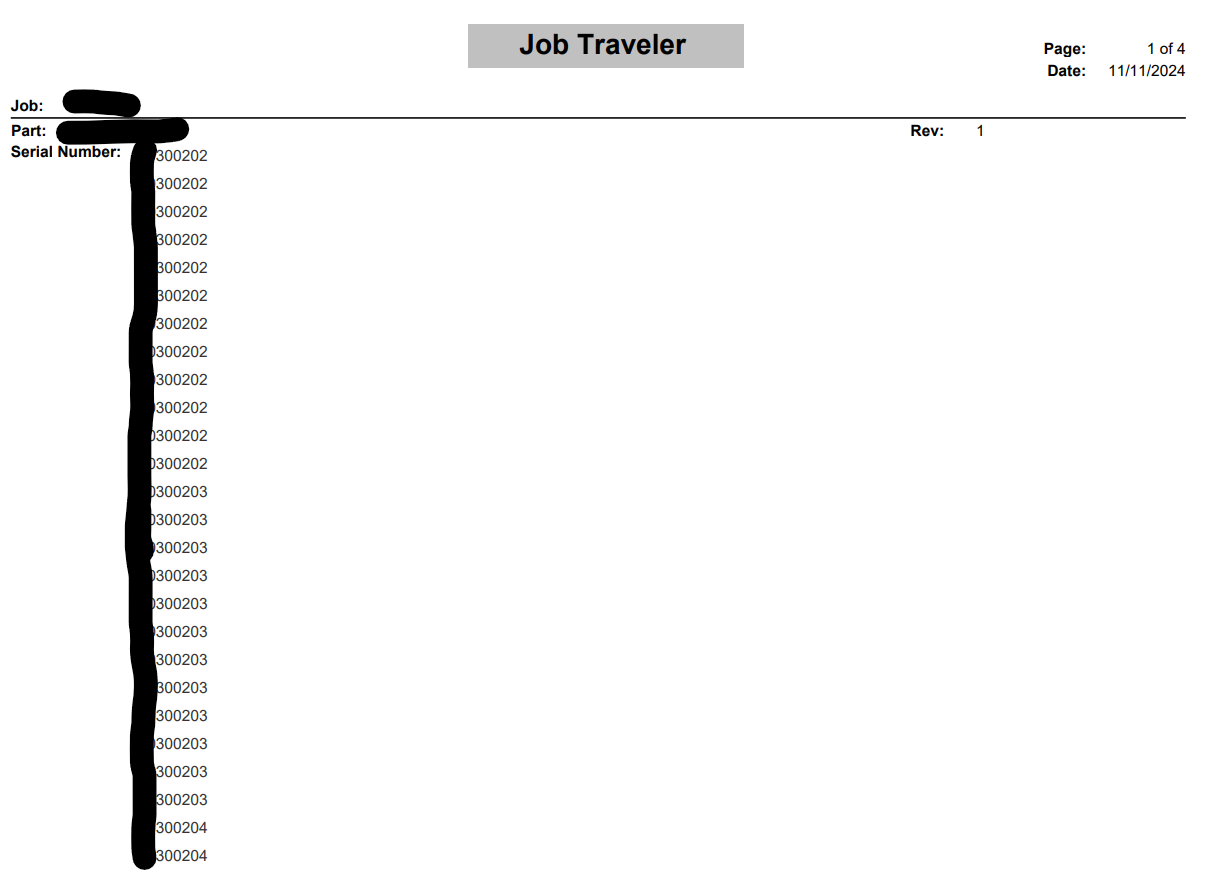

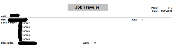

I tried INNER JOIN but it just put the numbers into order. Unfortunately, there is still 12 serial numbers outputting from the report.
INNER JOIN:
LEFT OUTER JOIN:

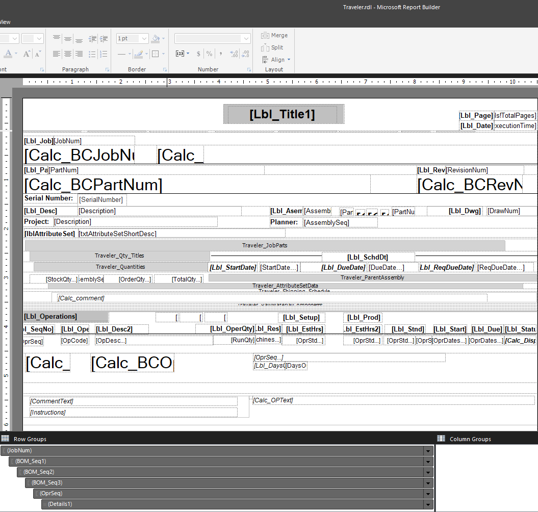

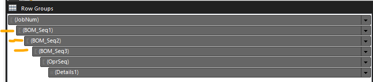

@jkane I have attached a screenshot of the report design view with the row groups below,

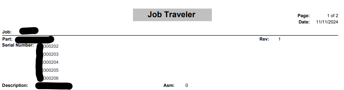

Okay, let’s try this…

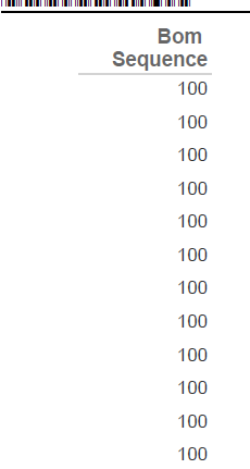

I deleted my previous test, so I created a new one real quick and just used “BOMSequence”…
I also added a subassembly to my job to test with more data. The resulting report showed this under Assy 0:
But under Assy 1, I got this:
Basically a row for every Subassembly/material where “BOMSequence” = 100.

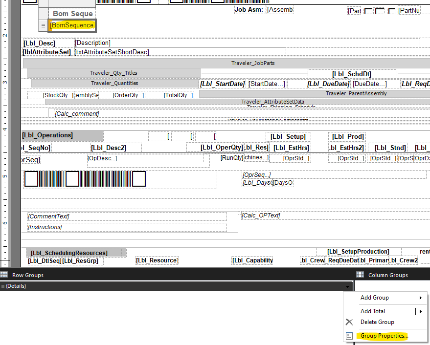

So… I went back to my rdl.

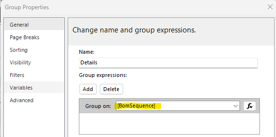

Click on the new table you added for Serial Numbers, it will have its OWN row groups… go into those Group Properties:
Add BOMSequence as a “Group On”
Save, import, test…
I now get this for Assy 1:
So… I THINK… if you look at the normal Row Groups… the (3) marked below are all “grouped on” BOMSequence.
Since we injected another table inside BOM_Seq2… it also needs to be “Grouped On” BOMSequence.
Give it a shot and see if that gets you closer.
Looks like the Serial Number field is in Row Group JobNum, is that right?
Because you are joining a table with 1 record (Asm 0) to a table with multiple records (SerialNo), it is causing the dataset to contain multiple instances of Asm 0.

It looks like we have success!
I’m going to test a couple of other jobs tomorrow to ensure it’s all good but from the current jobs I’ve tested this is now working perfectly!
