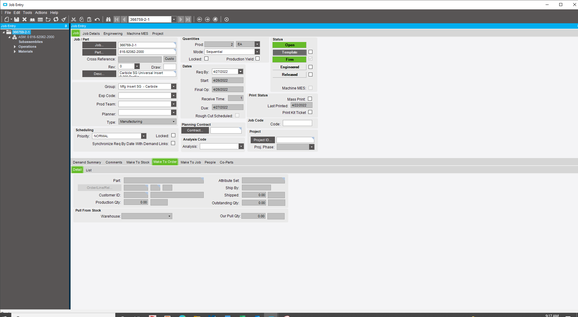

I have a job with a demand of 6 pcs, but the Production qty is 8. This is a make to order job. The order is 6 pcs.
I cannot see what is driving the production qty to be 8
Anyone have any suggestions?

Hi Nancy, check the Production Quantity in the Make to Order tab of the Job Entry main screen. This is where production quantity can be changed to differ from the Sales Order Qty.
Todd,
This is the bazar thing, there is a 0 in that Production qty field but look at the Prod. qty at the top of the screen, it has a 2 in it.
I have deleted the demand off the job so it is not connected to the sales order and this is what I have. there is no demand in any of the make to order, make to stock or make to job tabs.

Check the COPARTS tab… someone might have added something there.
Same issue here, no Demand, Coparts, Scarp, but Prod Qty still stuck at 26… and any demand you add just adds to the total. So if I make 10 to stock it becomes 36 Prod Qty. We are running Kinetic 2021.2.5
Did you figure out what has happened here? I have the same issue today.
For anyone else that runs into this…
One way to get the JobHead.ProdQty to recalc is to switch the Mode to another value, save and then switch it back and save.
(you may need to delete the demand sources in some cases first)
