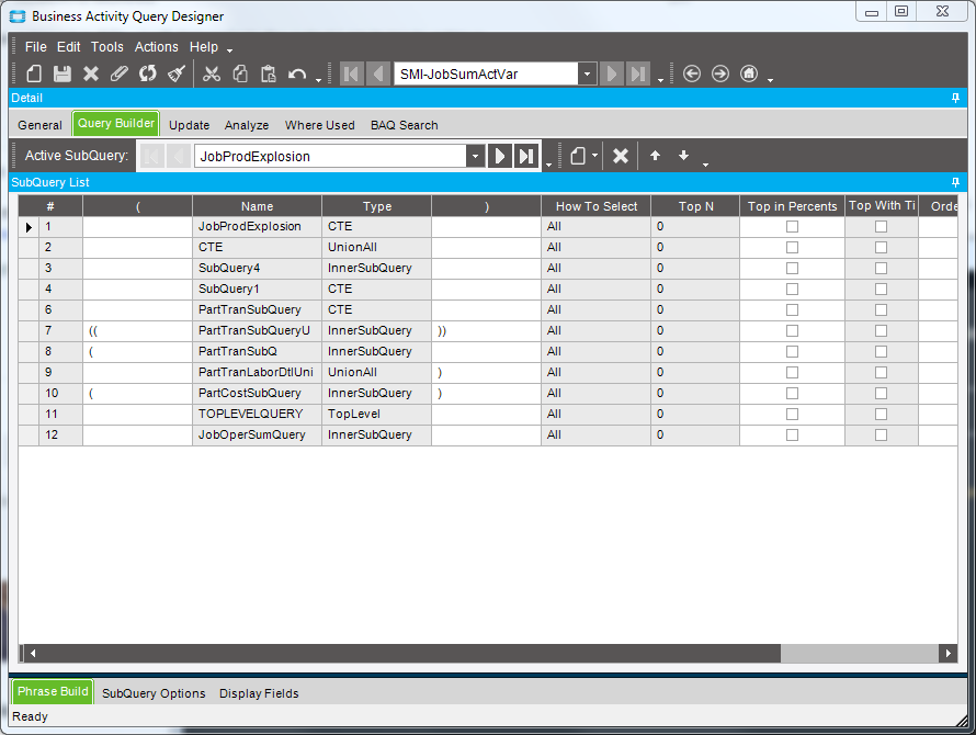

this link walks you trough making a CTE for a BOM. you could take this one, then join in job information to it to get a dashboard that looks at jobs related.

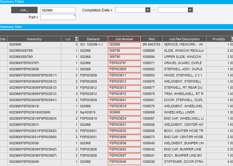

I can put in the Parent JobNum in the search and it will find it including all it’s children with some Customization Layer and using the LIKE %…% to search on the Hierarchy field.
You need to optimize your Query - It took me 12 Sub-Queries, JobProd, Recursion, Eliminate UNFIRMED Jobs and dozen other things.

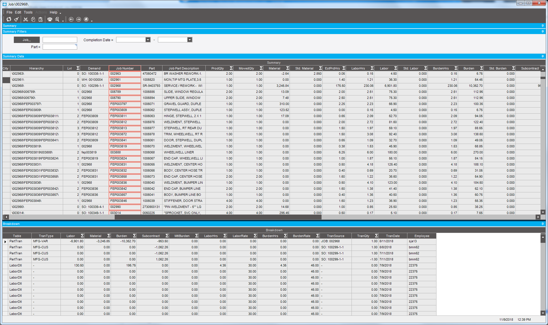

mine executes within 6 seconds and I even go as far as to the 0 level job and find the Customer who is Demanding it and associating all the child jobs with it.

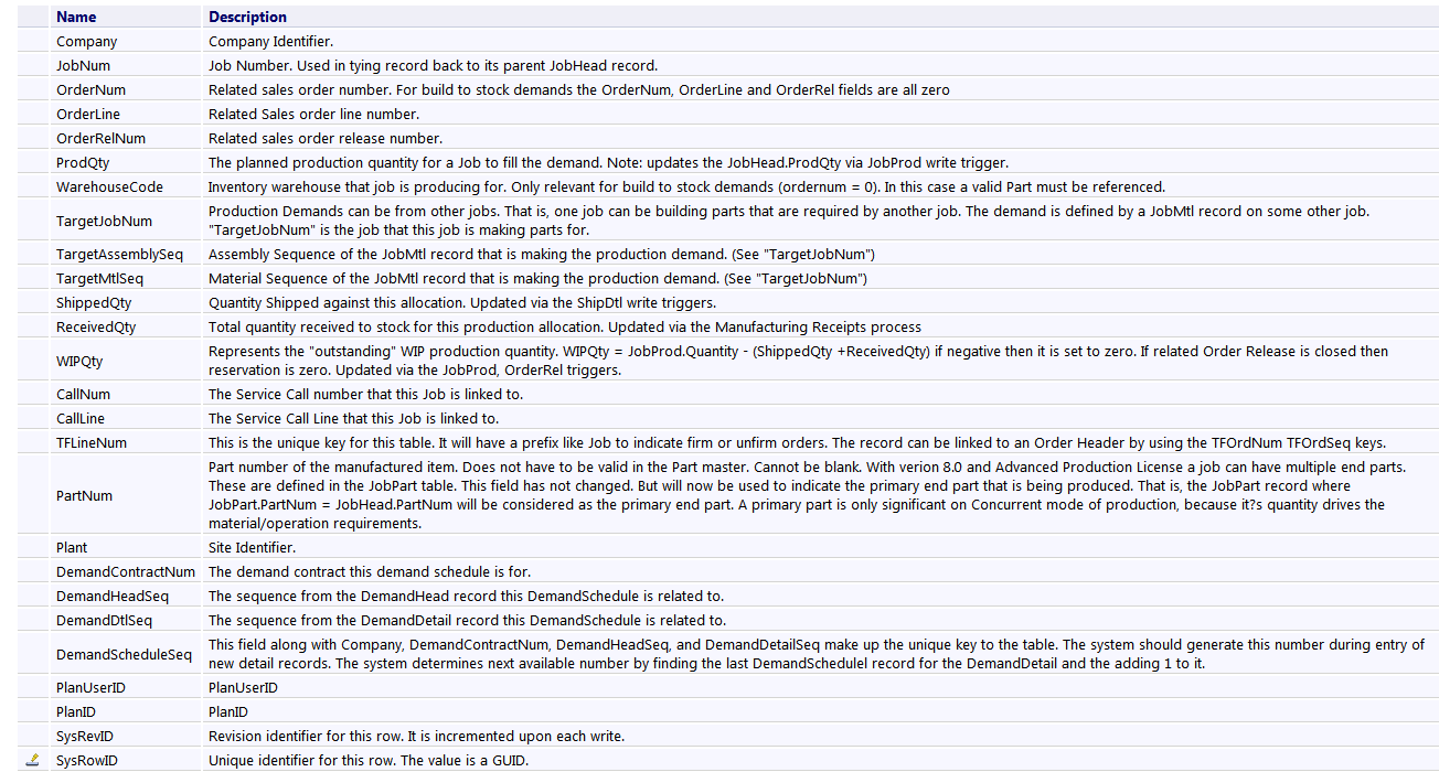

Roberto, use the article(s) above and my entry point was the JobProd table, it has the Source and the Target in seperate columns, Including the Targeted Asm, Mtl

If its to stock it will have a Warehse, if its to SO it’ll have a SO and if its to another Job then it has the TargetJobNum
It uses the Demand Tabs on the Job Entry.
