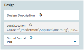

Is there a place to change the download folder (“local location”)? I guess it’s moot once you actually notice the popup… But I just have a habit of keeping the RDLs somewhere I can find them.
