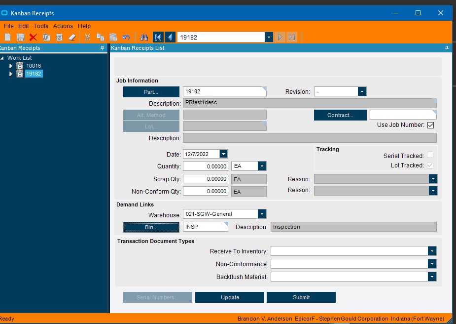

That’s an interesting persective. I haven’t given it much thought from the Purchase point of view. I am speaking more about the jobs (but I assume the same can be said for both). The problem I’m trying to solve is to make the transactions much more timely by reporting subassemblies as completed using Kanban Receipts. Today, most of them don’t get reported until the very last one is done, meaning the whole thing is ready to ship. Then they go through and report everything all at once. Sometimes we have parts sitting on a rack for weeks or months because some other subassembly is holding the whole thing up.
The kanban warehouse and bin is for sending signals for the resupply request. If you have people making the subassemblies because “They just know” (as in there is an external signal) and you just want to report that they made it, then you can use kanban jobs to report them and backflush the required labor and materials.
You can set the bin to wherever you want on Kanban Receipt. So setting the kanban warehouse/bin isn’t necessary.
Wow! I thought I had to define a Kanban replenishment method and I could only report the receipts to that location.

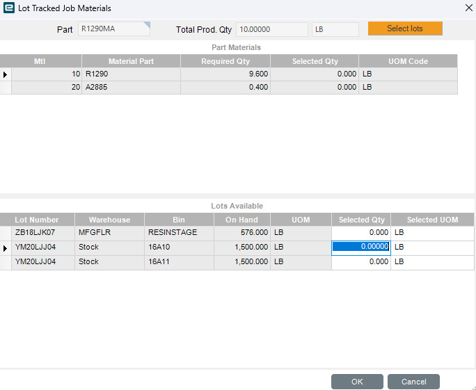

Here’s an example from PTI. We might make a plastic injection molded part in different colors. The colorant is mixed with the resin ahead of time. This combination is a new part number. MRP blows through the bill and comes up with the amount of resin we need to buy but the exact colorant amount isn’t “known” upfront because we’ll start with a fixed amount of resin and then use the proper amount of colorant to get the color for that much resin. There’s usually a bit of an overrun to account for assembly scrap too.
If using a standard job, we would firm up and release a job with both resin and colorant, and then report the labor, issue the resin first with the correct resin/lot and then issue the colorant/lot after we know how much was used, move the finished product to stock, and then have finance close the job later. We may have to alter the Job Quantity because what was produced didn’t match exactly what MRP suggested the order for.
Or do it one step with a Kanban job. :person_shrugging:
With a Kanban job, you have to backflush the materials. So if you need to issue a different amount you can’t, it only works when you do it the same way every time.
I had to go back and check. You are absolutely correct. I assumed the quantities could be changed in the Lot screen.
But it does enforce that the Required Amount match the Selected Qty.

I think to summarize, the Kanban bin seems to be more useful if you have more than 1 location in a warehouse that will be kanbanned and need to keep them each managed. The Kanban warehouse is a simpler means if you only have 1 location or only care about the entire warehouse quantity as a whole. I built a BAQ report that spits out a nice KB Card and I set it up to work for both… As I am testing things on our new line, I wanted to confirm which direction I should take. I chose to do the Kanban Bin because it appears to be no harder to create/manage but gives me the flexibility to add a second location in the future without needing to undo things. We Kanban in our aftermarket site by warehouse because they only have 1 location for each thing and should only ever have 1 location for each thing.
