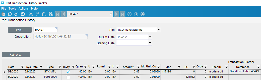

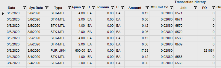

It does. That’s what this pic is showing:
Epicor didn’t establish a UKN-MTL transaction; it’s just STK-MTL and you have to just know that it’s non-QB.
And those STK-MTL parttrans have the InventoryTrans field cleared?

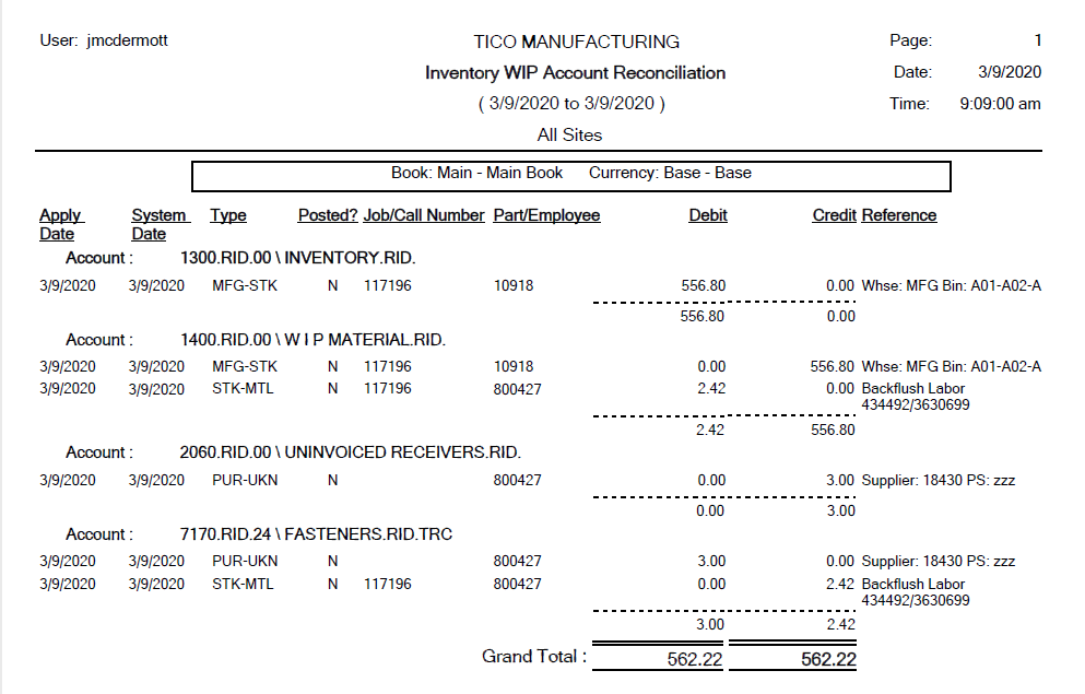

and if you run WIP Recon report for a job that uses non-Qty Bearing parts, what GL account is credited when the WIP gets debited?

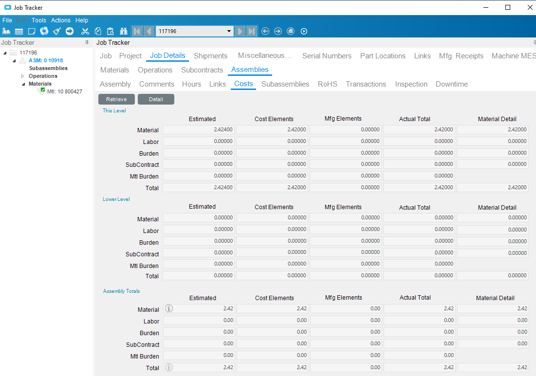

Part 800427, non-QB, has standard cost (of like $0.03).
Job Tracker:
Inv-WIP:
Part Tran History:
I’m not believing the Invty flag, though. Or it’s vague and meaningless…?
Edit:
I should have skipped the MFG-STK, as it confuses what you are looking at. That’s a normal, qty-bearing part.
But point is, 800427 has an “expense” part class that goes to the fasteners expense account. So it gets hit on the receipt and the issue (backflush).
Great test! Just a few more questions (because the devil is in the detail) :wink:
  1. Was the Expense Acct for P/N 800427 set on the Part, or Part Class (or something else)?
  2. Does it matter the method for how the material was “issued” (back flushing, Mtl Issue, Mass Issue)?
And don’t feel necessary to run the tests. Those are questions that hopefully someone knows off the top of their head.
