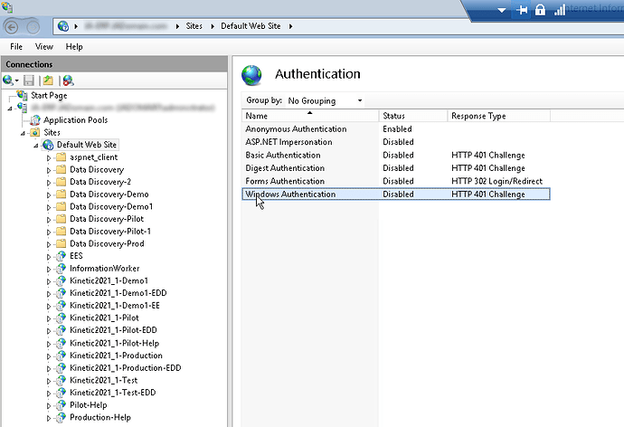

This is connection to TestEDD/DataDiscovery server. I am not very familar with its setup but I think it is not configured correctly. Probably you can swithc it off somehow? After that HP should work fine.
Alternatively, look into EDD setup, but I cannot help with it.
Actually, go and try to switch off Windows authentication in the EDD application in IIS.
If I turn it off for the default web site it works, but not through productions EDD or production itself. Isnāt this incredibly insecure since the entire site has authentication disabled?
Well, it is not unauthenticated, it will just not try to use Windows auth, just tokens.

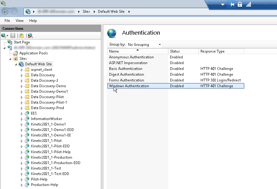

I have been recommended a few things by Epicor, non of which worked. Using what Olga and Hasokeric had recommended seems to have made it work, though I question security on it. In IIS, select the Default Web site.
On the site, select āWindows Authenticationā and select Disable. Then give it a try.
Thanksā¦Iāll try itā¦but I agree that it doesnāt quite seem like the most secure solutionā¦

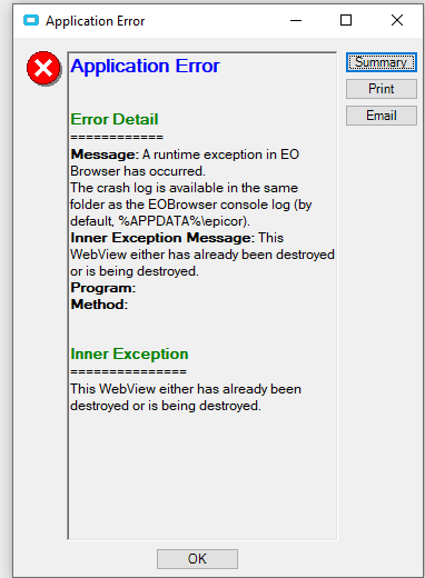

Good luck! Iāve still got to have a call with them on the Application Error Iām getting⦠their suggestion of removing all the Epicor files and reinstalling worked for about 1/2 day. Just havenāt had the time to do a webex yet.
what error is it?
I had that issue, when I updated to 10.2.700.10 it fixed it
