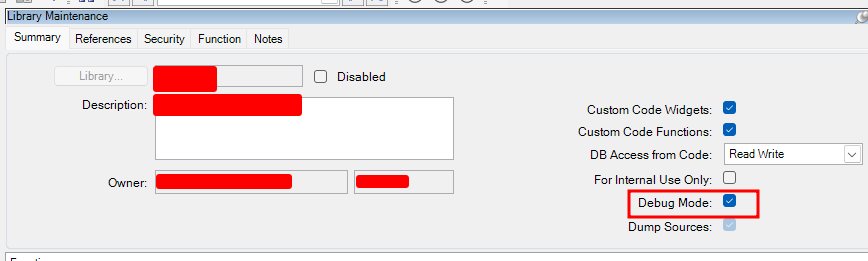

The InfoMessage box now has debug only checkbox I wonder if its defaulted On
The message widget does have that flag but have you tried setting that flag in c# code instead of the widget?
I thought that maybe this flag would do something but It doesn’t.

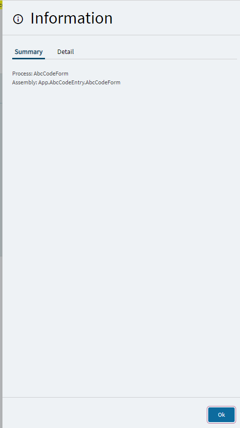

Worked fine for me 2023.1
            var messageTextBuilder = new System.Text.StringBuilder();
            messageTextBuilder.Append("Process: ");
            messageTextBuilder.Append(this.callContextClient.ProcessId);
            messageTextBuilder.Append("\r\nAssembly: ");
            messageTextBuilder.Append(this.callContextClient.AssemblyName);
            var messageText = messageTextBuilder.ToString();
            this.PublishInfoMessage(messageText, Ice.Common.BusinessObjectMessageType.Information, Ice.Bpm.InfoMessageDisplayMode.Individual, "ABCCode", "Update");

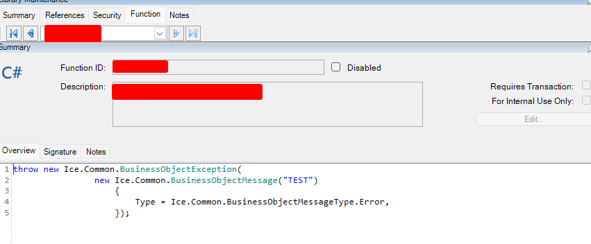

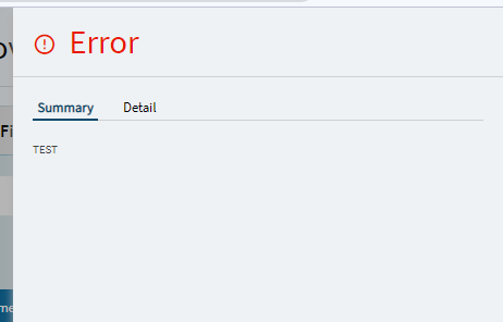

I know the function is fired because I can thwo an exception from it.
throw new Ice.Common.BusinessObjectException(
                new Ice.Common.BusinessObjectMessage("TEST")
                        Type = Ice.Common.BusinessObjectMessageType.Error,

Look at this picture from this post:
I’m not sure that Info message was ever supposed to work in a function… Functions are mostly to be invoked via REST I’m not sure how that would translate to a Kinetic Layer… It seems you said it worked before :thinking: but from a design perspective it doens’t make sense to me.
