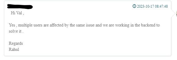

We are having the exact same issue and getting the same exact response from Epicor. They re-start the task agent and it works until I submit a process like Process MRP or Import EDI.

I’ve had ongoing case since Monday - they restart it - users test a few things and it’s back to the way it was. This is the response I got this morning.
