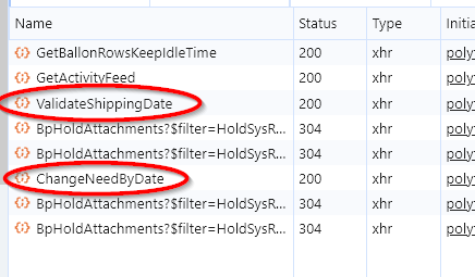

Is there a way to turn this feature off in 2024.1?
there is nothing built in, but it could probably be done with a simple BPM…
After you change the need by date, there are two processes called. The first one is the Validate Shipping date. I would first try to associate a BPM to interrupt what is happening there.

Thanks for letting me know so quickly. I’ll see if we intercept this event.

For anyone interested, to disable this feature to auto calculate the RequestDate (Ship By), I found a post about an override hook, so I created an override event to cancel the original event ChangeRequestDate.
This is nice and easy for Kinetic (web), but we have users still on classic, any thoughts on how to handle there?
I think maybe, catch when NeedByDate changes (pre-processing), save the value for RequestDate, then in NeedByDate post-processing restore the request date.
