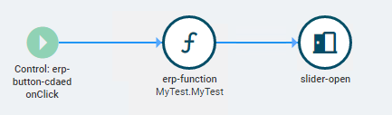

Function returns a null dataset. Added string parameter for reference.

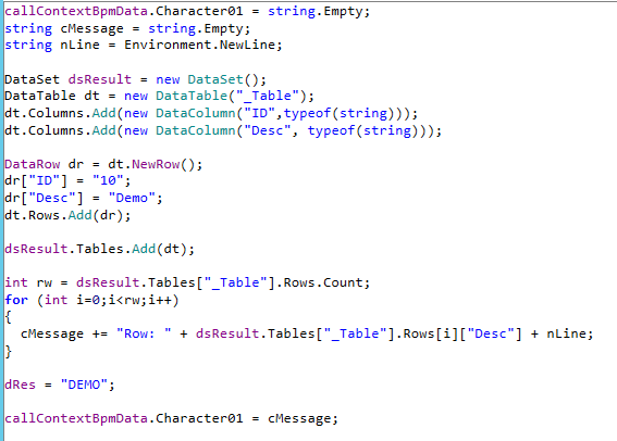

In the function I create a dataset plus a simple check to see if the data does exist inside the function.
Function messagebox displays callContextBpmData.Character01 to verify data inside the function. It displays results as expected.

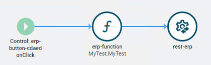

Used both function and your rest-erp example from another post.

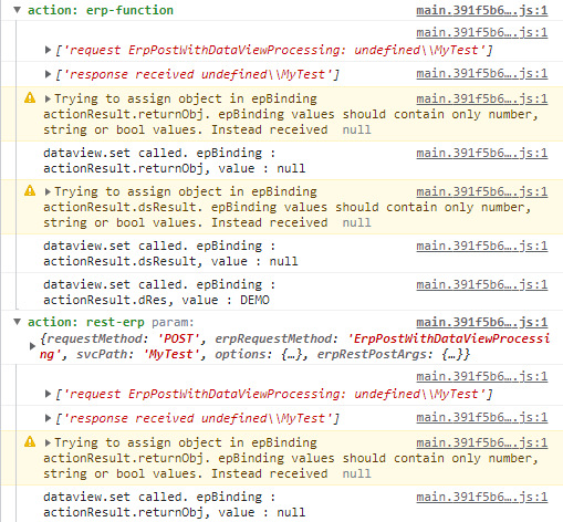

erp-function returns the string value, but null for the dataset.
rest-erp only returns null for returnObj.

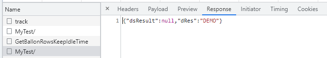

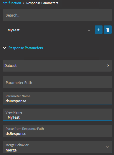

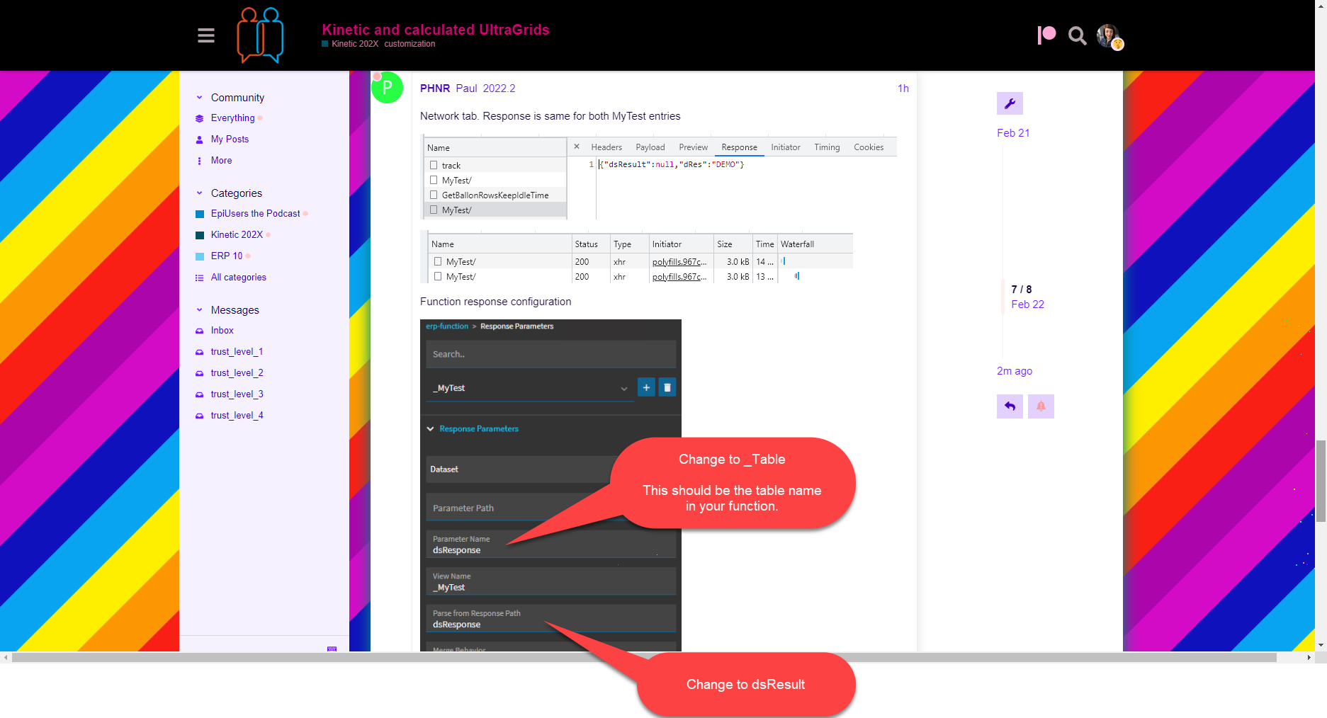

Those are red herring messages. Show me the network tab call for your function and how you configured the response for the function widget.
Network tab. Response is same for both MyTest entries
Function response configuration
Take out
DataSet dsResult = new DataSet();
replace with
Also:

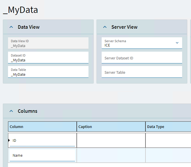

I’m also assuming the dataview you created and are trying to populate in App Studio is named _MyTest, correct?
Thanks, dataset now works.
Thanks, DataView also works.
