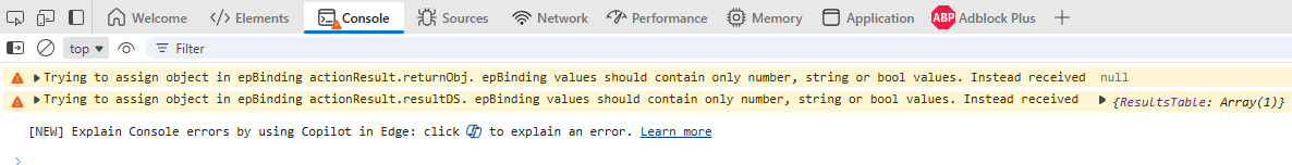

What do you see in f12 debug tools console tab?
No refresh event is needed. Grid epBinding to DataView is all.
Is grid columns collection empty? It must either have no defined columns at all, or the columns you want to see defined.
Turn on debugging (ctrl-alt-8, or in console type:
epDebug.setDebugModeStatus(true)
Then trigger the function call again

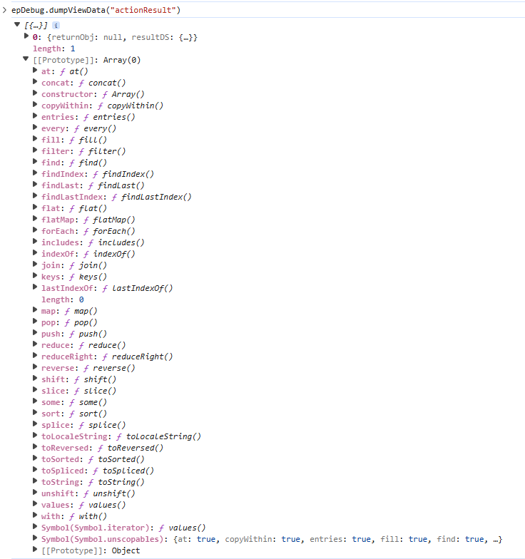

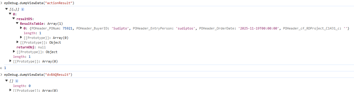

epDebug.dumpViewData("actionResult")
epDebug.dumpViewData("dvBAQResult")
What do you see?
How can I run that?
In the console window, at bottom, you can freehand type:
Here is mine for example, I am returning an EfxLibraryTableset, so it has many tables:
Rather than expanding prototype: array (collapse that), expand the array with rows (0):

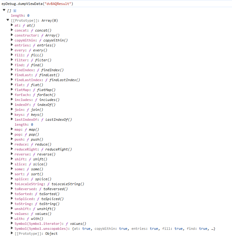

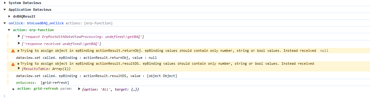

dvBAQResult isn’t getting rows, and i think i see why…
If the above set up does not result in rows in dvBAQResult (check with epDebug.dumpviewdata) - delete the function widget and rebuild it.
Oh my god!!! It worked!!!
