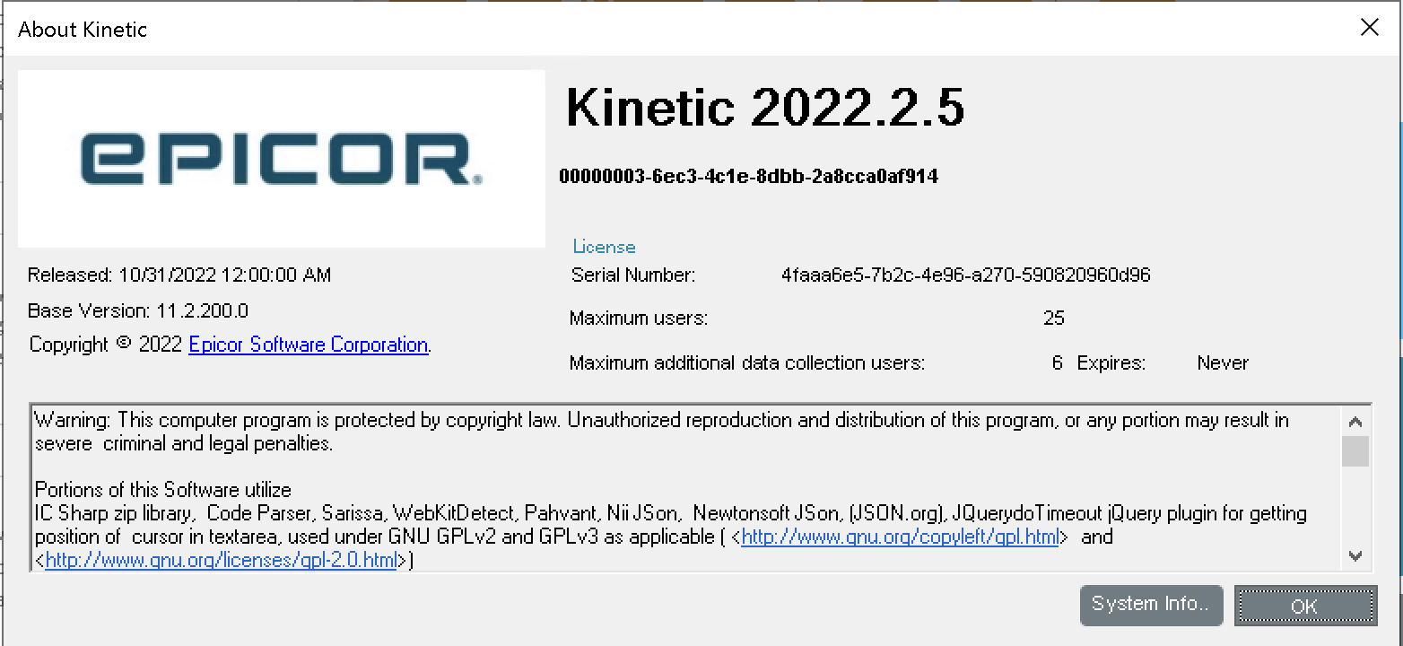

Kinetic Application Maintenance Missing After Updating to 2022.2.5
Just updated epicor and now Kinetic Application Maintenance doesn’t show in my menu.
I had app link on my desktop of it and when I click it I get a “Access not allowed” error.
I’m trying to change some of my screens back to classic to avoid the kinetic bugs. Anyone else missing “Kinetic Application Maintenance” after updating to the latest version of Epicor?

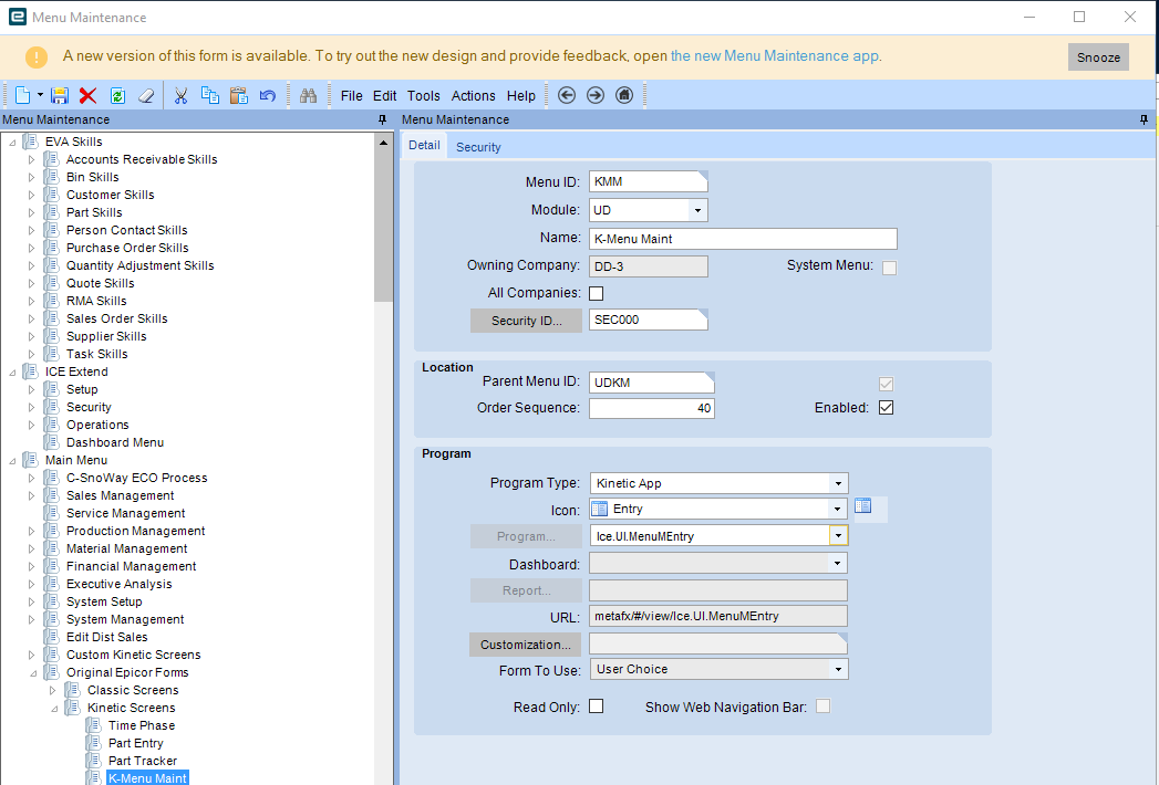

I don’t have a 2022.2 test environment up yet (today I hope!), but could you go into Menu Maintenance, and change the application type there? I’m curious to see once we get our test environment up…
Its now in Menu Maintenance ( Kinetic Version ) You can control what Customization of each ( Classic or Kinetic ) opens

Clicking that box adds -KineticUI to the argument for the menu item. I’m guessing you could do a DMT update? I haven’t looked into this, so I’m not 100% it would work.

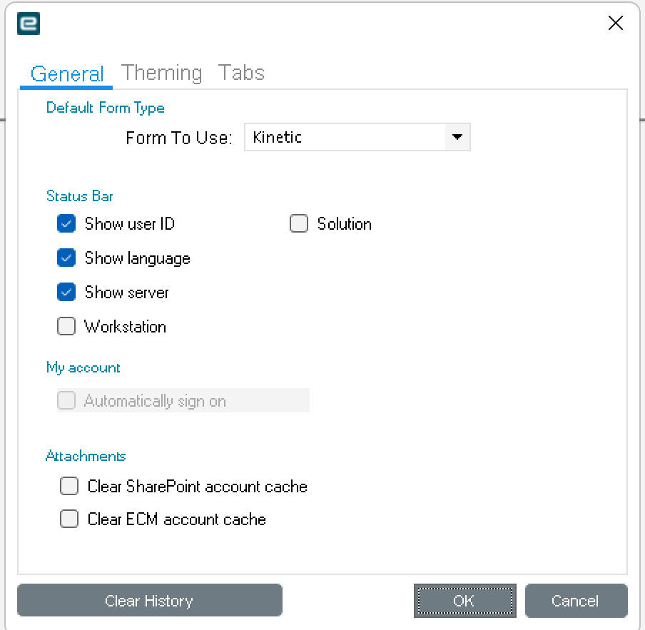

If only I could open the Menu Maintenance (Kinetic Version). Epicor has a mind of it’s own and opens the classic version, no matter what my personal preferences are. In previous versions, I used Kinetic Application Maintenance to force Menu Maintenance to open in the Kinetic Version. Now I’m stuck, unless that silly banner at the top shows up randomly asking if I want to open the kinetic version.
I guess I got it to open in kinetic by changing the menu items “Form to Use” to Kinetic, using the classic Menu Maintenance. Maybe they fixed it in the new releases. In the past I found that field to be hit or miss in the Menu Maintenance. Hopefully it’s more reliable from now on.

Option B, Create a new menu item in Classic Menu Maint ( Location up to you) , Kinetic App, Ice.UI.MenuMEntry
Close, reopen Epicor and Navigate to where you put the Menu item.

But what you can do is open the UX platform Menu Maintenance form, click on Main Menu (the root menu) Then in the overflow menu for it select Kinetic Options. if you check the first box - all menu items in main menu will default “Form to Choose” to kinetic. If you set them both it will default “Form to Choose” to ‘user choice’. If you leave them blank it will default ‘Form To Choose’ to Classic.
Remember after using this to refresh your menu (overflow menu for entire app) to ensure you see the changes take affect.
But also remember if as an admin you force it to Kinetic or Classic at the menu item level you are DISABLING the ability of a user to decide what they want to see. When set at the menu it is considered an administrative override.
