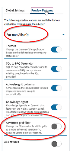

Go to preview features and turn on advanced grid filters.
Where is that located?
Preview features
You have to turn it on for the whole company and for yourself.
I turned it on and now where the old filter button was, it says this.
How do I use this feature?

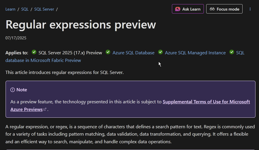

It doesn’t help you now, but SQL server will have regex in the future, which will probably be able to do what you want.

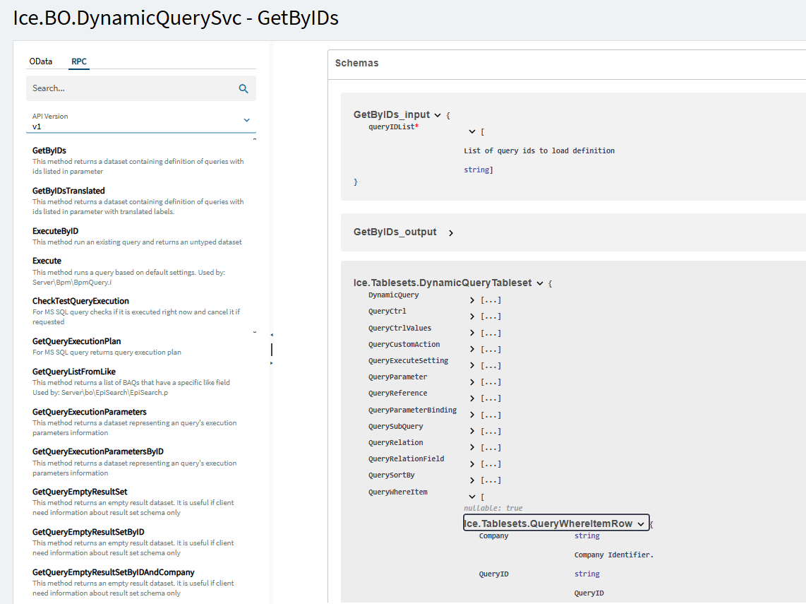

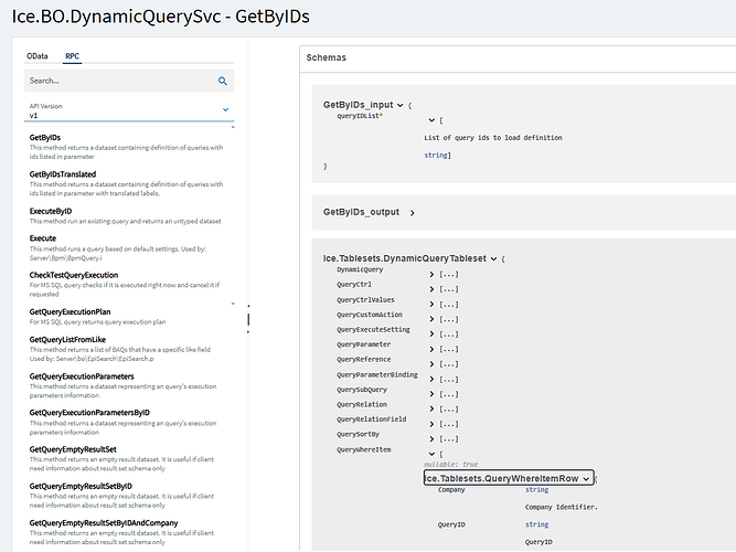

My first thought (and @aosemwengie1’s) is to call a function that uses the DynamicQuerySvc.
Here you would get the generic search that does the UNION between the two tables and then add your QueryWhereItem rows for the number of words you are looking for. Execute the query. Profit. (as Jose likes to say).
Ice.Tablesets.QueryWhereItemRow{

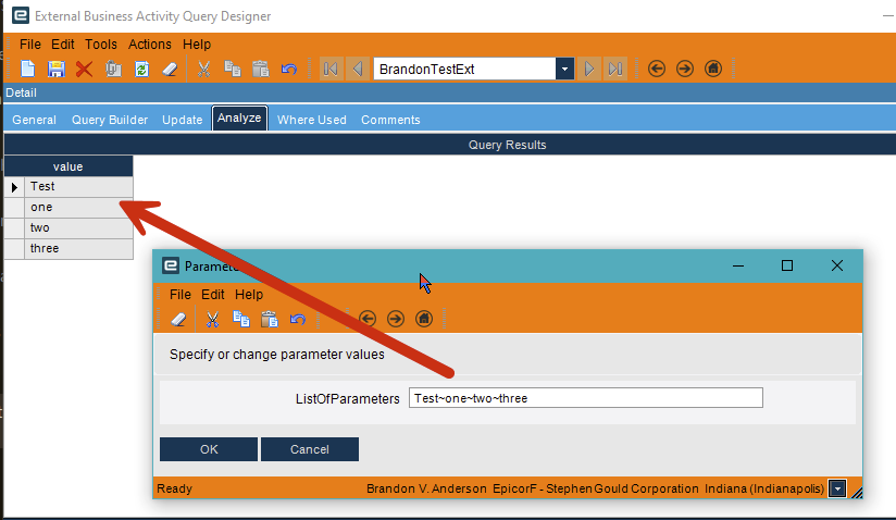

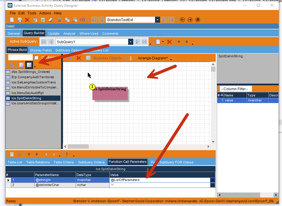

Are you cloud? If not and you can point an external datasource back to the database you can use a table valued function which will take a delimited list and give you rows.

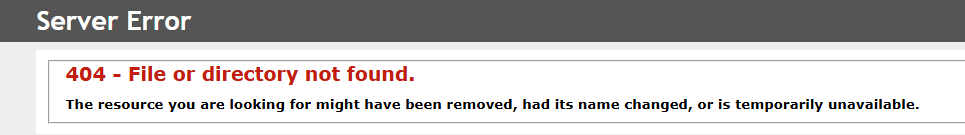

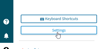

Hello,
Not to sound weird but how do I access the Epicor help pages?
I click the question mark on the bottom left and then click any article and I get this:
