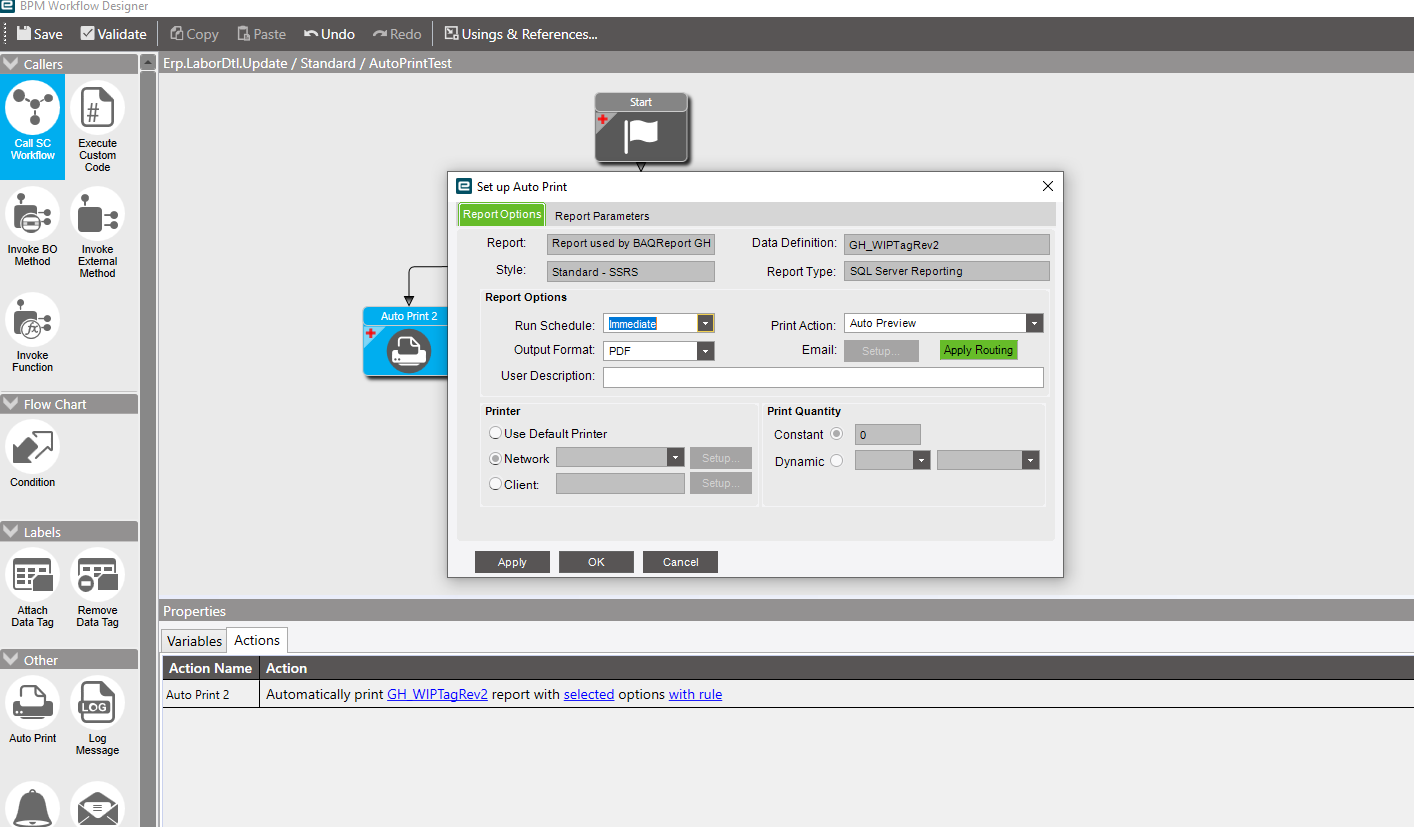

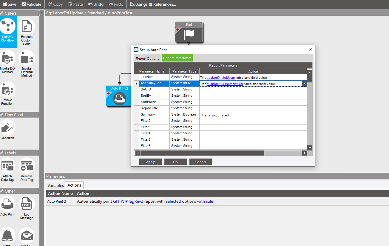

Hello,
I am working on an auto-print BPM for a BAQ report. The BPM is simple—it checks the LaborDtl table and triggers the report to print preview when the report quantity is greater than 0.
However, when I test the print function, the reports remain pending in the active tasks within the system agent. Any idea what I do wrong?
Here’s how the BPM is set up:

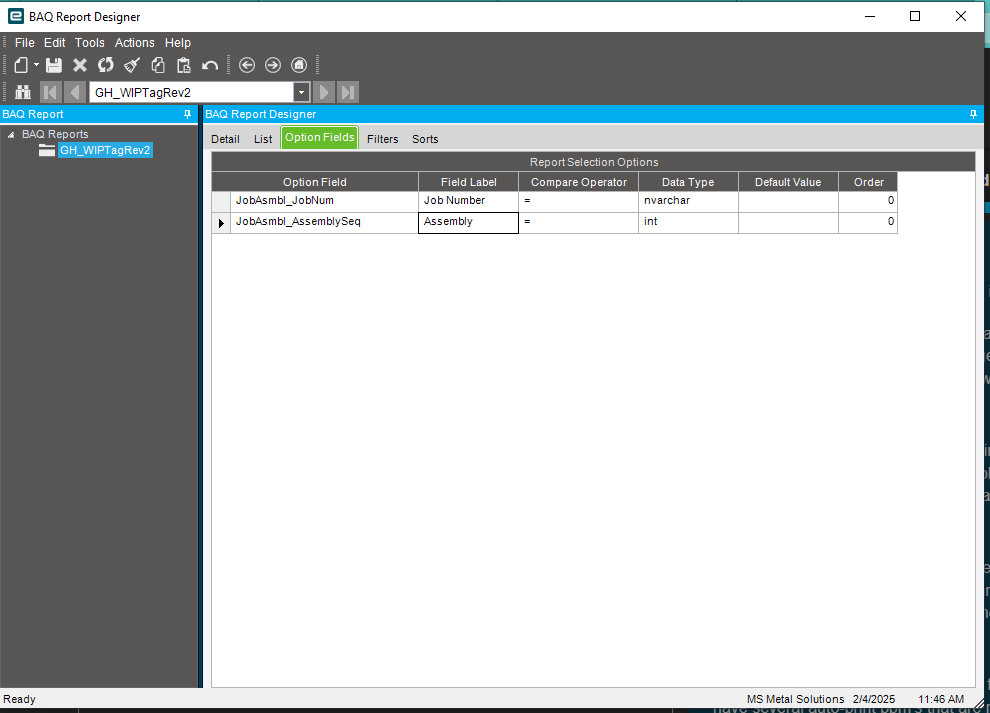

I do have two option fields set up on my BAQ report.
Thank you in advance,
Eric

The print action of Auto Preview looks problematic to me.

And setting the RunSchedule to Queued.

Hi Hally,
That’s it! Set it to Queued, and problem solved! Thank you so much.

Hi Dan,
Yeah, it was the Run Schedule that Hally pointed out. Thank you.
