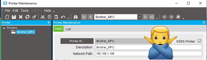

  3. Can’t reference an IP address in server-printer maintenance; it needs to be shared from some machine and that share path needs be entered in printer maintenance.
Printer maintenance requires a UNC path to a shared printer
Cannot directly reference the IP address of the printer

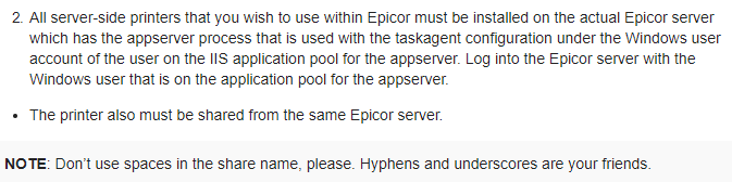

  2. All server-side printers that you wish to use within Epicor must be installed on the actual Epicor server which has the appserver process that is used with the taskagent configuration under the Windows user account of the user on the IIS application pool for the appserver. Log into the Epicor server with the Windows user that is on the application pool for the appserver.
  • The printer also must be shared from the same Epicor server.
NOTE: Don’t use spaces in the share name, please. Hyphens and underscores are your friends.

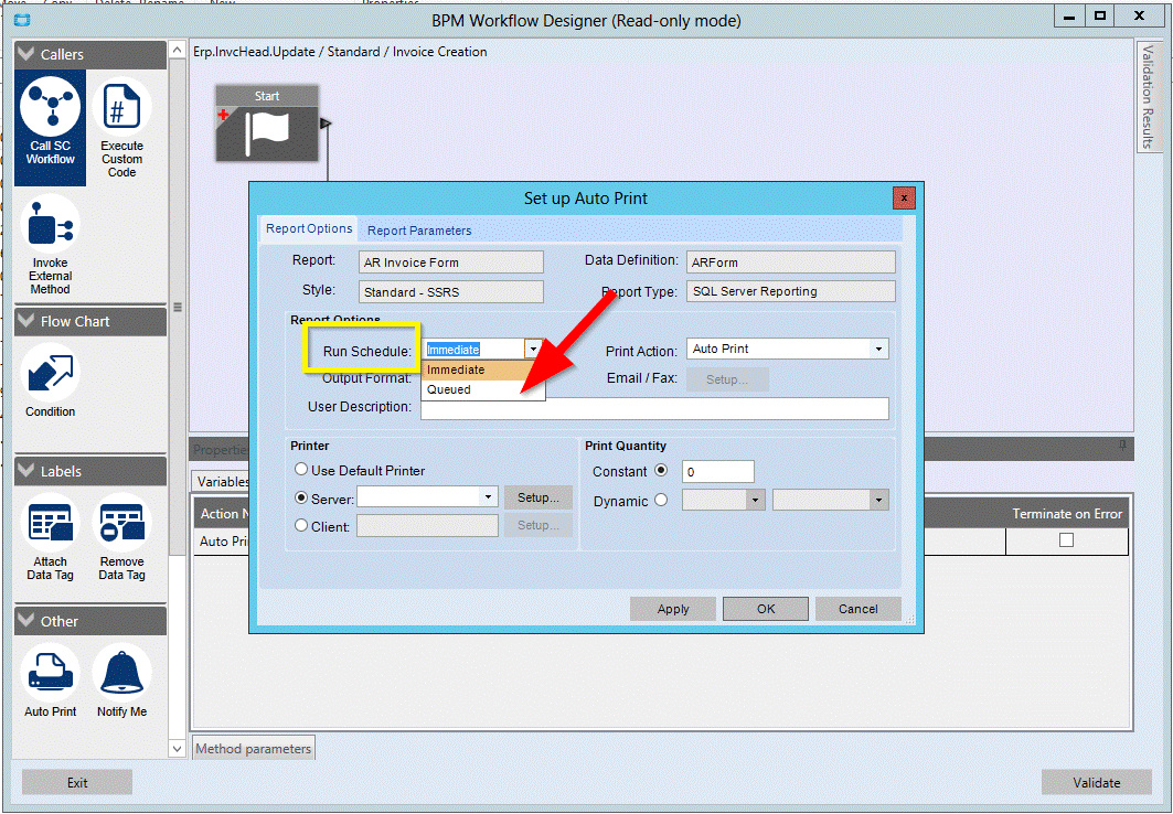

  1. When using autoprint BPMs, always start by making sure to configure your BPM to run QUEUED so that it processes like a client-side printing process instead of IMMEDIATE which processes like a server-side printing process until you know your BPM autoprints successfully. Once you are really, really sure, then change it to IMMEDIATE and retest. If there are any issues, you know where to look next. Even so, I always leave my autoprint BPMs as QUEUED.
Cheat sheet:
QUEUED=how every print request you have submitted from within Epicor ERP up to this point behaves.
IMMEDIATE=server-side printing AND server-side processing. I touch on this in a response to this article with the difference between IMMEDIATE RUN REQUEST vs SERVER-PRINTING vs IMMEDIATE PRINTING.
NOTE: IMMEDIATE from the BPM perspective means it processes on the appserver that the client is connected to when the BPM is triggered, not the one that is configured to handle background processes unless you only have one appserver process which handles both interactive (aka: user sessions) and background processes (aka: things that flow through the system monitor). If you only have one appserver process in production, you should correct that by adding another one just for background processes.

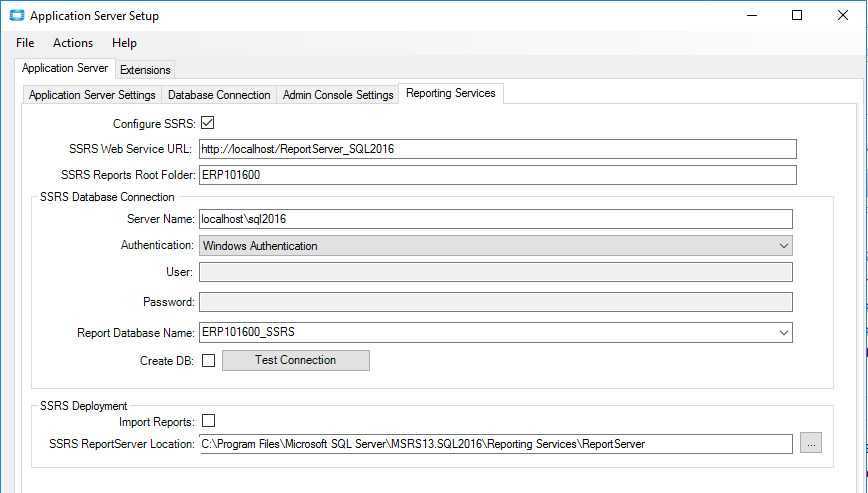

  1. Since we are talking about IMMEDIATE processing, every appserver process connected to the Epicor database must be configured for SSRS printing in the Epicor Administration Console, and the same web service URL, root folder, and report database name must be used–if you have interactive and dedicated appservers already and have not configured SSRS against the interactive, that would need to be completed.
This is a screenshot of my dedicated background processing appserver > EAC> appserver Server Configuration > Application Server > Reporting Services tab. This is on a server named hv-win2008r2svr.
This is a screenshot of my interactive client appserver > EAC> appserver Server Configuration > Application Server > Reporting Services tab. This is on a server named hv-win2016svr. They are pointing to the same web service URL, root folder, and report database name. Good!

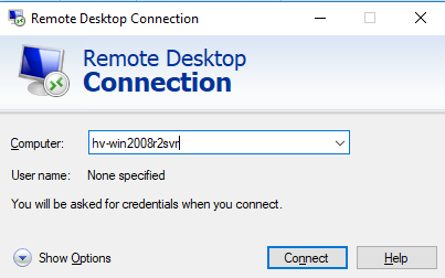

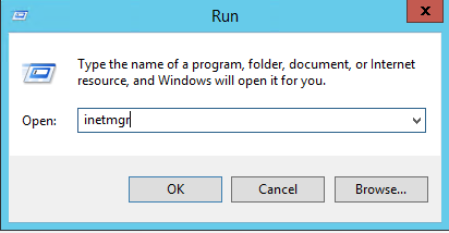

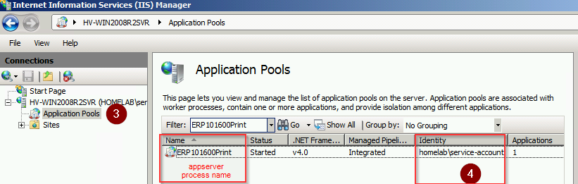

~DETERMINE THE USER ACCOUNT ON THE ERP101600PRINT WORKER PROCESS(AKA: APPSERVER PROCESS) ON THE HV-WIN2016SVR SERVER:
  1. RDP into HV-WIN2008R2SVR with a user account that is a member of the local administrator group.
  2. From the Windows run line, enter “inetmgr” (without quotes) and press ENTER.
  3. Expand [NAME OF SERVER] from the left pane (e.g. HV-WIN2008R2SVR) and click on Application Pools.
  4. Locate the ERP101600Print application pool. Note the identity/Windows user account on the process. In my screenshot, it would be homelab\service-account
~LOG INTO HV-WIN2008R2SVR WINDOWS SERVER WITH USER ACCOUNT SET AS IDENTITY ON ERP101600Print WORKER PROCESS:
  1. RDP into HV-WIN2008R2SVR with a user account that was set as the identity for the appserver process in the previous section.

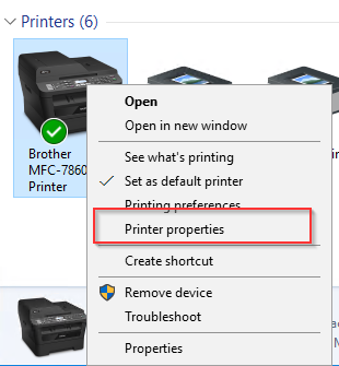

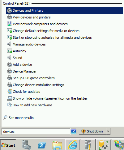

  1. Click the Windows button, and search for Devices and Printers.
  2. Right-click on the printer that was installed, and select Printer properties.
NOTE: I already had these screenshots from a Windows 2016 server, so if you are using Windows 2008R2 it will look a little different.

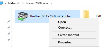

  1. Click on Sharing tab.
    a. Check the box for Share this Printer.
    b. Share name: Something meaningful without spaces in the name.
    c. Render print jobs on client computers should be enabled as a general best practice in a LAN environment, but it can decrease performance in a WAN environment. You may need to experiment for the best configuration for your usage.
    d. click Apply then OK.

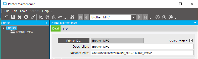

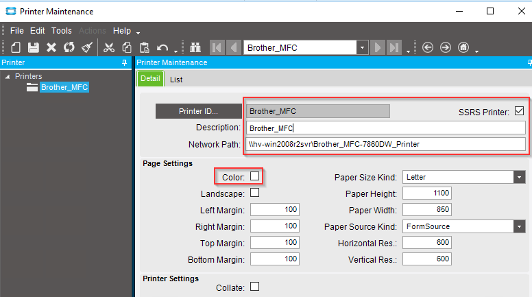

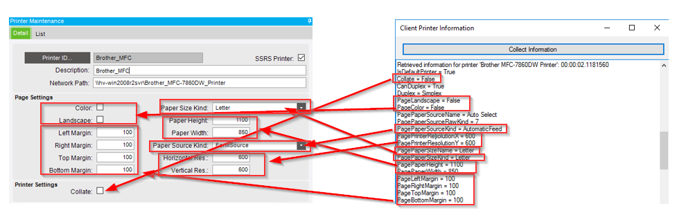

~CONFIGURE THE PRINTER WITHIN ERP CLIENT:

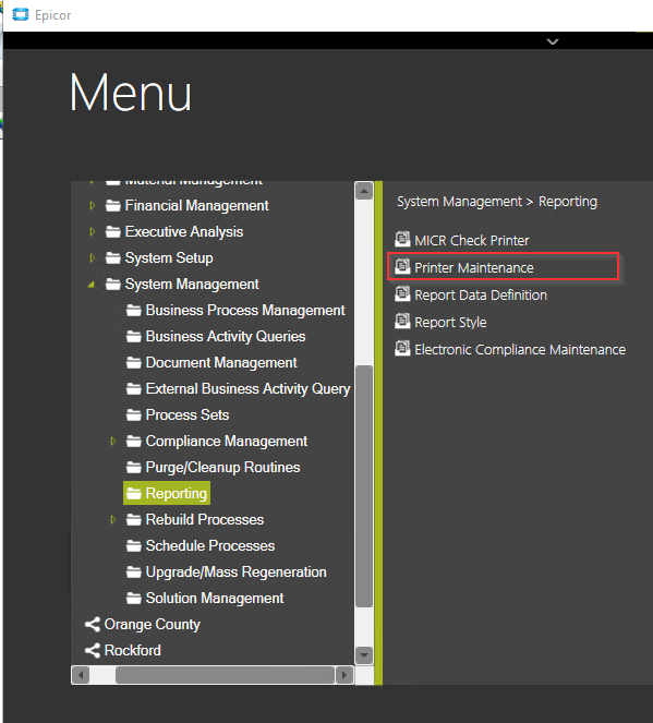

  1. Log into the client with a security manager account.
  2. Navigate to System Management > Reporting > Printer Maintenance.
  3. File > New
  • Printer ID: Something meaningful without spaces in the name.
  • Description: Something meaningful, spaces OK.
  • Network Path: \[Epicor Print Server Name][ Shared Printer Name] .
  • Make sure that SSRS Printer is checked.
  • If the printer is not a Color printer, deselect Color.
  • Make any other adjustments to margins, paper size, etc as needed.
  • Press Save and close out of the Printer Maintenance Window.

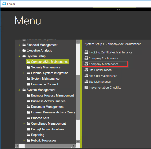

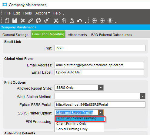

~CONFIGURE COMPANY MAINTENANCE RECORD TO ALLOW FOR BOTH CLIENT AND SERVER-SIDE PRINTING.
  1. While logged in with a security manager account, navigate to System Setup > Company / Site Maintenance > Company Maintenance.
  2. Click on Email and Reporting tab.
  3. In the Print Options section, in the SSRS Printer Option dropdown, select Client and Server Printing if it is not already.
  4. Save your changes.
  5. Close out of the client.
    NOTE: Whenever a change is made to the Company maintenance record, it should be assumed that in order for users who are currently logged in to see the change that they would need to log out of the session and log in to create another one.

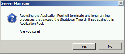

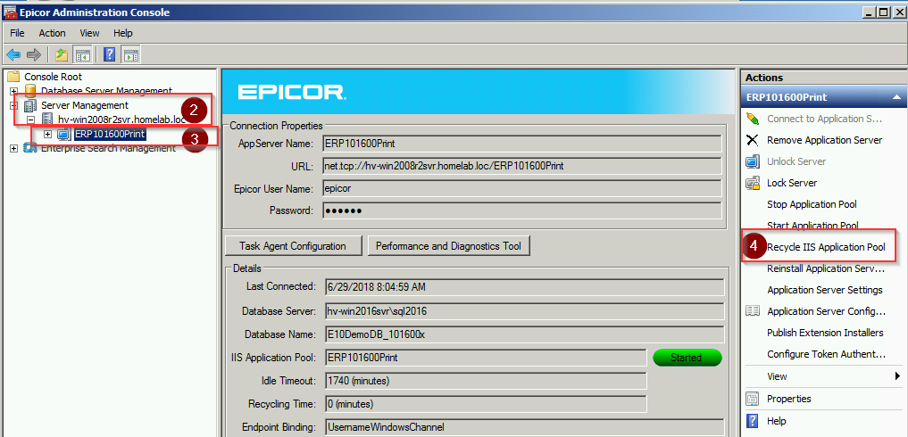

~RECYCLE THE ERP101600Print APPSERVER ON hv-win2008r2svr (this just makes me feel better; it isn’t actually needed):
NOTE: If you are doing this in a production environment, make sure that there aren’t any active tasks in the system monitor before recycling the appserver process.
  1. From the desktop of the hv-win2008r2svr, launch the Epicor Administration Console.
  2. Expand Server Management > [Name of server]
  3. Click on the name of the appserver process.
  4. From the Actions panel, click Recycle IIS Application Pool.
  5. When prompted “Are you sure?”, click Yes.

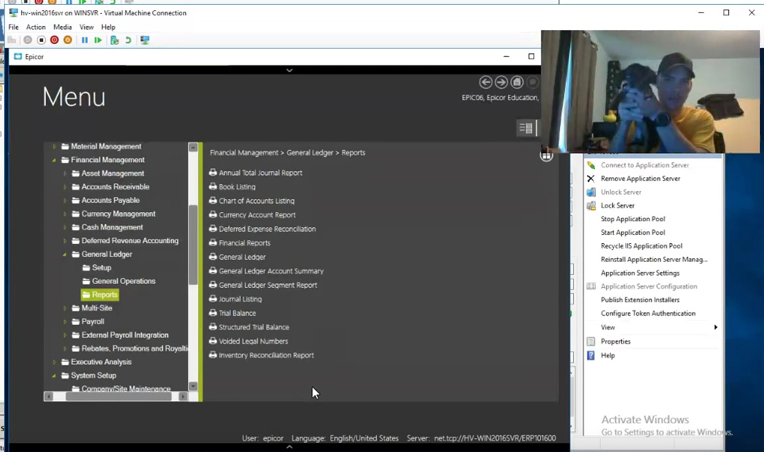

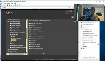

~PRINT REPORT FROM WITHIN THE CLIENT:
Video of me and my happy helper Buttercup showing the world that server-side printing works.

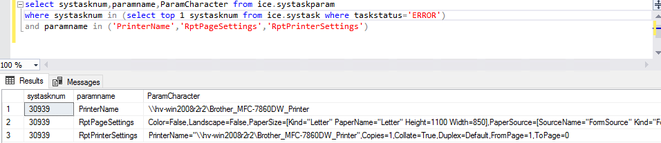

  • ISSUE: Say you are getting something like this:
    Program Ice.Services.Lib.RunTask raised an unexpected exception with the following message: RunTask: Settings to access printer '\\hv-win2008r2r2\Brother_MFC-7860DW_Printer' are not valid.
  • POTENTIAL RESOLUTION 1: This is a generic error that means “hey, it didn’t work”. Start with reviewing everything in the guidelines and implementation sections. If you thought you could get away with XYZ thing that deviates from what was recommended, go back to do it the way that I said and try again.
  • POTENTIAL RESOLUTION 2: On the server that you installed and shared the printer, download the following client printer helper tool our development team created for an unrelated reason from: https://1drv.ms/u/s!Arusj_dIaLAVg0VFrVWzYikhH_jD . Download and launch the .exe, then click Collect. Change what is in Printer Maintenance to match what is displaying in the Client Printer Information program.

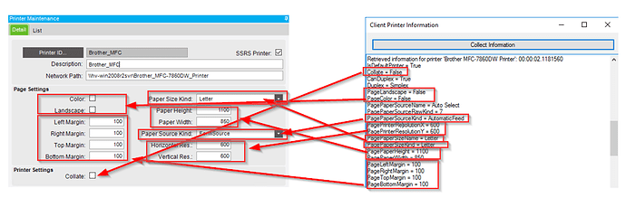

NOTE: As you can see, my paper source kind doesn’t match what is appearing in the Client printer and it works fine–only match everything up at this level if you have eliminated other causes.
NOTE: In this case, it was because I mistyped my server name :frowning:
  • ADDITIONAL INFO 1: Anything that shows up in the System Monitor has a record on ice.systask and at least one ice.systaskparam. If one were to query the ice.systask table for the report that threw an error to find the systasknum. Then, queried the ice.systaskparam table to see all the parameters that the report was submitted with. You’d find that there are three parameters that are interesting as it relates to printing: PrinterName, RptPageSettings, and RptPrinterSettings. You can use this to determine the parameters that ERP is passing to the printer match up with what the printer is expecting.
NOTE: This is why the generic driver is recommended as some drivers need additional parameters passed to complete the request than what we can pass by default.

  • you actually want to use IMMEDIATE run BPMs on your X number of interactive appserver servers, and thankfully SSRS printing is already enabled on all appservers :ok_hand:
  • the application pool identities are the same on every ERP appserver application pool.

  1. Pick one taskagent server to go through the process laid out above. Fully test it. If you need to disable two of the taskagent configurations to control which server/appserver/taskagent processes a request, do so. It works there, woohoo!
  2. On every other server that has an appserver process (the two remaining task agent servers, the X number of interactive appservers, etc), log in with the same user account that is set as the application pool identity on the one taskagent server you already got working with server-side printing.
  3. Browse to the server that has the shared printer from step 1 and simply connect to the printer.
  4. Restart all of the appserver machines (just in case).

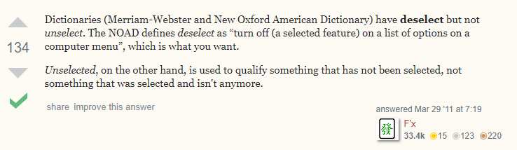

deselect?
To make an option that is selected not selected. Like if a checkbox is currently “checked” deselect would mean unchecking it.
ClientPrinterInformation.txt (12.5 KB)
rename the attached to have an .exe extension and then execute.

@aidacra: If its a color printer, deselect
Epicor Help: if its a color printer, select [ Indicates if the page should be printed in color. ]
I was wondering if there is a reason, if it is a color printer to deselect it, unless you meant if you want to print B&W deselect it?
