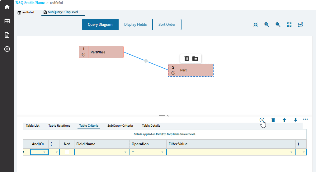

Kinetic BAQ designer - can no longer have criteria on two different tables in the same subquery?
Is anyone else struggling with this issue in 2025.2? It seems like the baq designer isn’t seeing the two table widgets as unique. I have recorded what is happening since its hard to explain. Anybody already have a PRB for this? I can’t find a workaround, having to go back to classic BAQ designer, again, at 2025.2.

I just tried it in our 2025.2 DB but didn’t get the issue:
Shocked Oh No GIF
It definitely seems to be intermittent. But like with this baq, I can close it and reopen it and the problem persists. Probably have to delete it and start over.
I had a similar bug where I copied a subquery, and the criteria were linked between them.
you better export it first if you can repro reliably
So that’s funny. I exported it from live, imported to third, and it lets me set the criteria properly in third.
Epicor should be willing to fix bugs even when they can’t be reproduced reliably.
Could not reproduce in live - 2025.2.7 We are cloud. Often with bugs like this, I close or delete the offending BAQ, Dashboard, Event, or widget, then start over. I agree Kinetic sucks. No amount of Epicor begging us to think otherwise will help.
