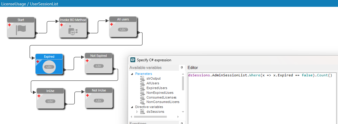

  2. Count only the rows of the table returned by the Where clause:
    ds.table.Where(x => x.field1 == value).Count()
    (Parentheses after Count but nothing inside)

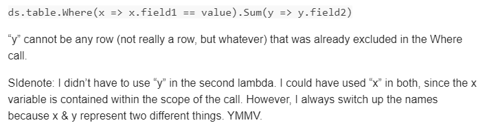

  3. Sum a field of the data returned by the where clause:
    ds.table.Where(x => x.field1 == value).Sum(y => y.field2)
    (Parentheses after Sum and need lambda expression inside the parentheses)
I kept trying to do Count(x => x.something) a la #3. But that is not real.
(Yes #3 is exactly what @jtownsend posted earlier. It’s an example, not my example.)
