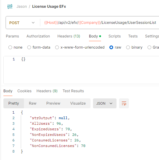

I made a separate EFx just to show me active and inactive users. They are nonzero in Production as shown in Postman:

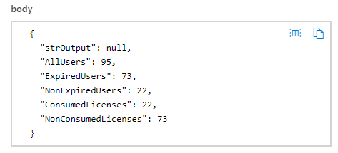

Now here is that same EFx in Power Automate (also Production) - all zeroes! And status is 200 OK.
So did I just mess up the Flow? Or is there something else going on here?
Anyway, I don’t know why I didn’t just schedule the deletion EFx in Epicor (instead of a Flow), but I did now and I’ll see what happens tonight.
For some fun background reading:
Is the user the request being sent as also Security Manager in Power Automate?
Ah. No it is not.
Yes in Postman, No in PA.
I bet that’s it.
You might need Global Security Manager - not sure
That’s it!
I knew you were right as soon as you said it. Creating a new user also has the same restriction in REST. But since that’s the only time I’ve ever encountered the restriction, I just forgot all about that possibility.
