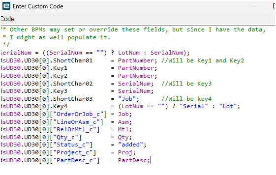

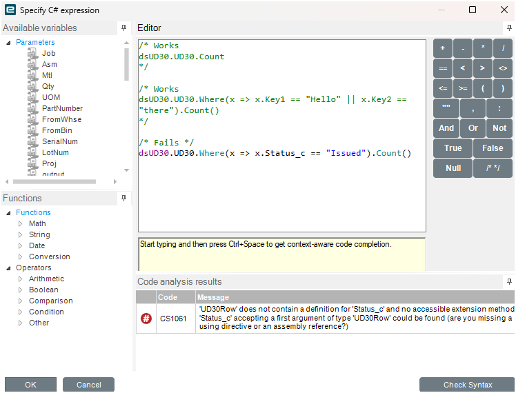

So, you’d all be proud: I hacked at some lambda notation all by myself (for this project). I sure don’t understand it, but I think I can use it. (Not all that different from a lot of other “skills” I have…)
@jtownsend, This pseudocode is perfect, by the way:
Something I discerned along the way: Count has different personalities.
  1. Count all rows of a table:
    ds.table.Count
    (Notice the lack of parentheses)
  2. Count only the rows of the table returned by the Where clause:
    ds.table.Where(x => x.field1 == value).Count()
    (Parentheses after Count but nothing inside)
  3. Sum a field of the data returned by the where clause:
    ds.table.Where(x => x.field1 == value).Sum(y => y.field2)
    (Parentheses after Sum and need lambda expression inside the parentheses)
I kept trying to do Count(x => x.something) a la #3. But that is not real.
(Yes #3 is exactly what @jtownsend posted earlier. It’s an example, not my example.)
Robert Carradine 80S GIF
Yeah, object.Count and object.Count() are slightly different things.
Count (no parens) is a property of the object, like the table name.
Count() is a LINQ method that first looks for an object.Count property and returns that if it finds it. If it doesn’t find a Count property it will iterate through all of the child objects (rows) of your called object (table) and return a count of everything it finds.
Does any of this make a practical difference? Nah…probably not in Epicor land. The main takeaway is that “no parens” == “property lookup”, while “yes parens” == “method call” (and therefore a more complex routine).
