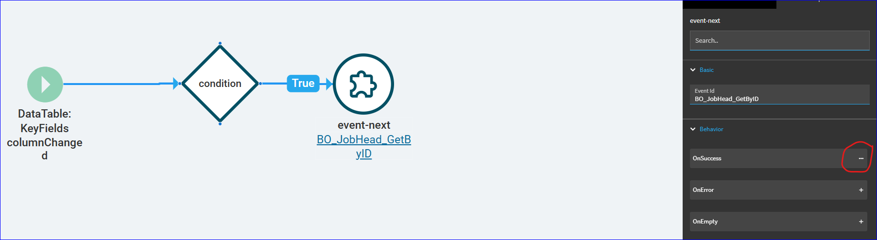

Do you have a PRB or Case for this? I’m running into as well. Almost pointless to try to customize right now when my events keep getting modified.
I had a string of components in this event that all got wacked. The first was an OnSuccess… the event remembers there is/was one, at least, that’s what the circled (…) typically indicates. If I click on it, nothing happens.

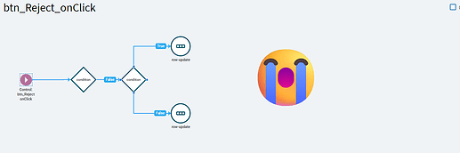

This just happened to me today after installing the cab with the layer into a different environment. Poof, all my events were gone. :frowning: what a PITA.

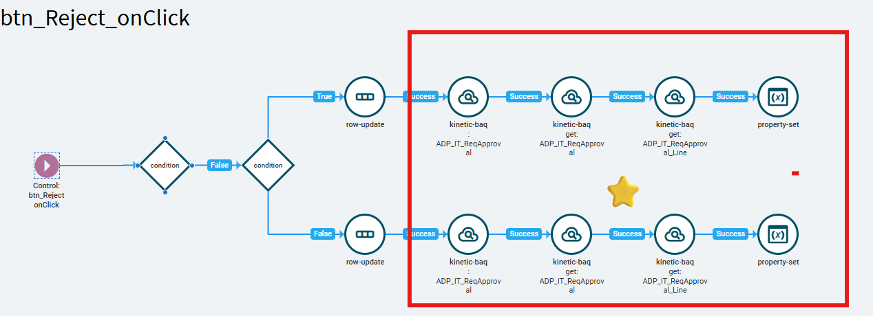

This has been a thorn in my side while developing kinetic apps. Through tracing and trial and error, I think i’ve got the trigger that causes this down to the usage of the “onSuccess” connector. Looking at @iarunkumark’s screenshots in OP, the disappearing events there are also tied to onSuccess.
For now, i’ve stopped using onSuccess where I can, and when I have to work on an event that contains an onSuccess, I seem to have the best luck with editing/saving it correctly if I open the layer to a fresh new tab, open only that event, modify only that event, and save only that event, then close the tab.
I’ve got a reliable repro scenario where the initial time the event is open it is rendered properly, edits properly, and saves properly. But if I close the event tab and open it again, all widgets after the ‘onSuccess’ connectors are obliterated.

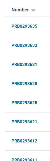

Their lack of response is a little frustrating. I know sometimes they take awhile to evaluate, but have they responded AT ALL? Was the case ever assigned to an individual?
You may want to escalate it and at least make sure your case has been evaluated. Time to verify the problem and time to identify a solution is understandable (we won’t speak about time to deliver said solution)… but if they’re not responding at all, I would escalate.
And curiously looking at the problem repository your problem is not there :angry:

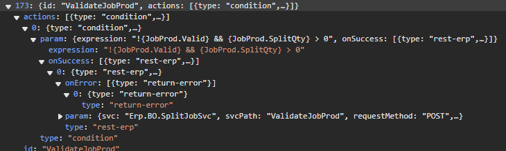

I’ve run into a test case with Epicor’s out of box developed stuff, if someone could validate they see it too.
Load app studio, f12 to load dev tools.
In dev tools settings, make sure “Auto-open DevTools for popups” is enabled.
Open the base layer for SplitJobEntry, in the new devtools window, go to the Network tab and navigate to the GetApp call on the left.

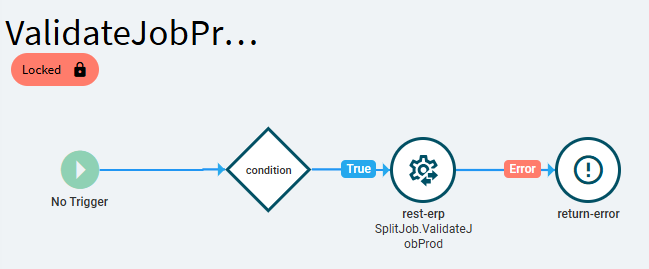

In the Preview tab of the GetApp call, expand the tree to the following node (this step is just to validate that the “return-error” widget is present in the ValidateJobHead event):
Events->173 (id: ValidateJobProd)
Events.173.actions.0.param.onSuccess.0.onError

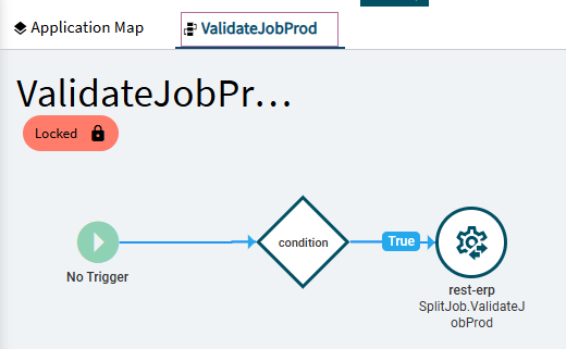

In App studio window, navigate to Events → User Defined Actions → ValidateJobProd
The very first time you open it, you should see the event matches the json payload (there is an onError connector following the onSuccess → rest-erp):

The events post onSuccess have magically been nuked!
If we were to create a new layer and save now, with dev tools open, we would see that the “onError” branch does NOT get saved.
