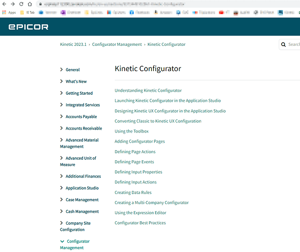

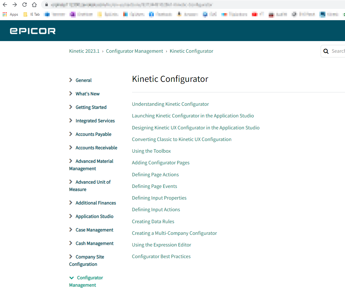

Does anyone know if Epicor has released any documentation yet for creating configurators using the App Studio toolset? The most recent tech ref I can find (2021.1) for the configurator still gives the good ol’ Wave Rider example using the Infragistic interface.
@timshuwy Any Idea if something similar exists for the Kinetic UI?
Thanks in advance!
when you are in Kinetic, you can get to the help and the browser based Kinetic Configurator is described there. I dont believe that the wave rider example has been updated as of yet for the new UI.
