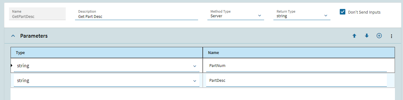

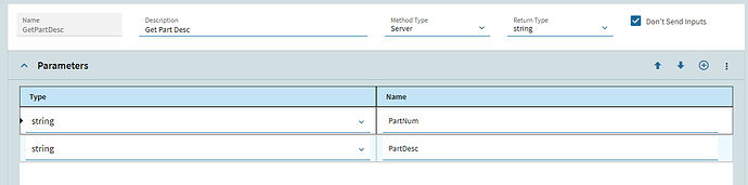

Ok, I tried what I told you and found out that it doesn’t work too. The wrinkle appears to be you can’t use the “out” qualifier on a parameter for Kinetic built UD methods. The only apparent way to return something is via the return statement. This is utterly ridiculous or there is some crazy restriction as so many of my current UD methods use the “out” method of passing multiple different items back. When it comes time to upgrade them to Kinetic it will be a challenge. I am in the process of upgrading an existing configurator and starting to think “still not ready for prime time.”
partDesc is left over from my attempts to use the “out” qualifier.
Inputs.txtPartDesc.Value = await UDMethods.GetPartDesc(Inputs.txtPartNum.Value, partDesc);

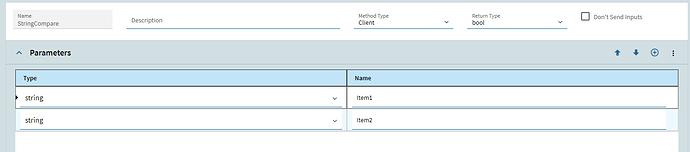

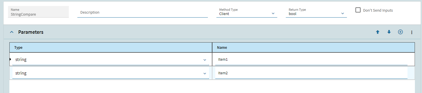

In the Kinetic UD Editor you can’t even choose to use “out” when defining your parameters. If you build the UD method using the classic UD editor it allows adding the “out”. But if you try to call the method the Kinetic editor will report a syntax error saying you can’t use “out”.

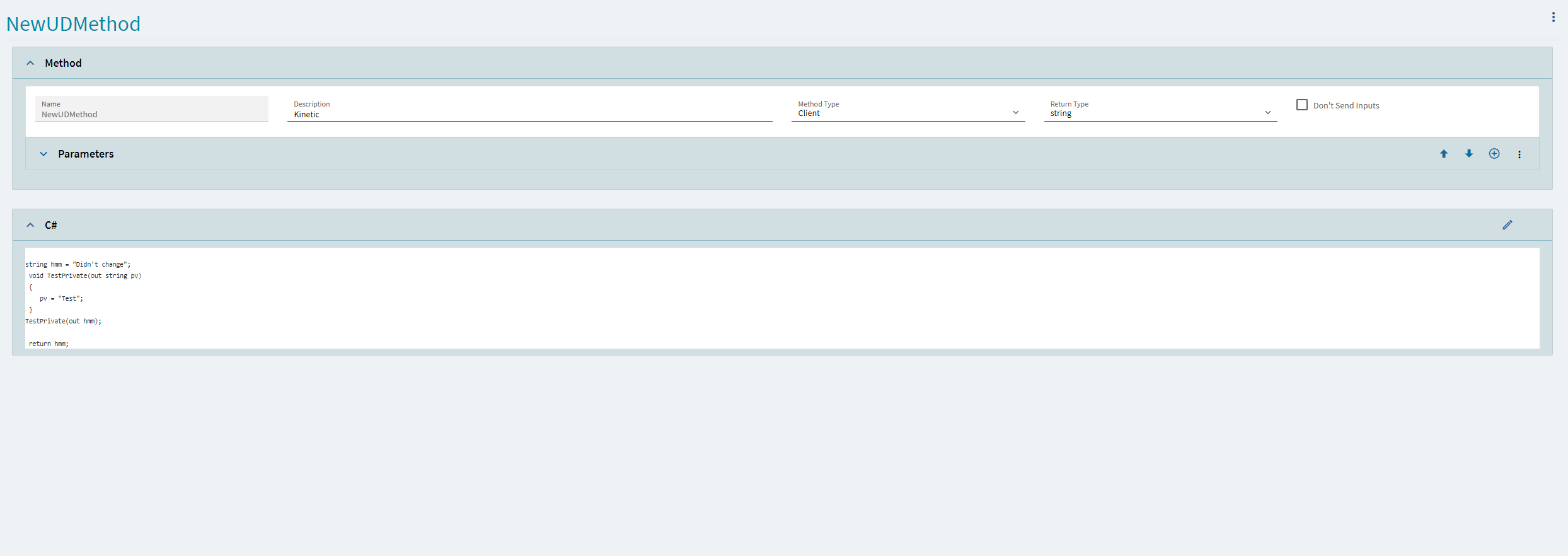

Hmm I think its a bug, as you can use out within a kinetic UD method, that is:
string hmm = "Didn't change";
 void TestPrivate(out string pv)
    pv = "Test";
TestPrivate(out hmm);
 return hmm;
And it works fine. So I would think this should be a bug report
I will open a ticket but I think they may come back with working as designed since the Kinetic UD Method Builder doesn’t allow you to define a parameter with the out or ref qualifier. Notice that there is only type and name selections in image below. You can only specify out and ref using the classic UD Editor.
