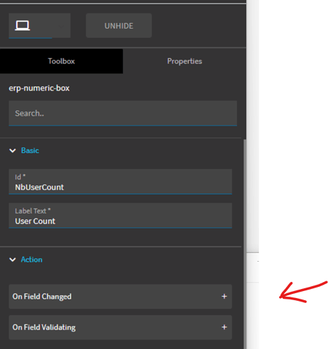

I had another play with this today and have figured it out, so if anyone is interested, here is how
using the on field changed or validating, just like previous, we get this

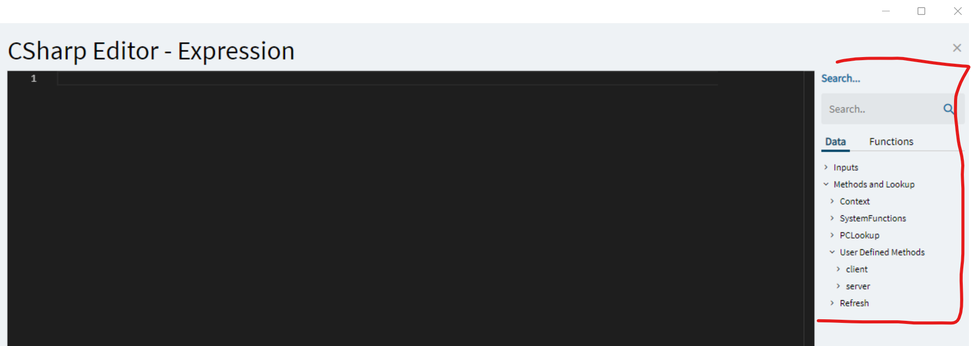

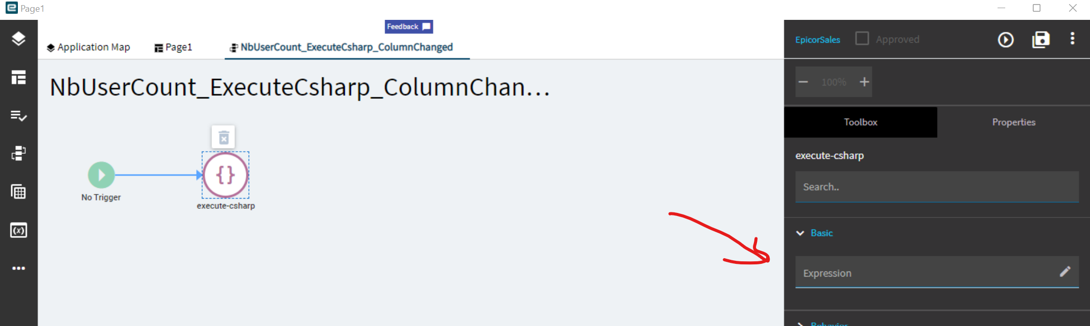

editing the expression
takes us to where we want to be
