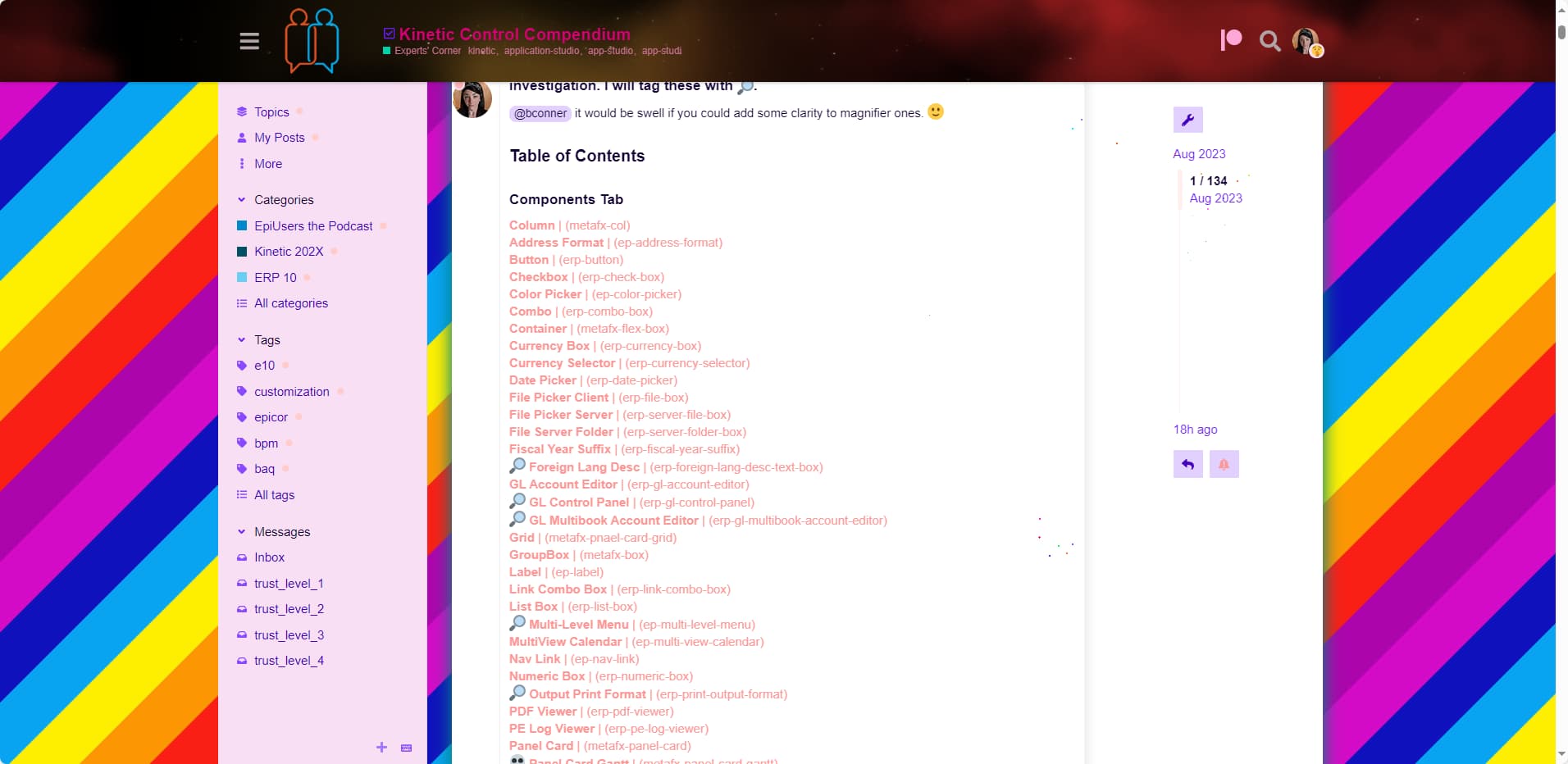

I would have never found it, where is that naming nomenclature haha

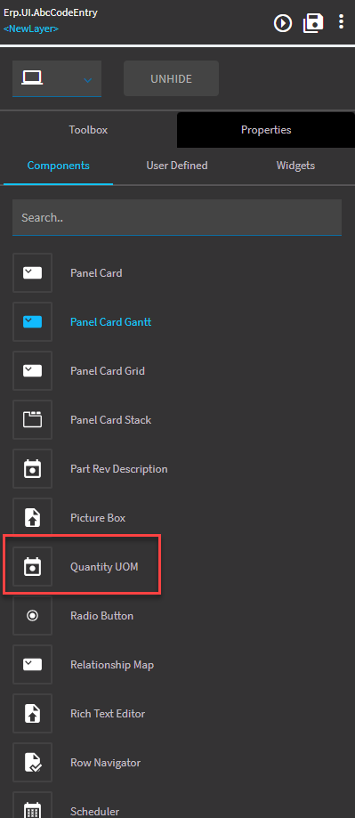

never mind @hmwillett I found it I think:
Is this what you are using as the name of each of these posts?
Idk that doesn’t match “Quantity UOM” either.

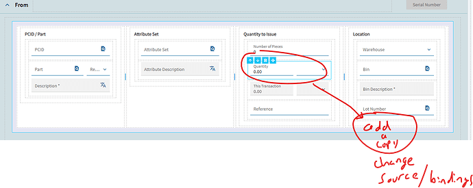

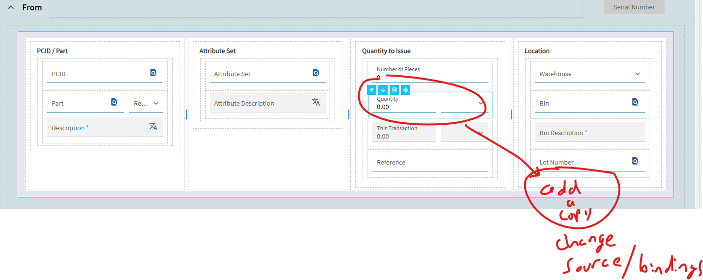

@hmwillett the reason I ask is cause on the issue material screen in the IM dataview there are columns for on hand quantity and on hand UM for the FROM location you are issuing from but they aren’t bound to anything on the form so users can’t see them.
I’d like to add them and I feel like the optimal control would be the same control they use for this on the quantity to issue section:
Thank you @hmwillett for guiding me to the control.
Just going off of what Epicor named 'em.
I wouldn’t say the control is optimal. It’s really just [ever so slightly] aesthetically better since it combines them into a single control. The setup is really just as much work as using a numeric and combo control. #Shrug
Well I’m gonna take it from you then, I’ll just do two separate controls. Thanks for your input!

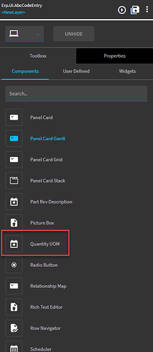

Are these names you are showing here ever found in the properties section of the control once it’s on the form???
…Kiiiind of? Lol
Hahaha that’s why I was so confused as to how I was supposed to know what the control was so I could look it up by the naming convention you are using throughout this post. And then I wouldn’t have to take up your time asking you.
I know now you are just using what Epicor gives us… which is… confusing.
