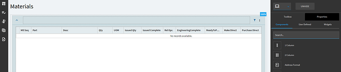

All I did in the Materials page was change what columns are on the materials list view (removed some fields and added some UD fields). Example below.

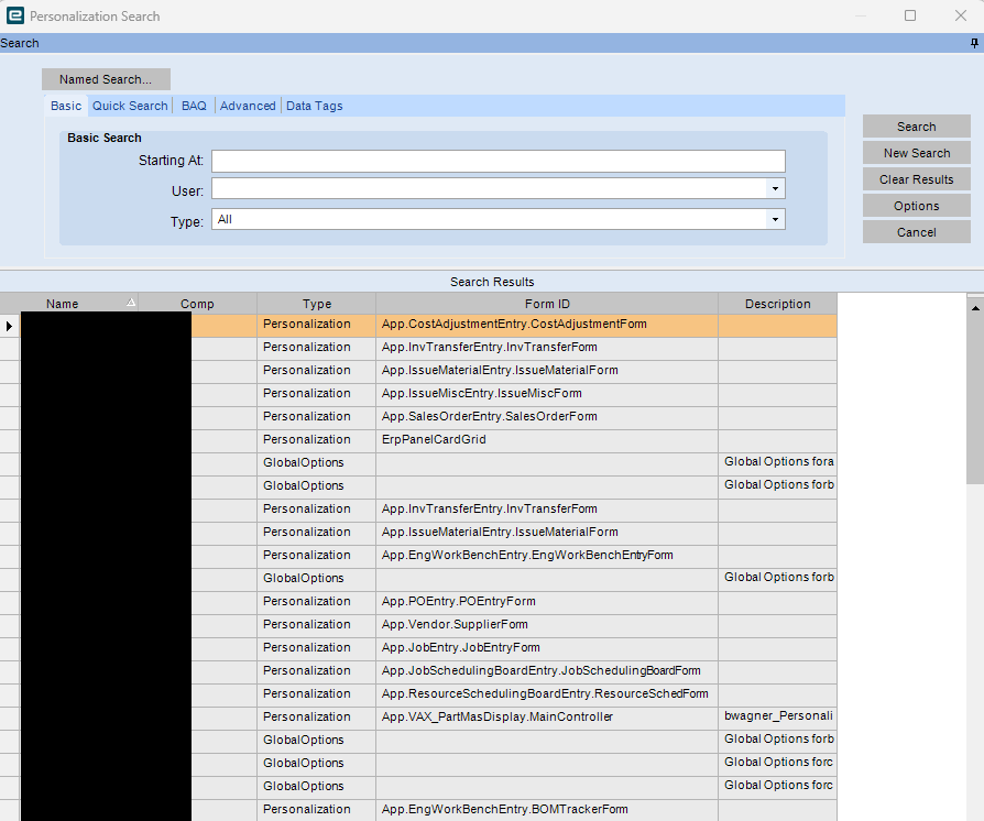

There is a Personalization Purge menu… available only via the Client unless you have Edge Agent… its a classic form (go figure).
You could jump in there and see if you can find the respective users/forms and whack any personalizations.
Here’s what the search looks like in that app.
Search, select… then in the Action Menu, you can “purge selected”. Worth a shot.
I thought that only clears the Classic Personalizations? For grins, I checked that yesterday and found 1 of the two users had as personalization on Job entry for company B that is having the issue and purged it. But still no luck after they signed out and then back in :frowning:
