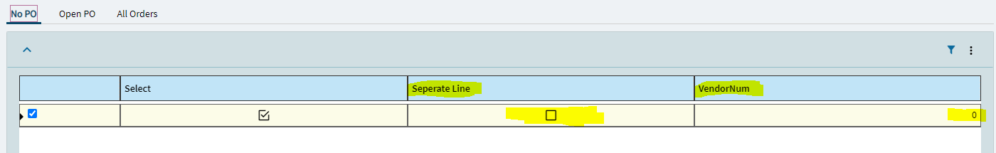

Hello,
In my dashboard, I added a grid. The grid is binding to a BAQ. It looks like I cannot change the property of BAQ columns to be editable. I tried to go to Grid Model → Columns, and check “editable”, but it did not work.
This is my dashboard,
The first column called “Select” is editable because I mark it as a Selector, but for the other two columns, I could find a way to make them editable.

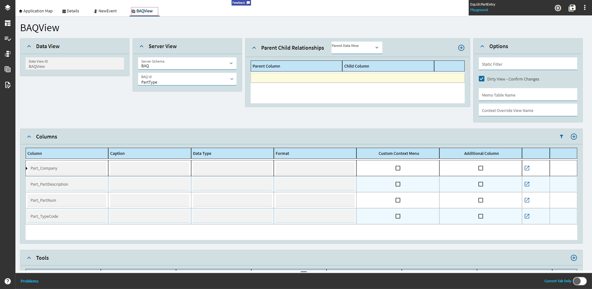

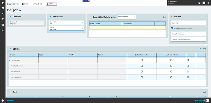

Create a view to hold the data for the update.

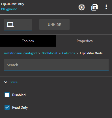

Set the column(s) as editable after adding them to the grid model in Panel > Grid Model > Columns
Set the view and the BAQ ID on the provider model.
Create a save button for your BAQ panel grid.

Create an event for that save button.
Have it call the erp-baq widget.
Set the update options.
You should probably wire up a refresh as well; I did not do that here.

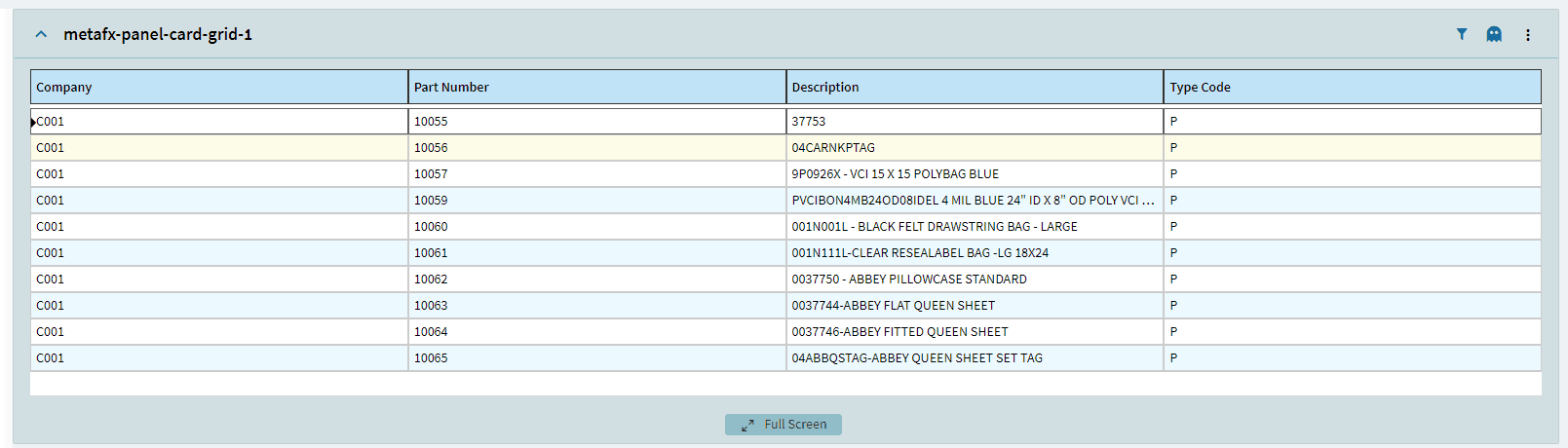

My uBAQ displays the top 10 ‘Purchased’ records. You can see that when I update 10055 to ‘Manufacture’ and refresh, it disappears off of the list confirming the update worked.

Here–throw a refresh in there too.

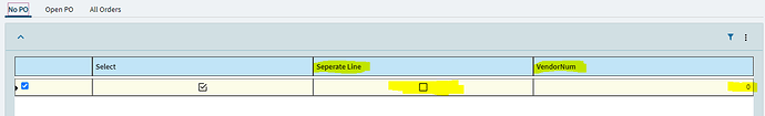

What if I don’t want to populate grid via Provider Model i.e. because I can’t set there BAQ parameters or my refresh is linked to another stand-alone field?
In that case I would like to
  1. Populate custom view with data in separate event
  2. In the grid provide only EpiBinding (to my view)
  3. Still be able to have some (not all) columns editable?
I found out that in above scenario when whole grid is not mark as editable and only some fields are mark as editable then I still can’t edit them.
From the other hand when I will mark whole grid as editable then I can’t make particular columns as read only.
Do you have any hint or solution for that?
You should be able to do all of that. Still set the binding to your view in the Provider Model, just leave out the BAQ ID at the bottom.
