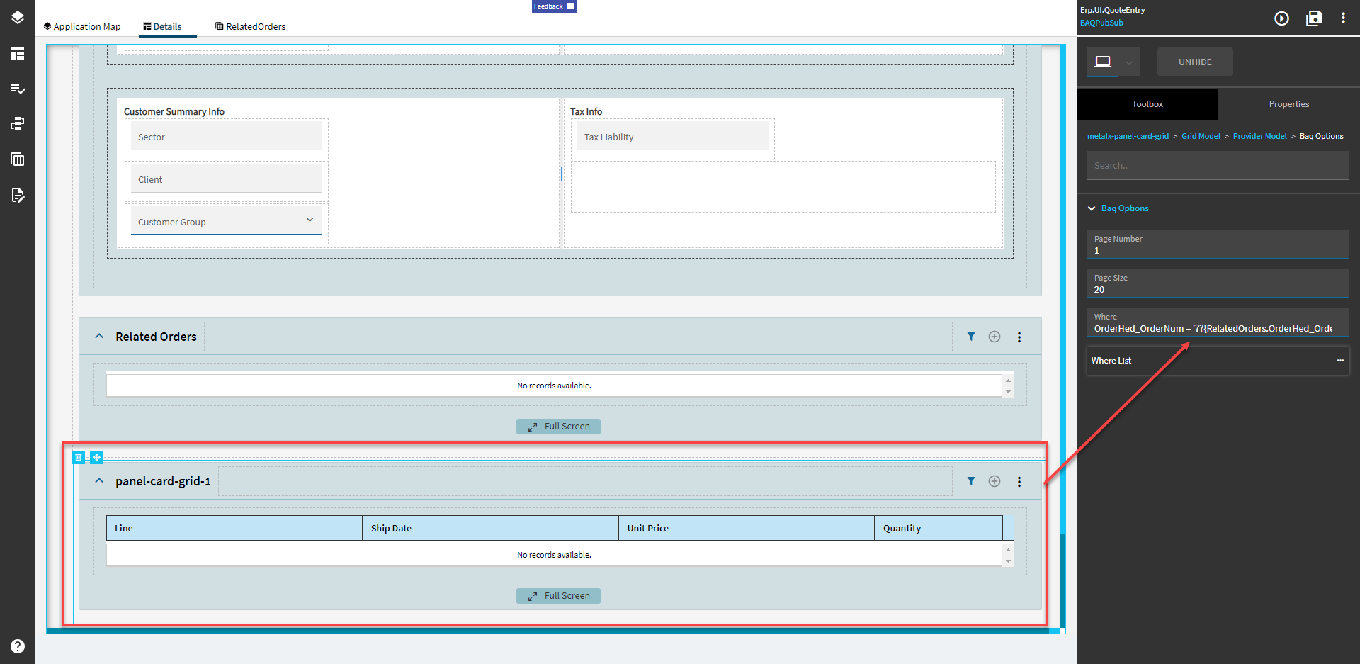

Okay, verify your data matches up with this example.
It will be similar, but not exact because I’m in Quote Entry vs a dashboard, but the concept should be the same.

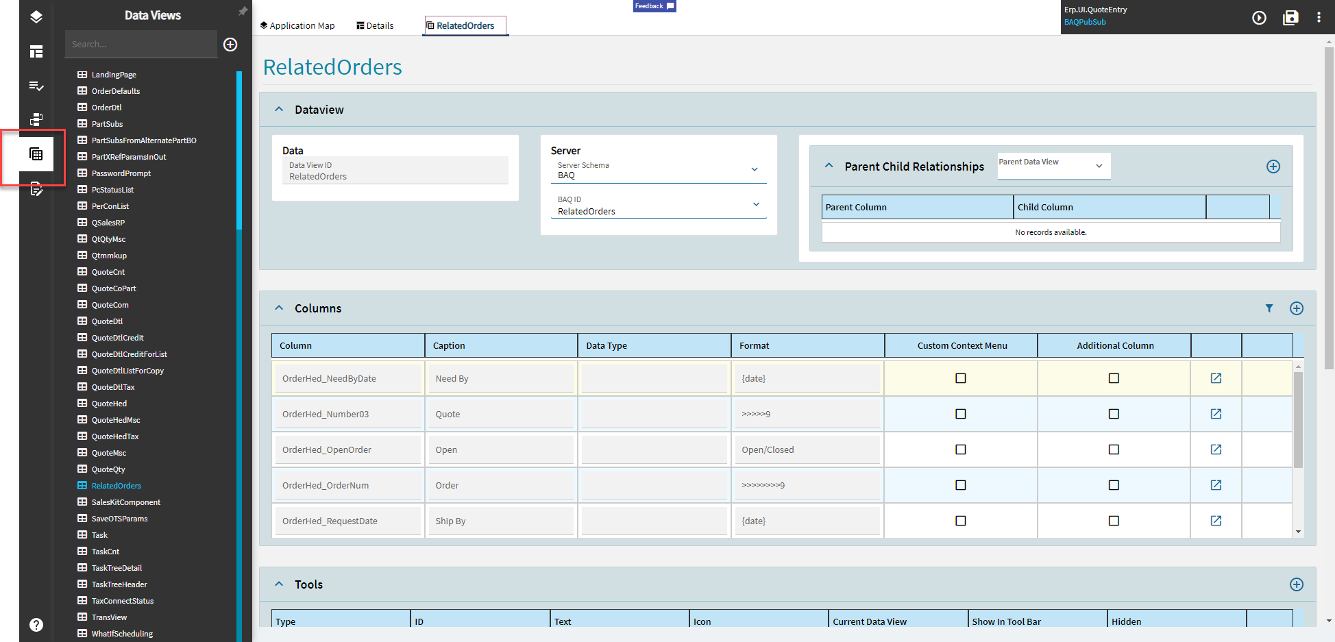

Make sure Query1 has a DataView set up (it should be done automatically from the converter).

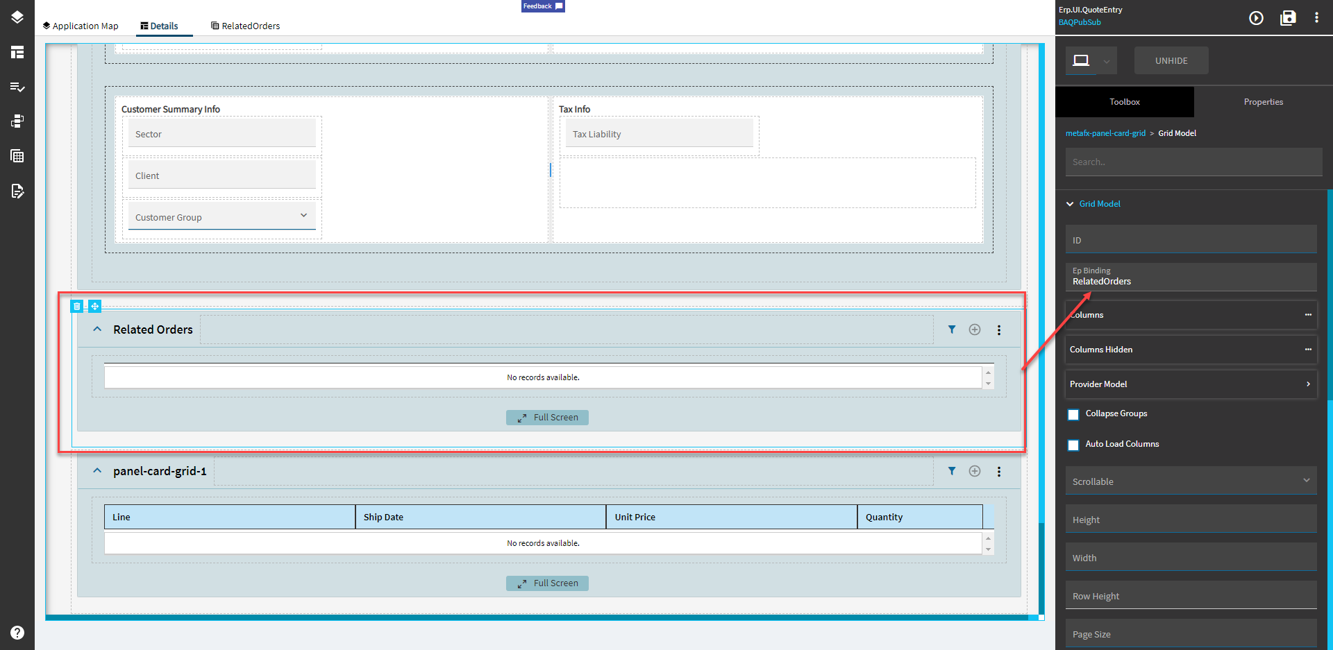

Make sure that your grid for Query1 is bound to that DataView in the Grid Model:

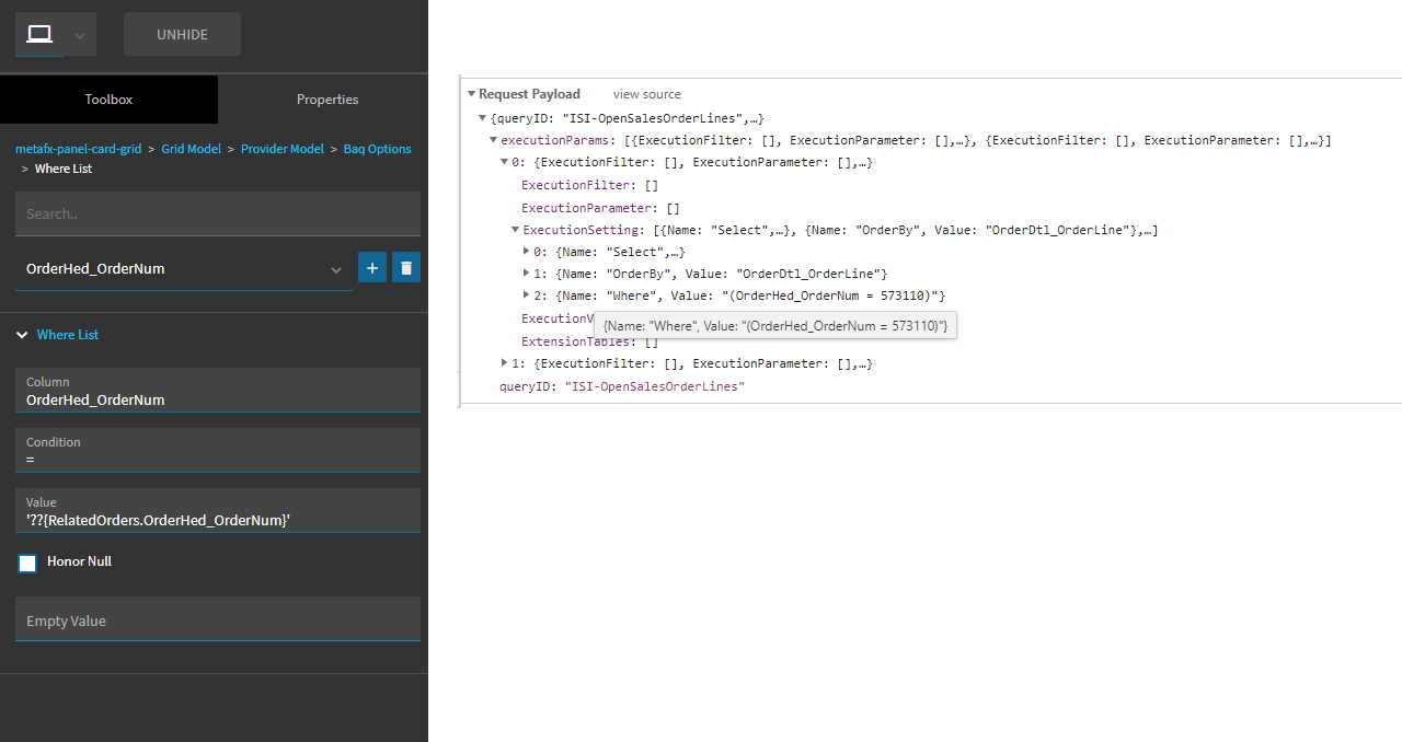

Then, make sure Queries 2 and 3 are referencing that proper DataView in the where clause (either inline like mine or in the list like your previous screenshot).
OrderHed_OrderNum = '??{RelatedOrders.OrderHed_OrderNum}'
BAQ2Table_BAQ2Field = '??{BAQ1DataView.BAQ1Table_BAQ1FieldName}'

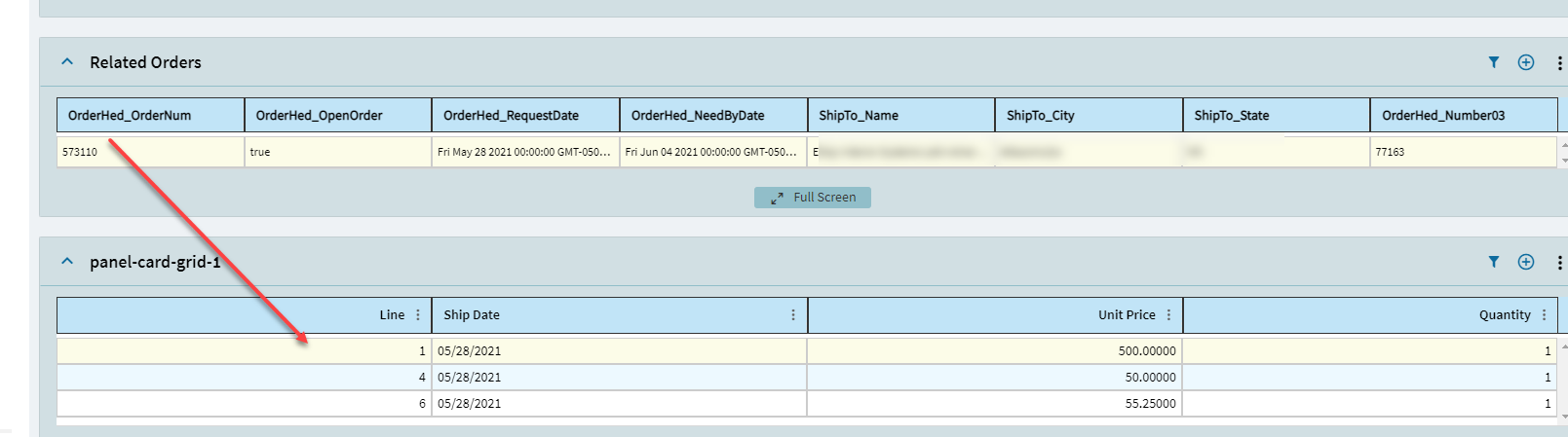

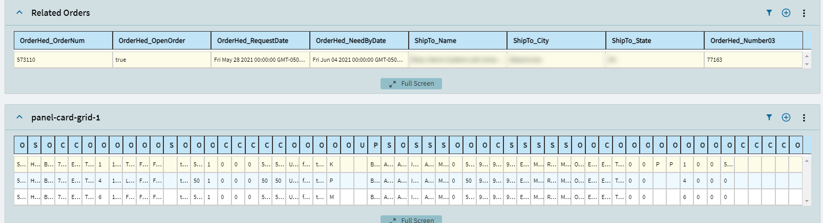

The result should be this on load:

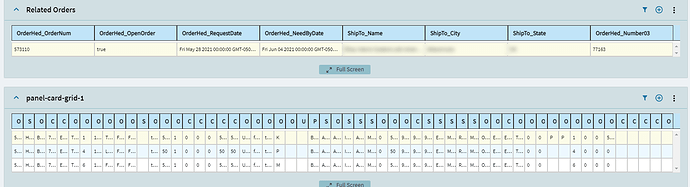

*** BLOOPERS ***
Don’t forget to only specify the columns you want to see or else you will get everything in a completely useful, not sarcastic grid. :wink:
