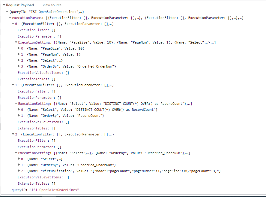

  2. Provider model grids have the “Refresh” menu item by Default - can you force refresh and see if it passes the correct JobNum in the ExecuteByID request parameters on the server call in DevTools?

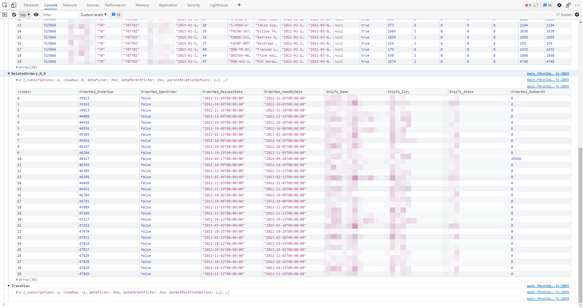

TransView has no rows and forcing the refresh does not pass anything to the where clause.
I have found that replacing the where clause from calling
'??{TransView.RelatedOrders_0_0_OrderHed_OrderNum}'
to
'??{RelatedOrders_0_0.OrderHed_OrderNum}'
makes it start working.

TransView is a runtime DataView that tends to hold temporary/runtime info.
Open up Kinetic in a Chromium browser (Chrome, Edge, etc), then press F12 to open Dev Tools.
Open up your Kinetic dashboard and monitor the “Network” tab on the Dev Tools for a call that matches what Ishkaran mentioned. I don’t recall ever seeing an ExecuteByID, but I have seen ExecuteBaq.

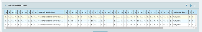

Div’s in CSS can have a horizontal scrollbar… can’t believe they dont have that in Kinetic :slight_smile: Wait did they say they had Beta Testers? I want to see the list.

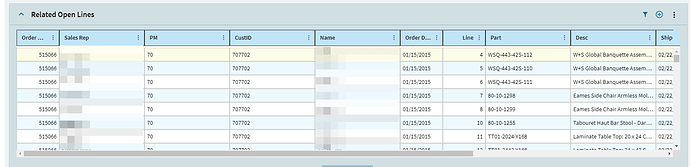

Other grids seem to have it. I just need to figure out what property controls that.
So, if you leave it to default all columns in, it will try and squish them into the grid.
If you expand a column, you can see that the scroll appears.
If you want all of your columns from the BAQ, you actually have to go to Grid Model > Columns and add each and every column in order for it to look nice with a scroll bar. :expressionless:

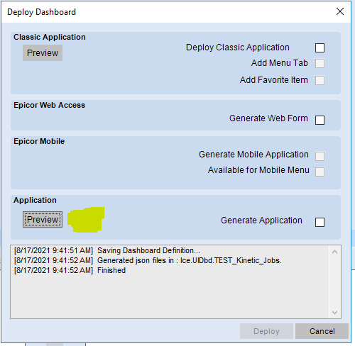

Its been a while since we have been on 10.2.6, But this is available in 2021.1.9 ( I remember seeing it before in earlier versions) You can preview Kinetic from Dashboard Maint…
Aye, you can (it’s also in 600), but if I’m going to be doing any sort of debugging in Kinetic, it needs to be in the browser which is why I deploy it to the menu. That way I can use Dev Tools.

Click the overflow menu on the secondary BAQ grid (3 vertical dots), then click refresh.

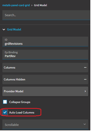

For BAQ Provider model grids - If you turn on “Auto Load Columns” in the grid-model it is supposed to space out the columns, get the right titles, get everything from metadata etc.. But there is a bug that it works that way just in Preview mode :frowning:
(There is a case already submitted for this)
Hmm, doesn’t seem to do it for me, even in Preview Mode.

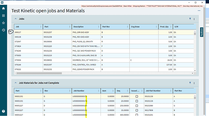

Here is an observation…

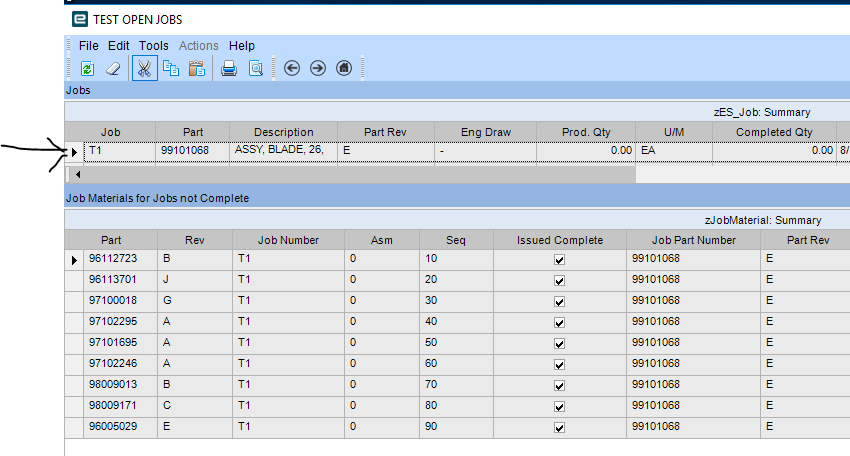

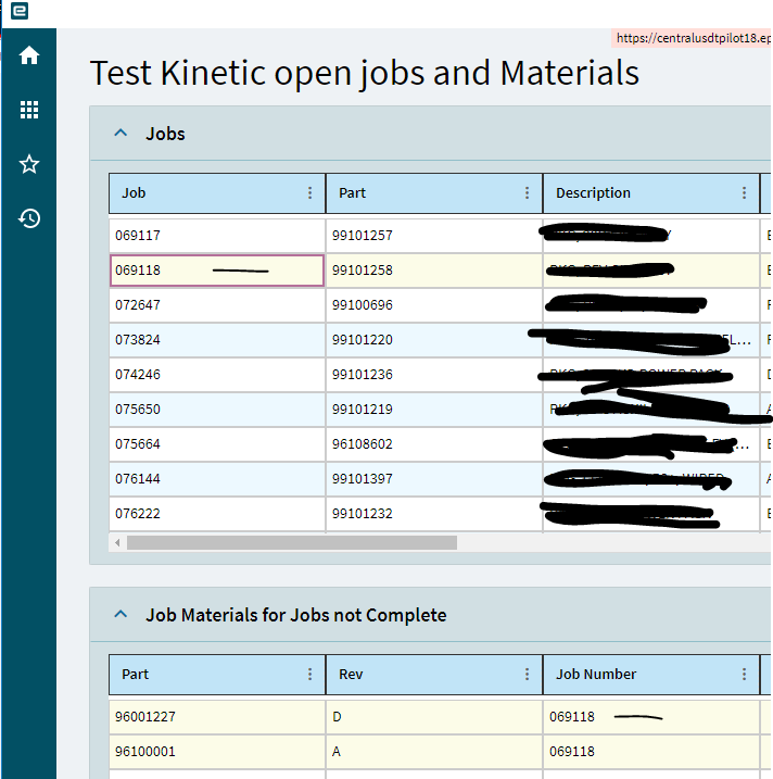

In Classic, the first row has focus ( record selector on row) when first opened (Started brand new dashboard using existing Epicor box stock BAQ’s)
In Kinetic, no such record selector of indication row has focus
until you click on a row other than the first row…
Coming in 2021.2 :slight_smile:
