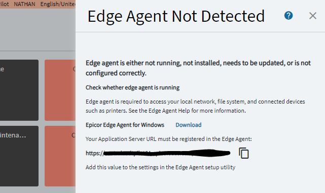

Make sure you have updated your edge agent, and that it is configured for your instance.
I just installed it today for the first time. I copied that link the warning includes and pasted that into the fist URL option when setting up the edge agent. It seems to be running fine. I don’t see any major warnings when I look at the Edge Agent Diagnostics.
I believe for 2023.2.9 you should have something like 4.2.400.x.
Likely you installed the wrong version of the edge agent.
How did you get to the version you installed?
I clicked the link in the pop out panel and it downloaded a file.

Open “C:\Program Files\Epicor\EdgeAgent\edgeapp\appsettings.json”.
Look inside at the ClientExecutables.
Is that pointing to the correct client folder for your pilot?
Ohhh! I think I picked my live Epicor application instead of my pilot application when I setup Edge Agent! Doh! I am going back to see if I can fix that now.
