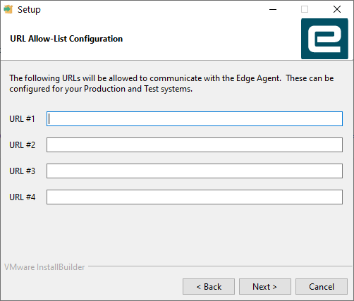

allowedURLn is the APP servers URLs?
yes, the URL in upper right corner of your kinetic app
They correlate to this screen in the installer:

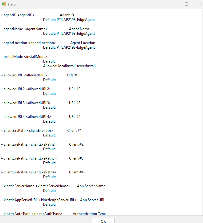

I know this topic is old but I wanted to bring up new issue that I’ve run into. In Kinetic Cloud when doing certain actions in the new kinetic interface, such as adjusting inventory counts, screens like that only exist in the classic form so in these situations the edge agent is used as a bridge between the new forms and the old classic forms. And this new usage of the edge agent requires more options, but they haven’t been built into the exe yet. The missing options are for specifying the kinetic.exe paths that correspond to each url. So every allowedURL parameter requires a corresponding client parameter, but I can’t find that parameter unless it’s unlisted in the --help section of the edge agent exe. Ideally the options I would use would be like this:
--mode "unattended"
--unattendedmodeui "none"
--installMode "localInstall"
--allowedURL "https://centralusdtpilot05.epicorsaas.com/SaaSxxxPilot"
--allowedURL2 "https://centralusdtapp05.epicorsaas.com/SaaSxxx"
--client "C:\Epicor\ERPDT\xxxxx-PILOT\Client\Kinetic.exe"
--client2 "C:\Epicor\ERPDT\xxxxx-LIVE\Client\Kinetic.exe"
Just wondering if anyone has had any more luck with this? The params --client and --client2 are not valid to the installer, but maybe others exist that I don’t know about to fill this need?
Hi Dan,
Running the program with --help shows that --clientExePath is the switch you want.
