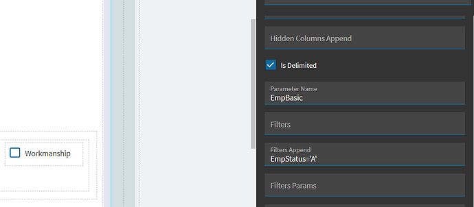

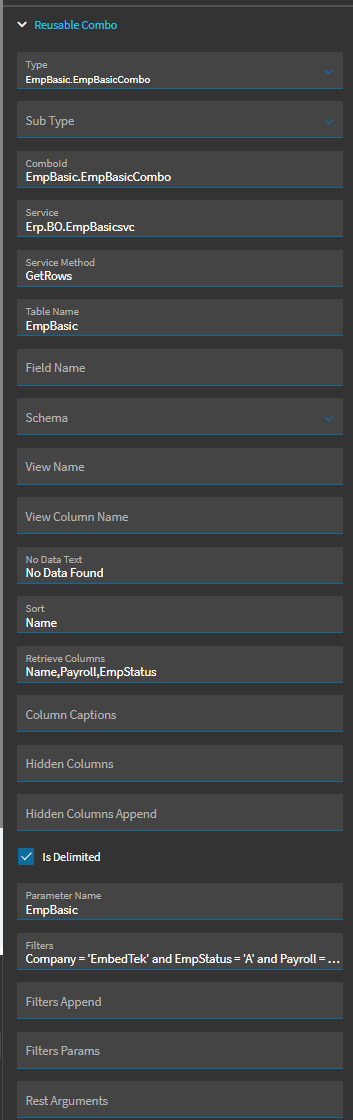

Trying to add a filter Payroll = true and EmpStatus = ‘A’

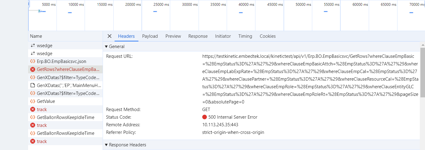

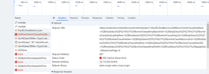

Nothing seems to work and am getting the following error.
Ice.Common.EpicorServerException: Invalid column name 'Payroll'.
 ---> System.Data.SqlClient.SqlException (0x80131904): Invalid column name 'Payroll'.
Go look at @hmwillett control compendium post. You should be able to get to it through her tag. She has very good examples of the syntax for using the reusable combo.
Yes.

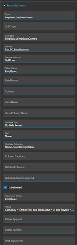

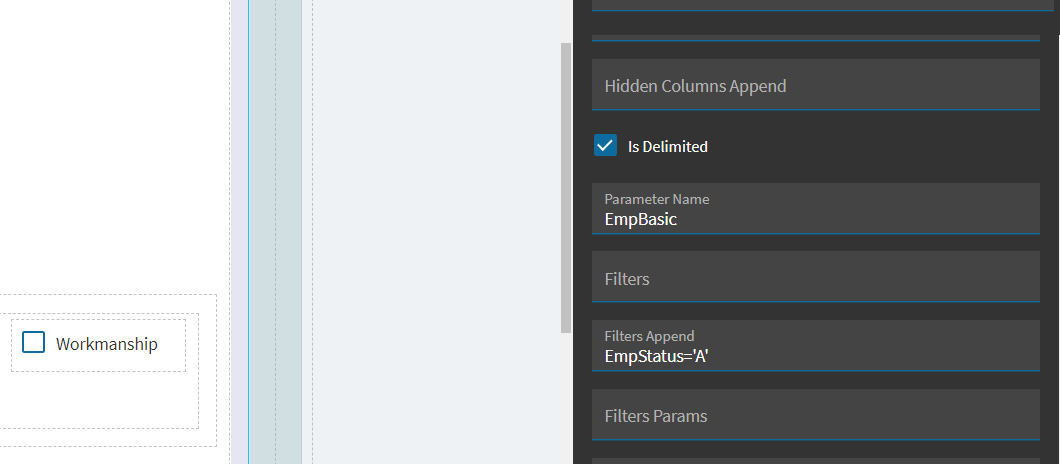

We are trying Fig L from the control compendium post. Getting the error posted above.
Put it in Filters Append.
Like this?
Same error.
Filter does work with Company. Just not the other fields.

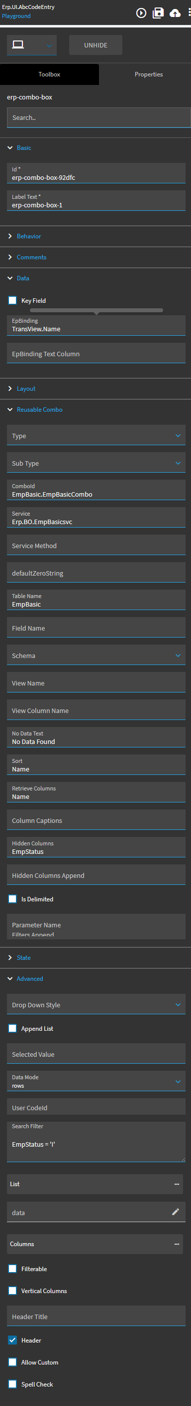

turn monitor
That’s better!
That worked. Thanks a bunch! Looks like the issue Ken and I were having is that we were defining “GetRows” in the Service Method field and leaving Data Mode set to blank. :dizzy_face:

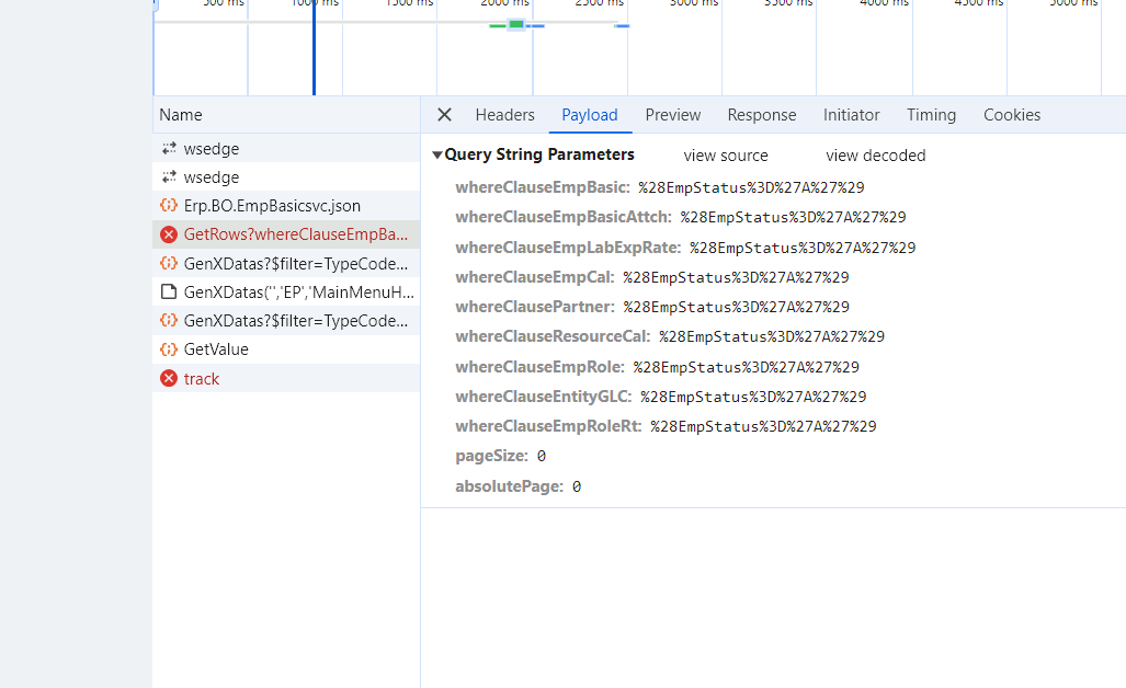

Eh, I think the bigger issue is it’s not letting us define the filter to a specific whereClause. It was doing the EmpStatus filter on all of the returned tables from GetRows, but EmpStatus didn’t exist in the others.
It’s a lot of trial and error.

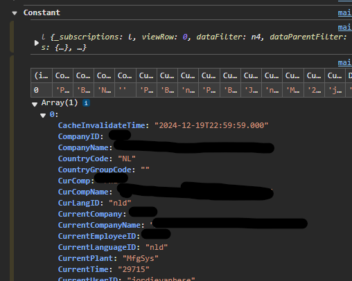

I tried to create a combo box for warehouses where hidden column Plant = ?{Constant.CurrentPlant}. Unfortunately the ?{…} is always interpretated like a string, not like a reference to the existing parameter. Tried with single brackets, % and double, but probably doing something wrong.
'?{Constant.CurrentPlant}'
(Assuming Constant.CurrentPlant is valid)
Jeps it is.

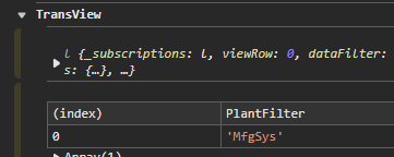

I also tried to use a value that i manually stored in TransView.PlantFilter, but that didnt work either.
Got it :slight_smile:
