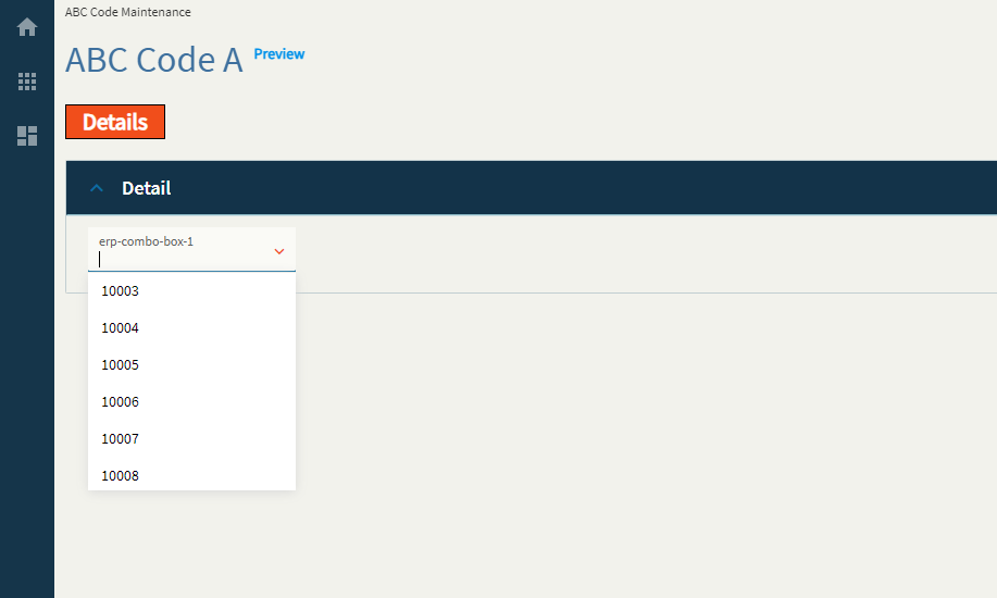

@hmwillett created a thread showing how to use many of the Kinetic components, including a combo. You can find it here.
Very Nice… Thanks for that. Is hooking the result to a TextBox very different ? Am placing a Textbox on a form to be populated with the result of a BAQ. The data doesn’t appear though. Tried placing it in a Panel Card tied to a custom view bound to the BAQ. Imagine I have to fire the GET event of the custom view. Still fumbling about, but things are coming into focus… Have good day :wink:
Hannah is doing these alphabetically, but I image that the binding is similar to the Numeric control where the EpiBinding is set to the View.Column.
