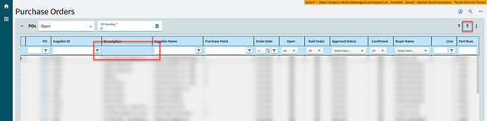

Hi Guys,
When using the filter tabs, how can I use a field as a search function? Under description, it’s greyed out.

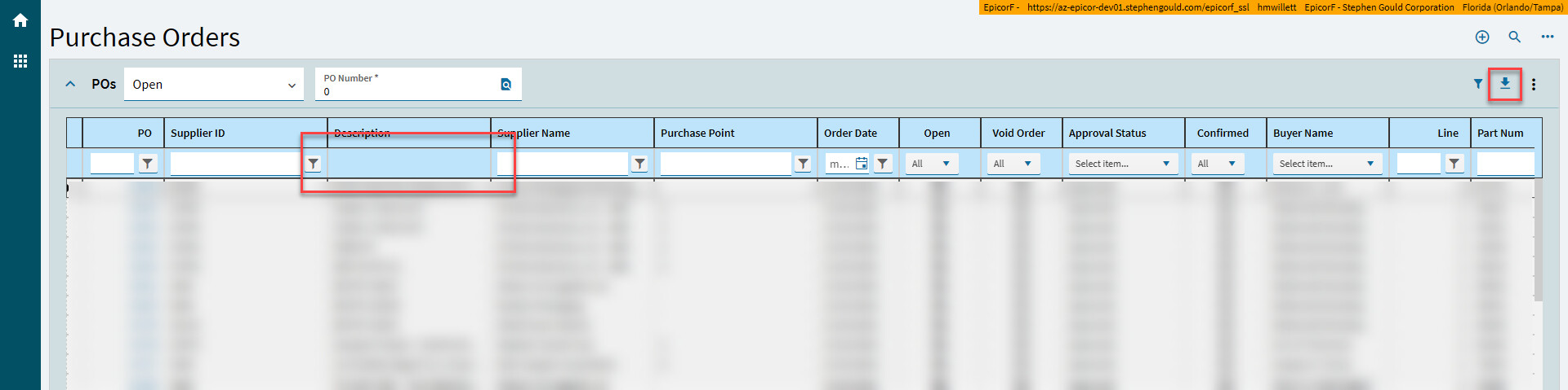

Hi Guys,

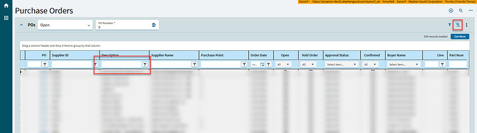

Depending on your version, some of the filter fields wouldn’t open until you downloaded all of the data.
This has been an issue for a while: Kinetic Main Grid for UD table no longer allowing sort/filter on columns - Kinetic ERP - Epicor User Help Forum

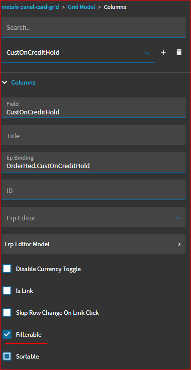

Is this in application studio?
The checkbox referenced is in App Studio but be warned–while that will show the filter box, it throws a server error if you try and use it. More info in that link I posted.
