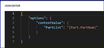

In that widget is a parameter for “Value In” (JSON). You’ll have to look at what values/parameters you need to pass in to your report form, and put those in your JSON. That is what sends the values…
Here’s an unrelated example:
This user was sending the value of Part.PartNum to the next form AS “PartList”.
Then on the receiving side, your report form, you’ll need an event (after Form_onLoad, or after Initialize, or something similar) to perform row updates and plug in the values being received to the appropriate columns.
So, you may have a row update that sets YourView.PartNum to the expression of:
"%session.context.initialValueIn.contextValue.PartList%"
Again, “PartList” was the name of the value being passed.

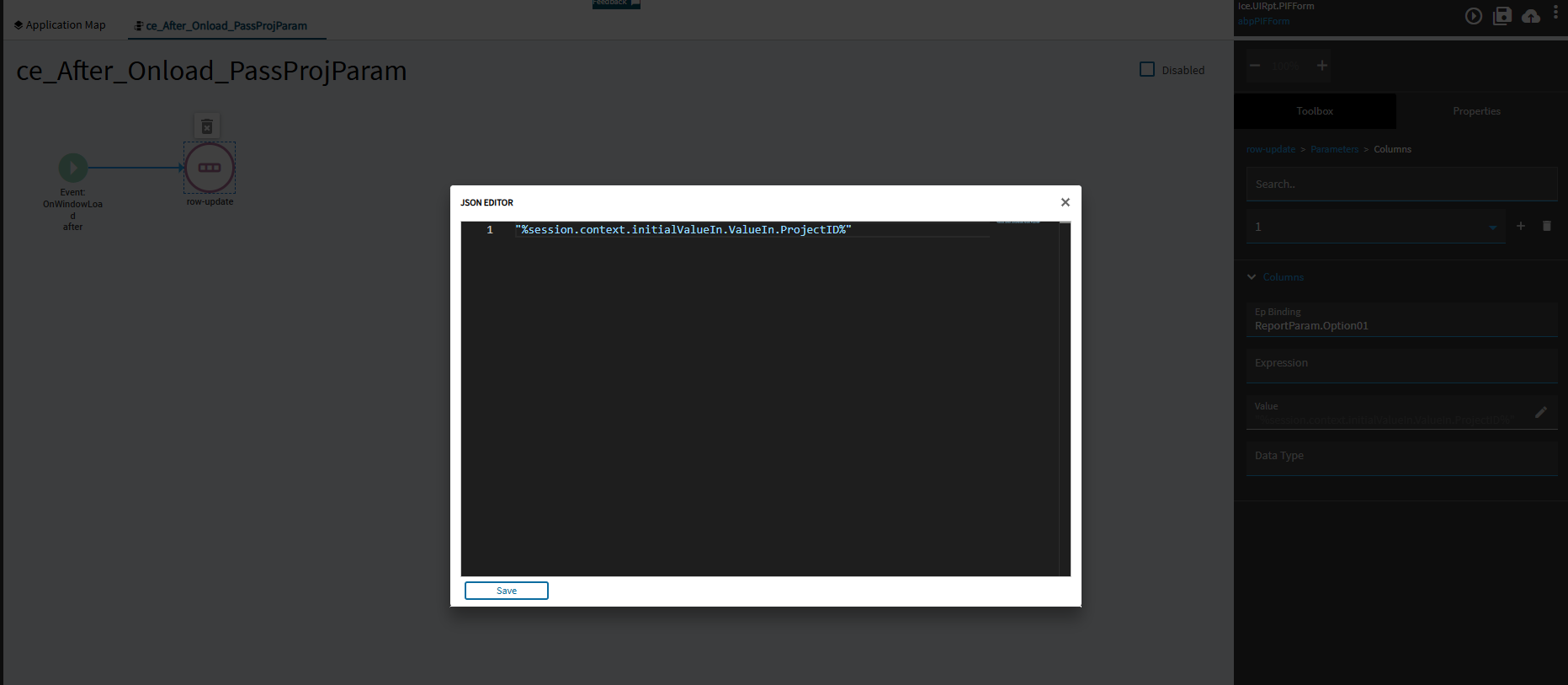

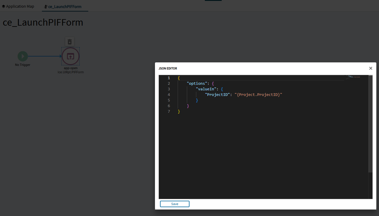

Hi Team. I’m struggling with getting either the correct event or the correct syntax. I am calling a BAQ Report from Project Entry. I want to pass Project.ProjectID from ProjectEntry to a BAQ Report called PIFForm.
I can launch the form, but I cannot get the ProjectID to load into the ReportParam.Option01.

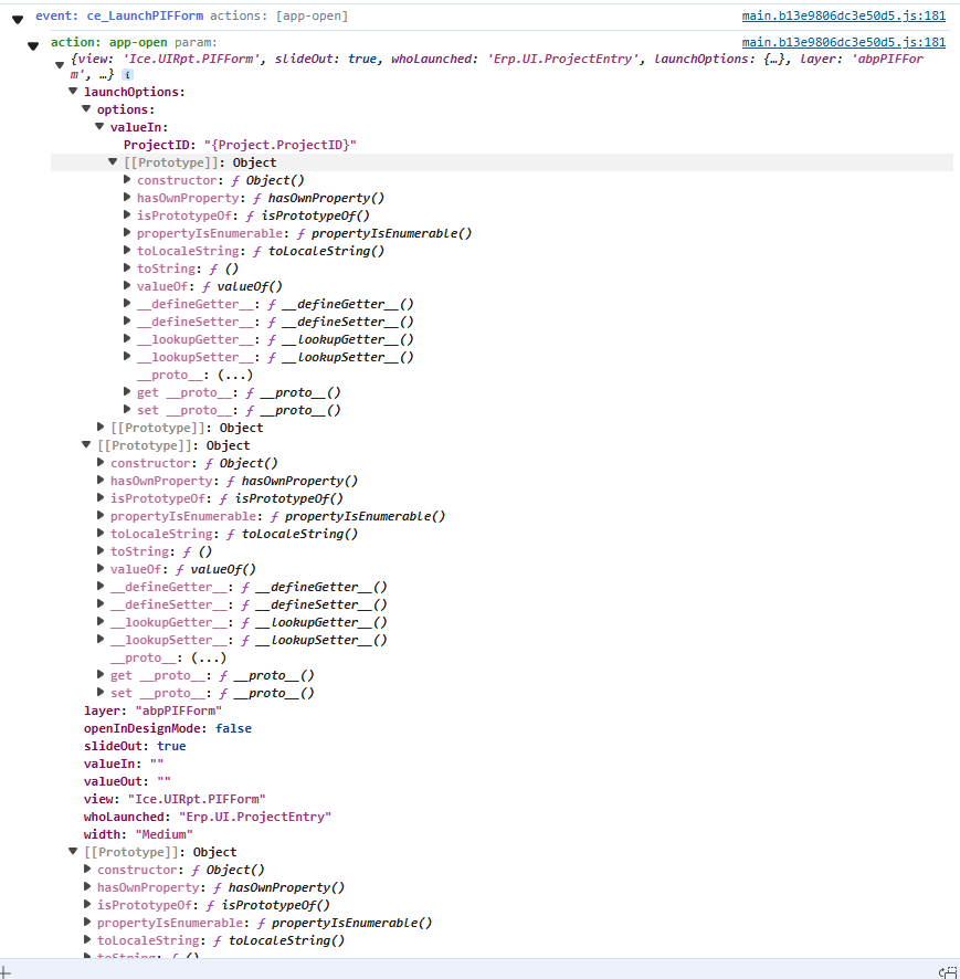

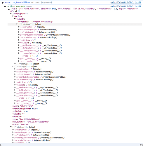

It seems fairly easy (but after hour 3, I’m hitting a wall). I’m new to epDebug–so if it’s giving me a clue, I don’t see it.
In the trace, I can see the launch options (it looks correct to me) and on the receiving side I do not see an error (I’m unsure where to delineate the receiving side in the trace from the calling side).

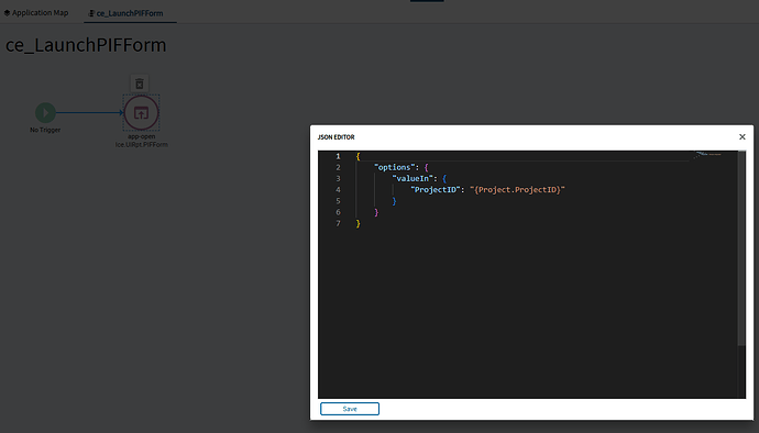

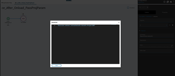

Any help is appreciated. I’ve included the launch param, receive param and the trace.
I don’t think you want the “ProjectID” reference here.
Just try: "%session.context.initialValueIn.ValueIn%"
Thank you, David!!
That helped. I at least got Object Object to show up. I’ve changed the calling ValueIn to use KeyFields.ProjectID and that has resolved the Object Object.
I really appreciate your input!! Have a great evening.
