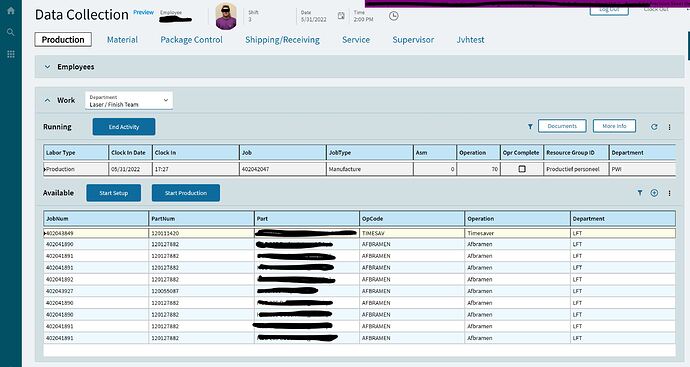

For example; I had a dashboard with all available work (operations) in a grid. I could select a record click on a button Start Setup and the next form opens and the required textboxes, combo boxes etc. are already entered.

I have created a layer in Erp.UI.Mes and it’s calling Erp.UI.StartSetupActivityEntry using an open-app tile (sliding form). I tried to use callContextBpmData, but this value is already lost in the next form.

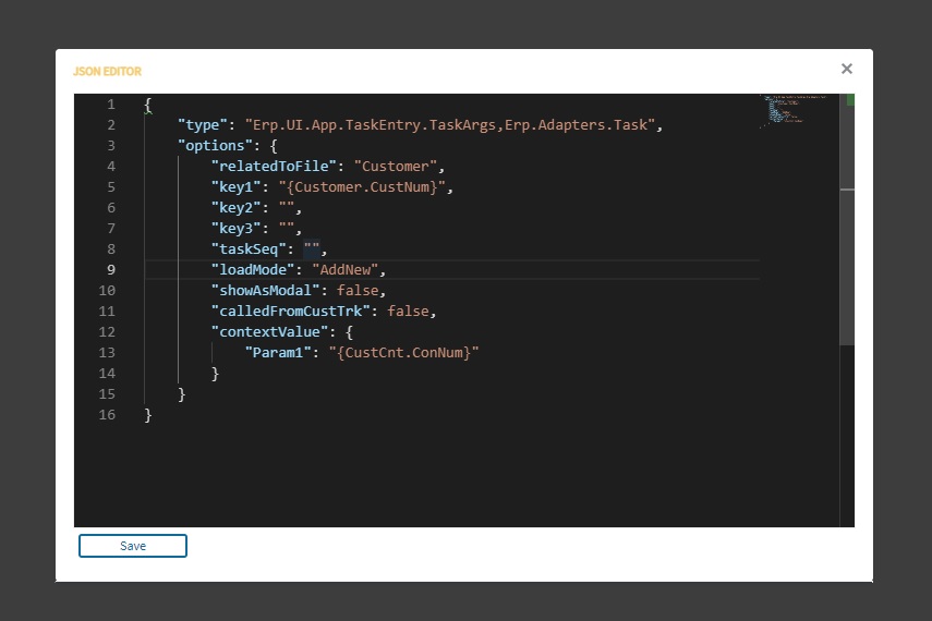

Here are the Launch Options. contextValue is going to be your extra fields you’re sending over.

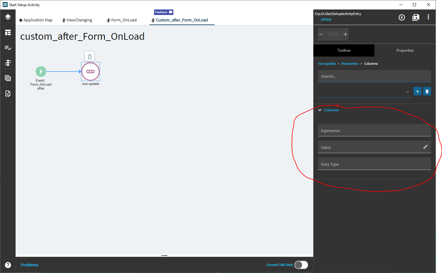

On the receiving form, you need to add an event (I used After Form_OnLoad, but find what works for you) to set the fields into a view of your choice. I typically use TransView because it’s already there and you can add fields to it on the fly. In the event, use a row-update widget and set the value to that disgusting string.
That looks exactly like what I need to finish my plan. I tried it before with the ContextValue, but I didn’t know how to set those parameters like you did. Thank you very much!
I do however have an issue with application studio missing de epBinding field. The problem occurs in the full-client and in the web-client. Most of the time the field is hidden. Any idea what triggers this field to appear?
It shouldn’t need a trigger; it should always be there.
If you can replicate it, submit a ticket to support.
In the meantime, try clearing your cache in the client and the browser and see if that helps.
If I add a textbox somewhere and bind it to an epBinding and throw it away it is triggered and the field can be used :stuck_out_tongue:

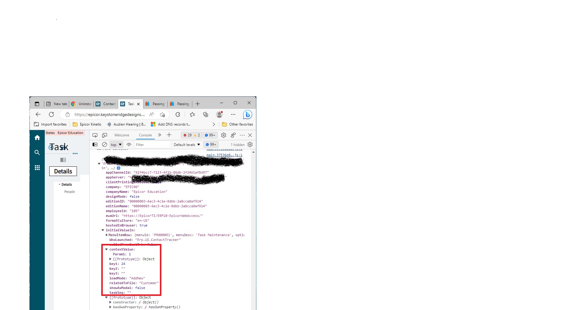

After your form launches, press F12 to open Dev Tools, then press CTRL+ALT+8 to enable debugging.
In the console, type epDebug.context and hit enter.
Do you see your values?
How To: Debugging Kinetic (Browser) - Experts’ Corner - Epicor User Help Forum (epiusers.help)

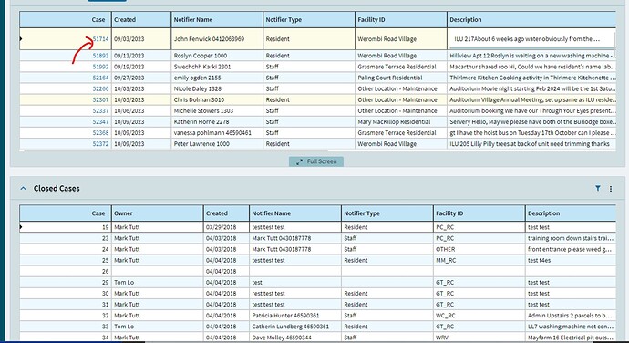

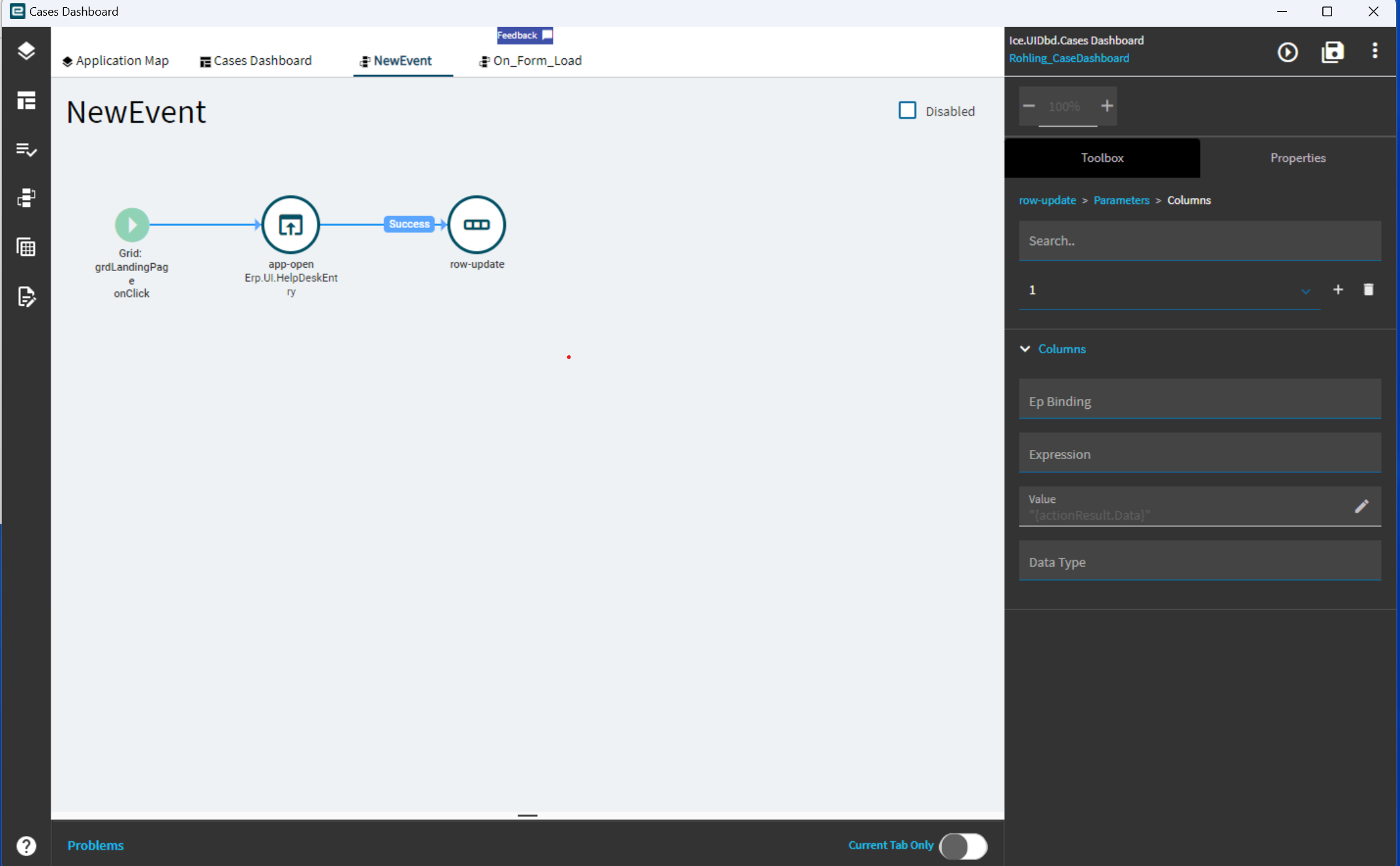

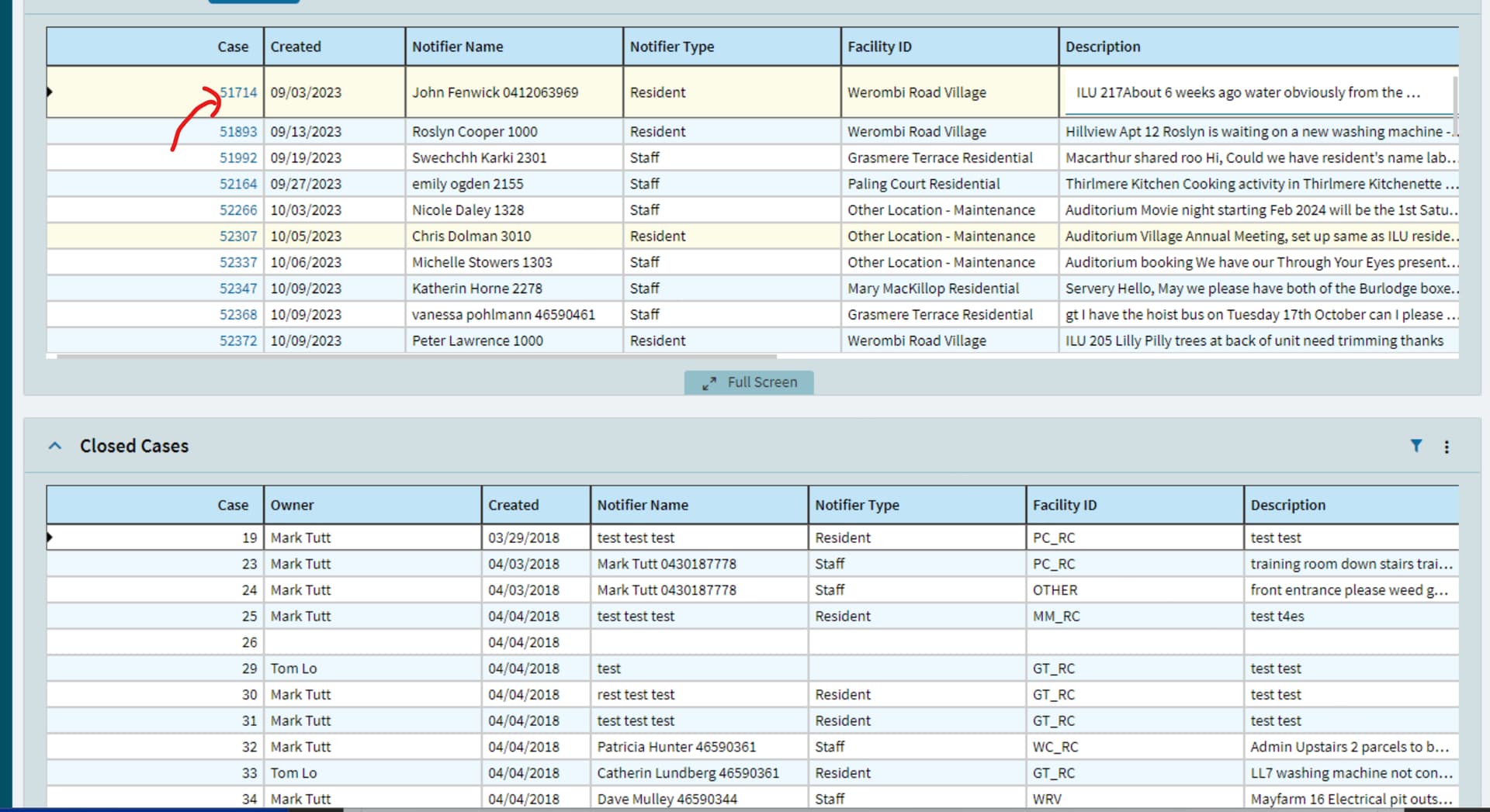

In the above dashboard, I want to click on a case, no and the case entry screen is required with the clicked case no. If you please explain the steps it will be highly appreciated. Thanks
